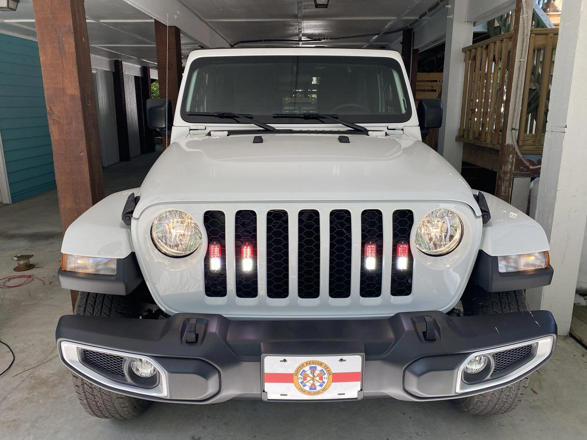

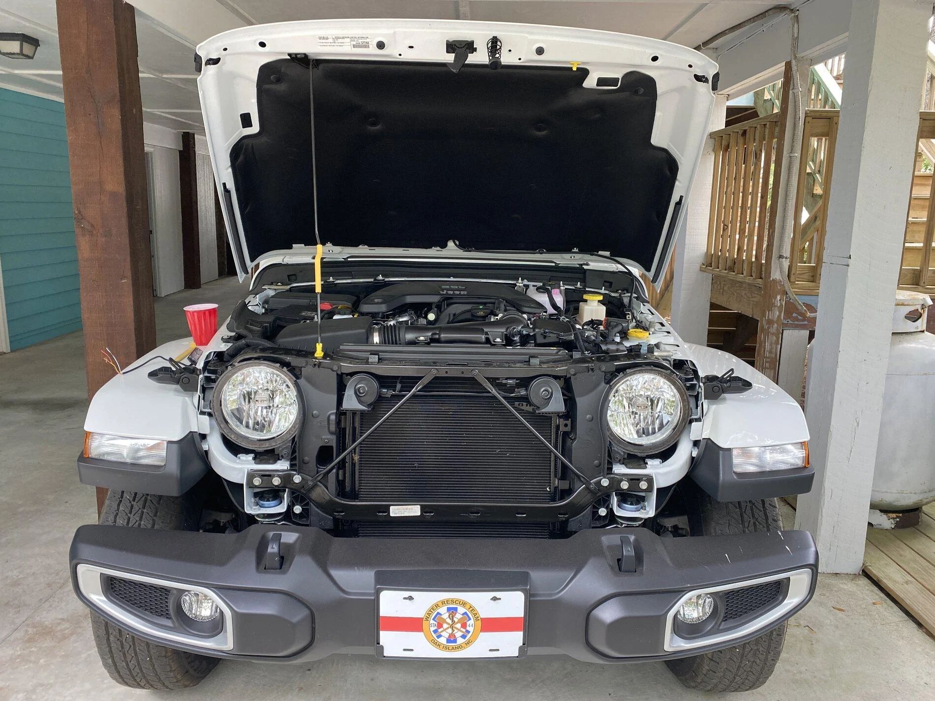

Finished mine up today. I didn't want too much so I went with 4 flush mount LED's in the grill. I pulled the grill off and wired it up on a table. Lesson learned from a prior install - I hooked it up to a 24v leaf blower battery to test the wiring BEFORE i got it all mounted up...
The siren was a little tougher. I removed the plastic air dam and mounted it to the metal cross brace behind the bumper. I put the air dam back because it actually protects the speaker pretty well. Ran the wires through the firewall into the driver's foot well and to the amplifier under the rear seat.
AUX switches made it a lot easier.
