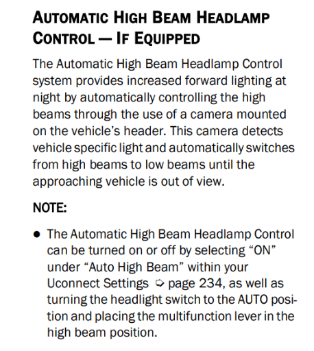

Does auto highbeam just set low beam automatically when approaching headlights are detected, or does it also reset to high beam after the approaching vehicle has passed?
180
29,422
34,997
You start out in high beam to enable the function.
When it detects approaching vehicle, it changes to low beam, then back up to high after it's passed.
