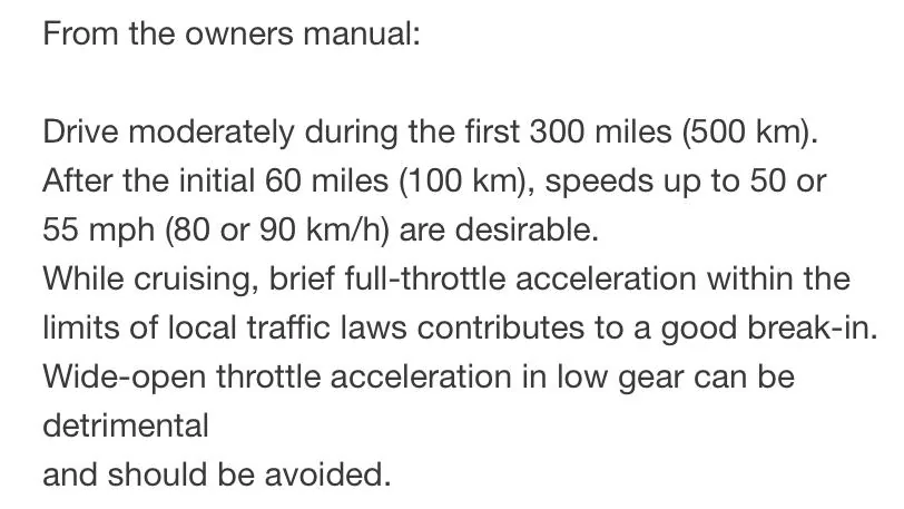

I hear a lot of different opinions on this, after 60 miles the factory recommends brief wide open throttle.
How come I hear people saying to stay under 4,000 rpms? When you put the hammer down for two or three seconds at a cruise you’re going over 4K rpms when the tranny down shifts, but this is what the factory recommends. Just wondering the reasoning why people are saying no going over 4K rpms?
I did 80 miles of back roads under 4K rpms, now I’m doing 50-60 mph plus brief wide open throttle at cruise and reving into the 5k range. Not sure how it would be possible to do wide open under 4K unless you have a manual

IMHO your best bet is to follow the instructions in the manual. Modern engines don't require the prolonged and/or complex break-in procedures that used to be required.
