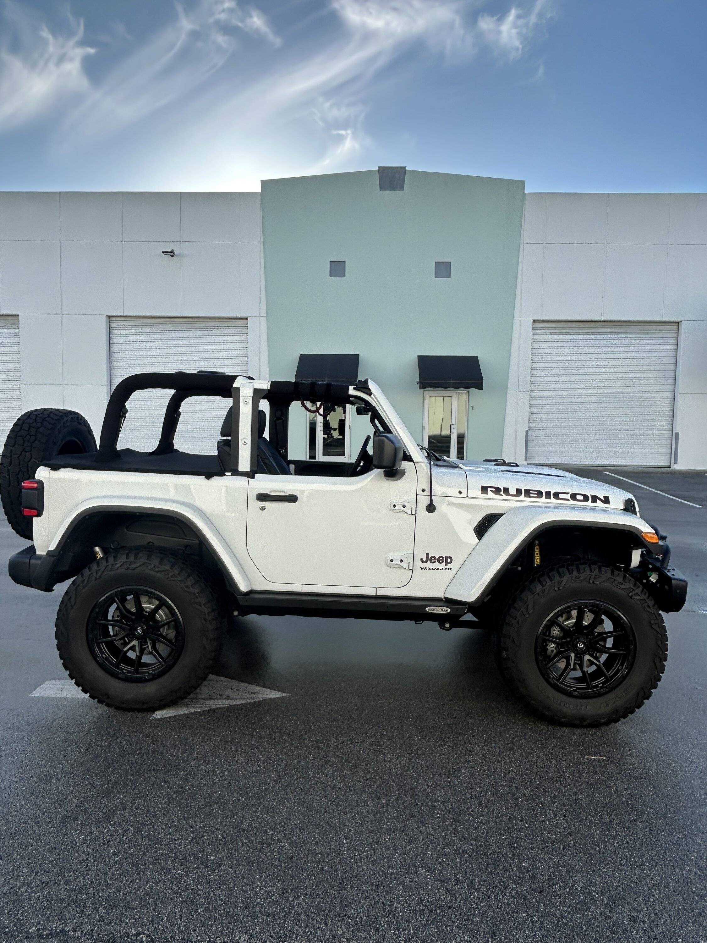

Pictured JEEPZILLA:
Jeepzilla is a 2018 JL Rubicon heavily loaded with options and had a 4.10 gear from the factory.
Have done this several times so I considered the only 4 places in the US I would allow to do this build.
I chose Rubitrux in North Carlolina. They had a customer that had bought two JL's one black and one white and he put the white on their lot on consignment.
And then the fun begins. AMW 4x4 has a 6.4 semi kit that puts out 505 at the rear tires. and comes with a 3/36 warranty???>
Rubitrux did the install and the nice thing is everything works exactly like the 392 4 door Jeep is building on the assembly line these days.
Wait no I lied, it's not the same. The 2018 has the real 4:1 Rubicon transfer case, the 392 Production has the grocery getter mommy 4x4 transfer case which is not nearly as string as a real Rubicon transfer case.
Jeepzilla has a 2.5 inch AEV lift, Fuel Wheels and Mickey Thompson Baja Boss A/T's 37x12.5x20, 3.5 inch exhaust to the tail pipe, Teraflex Falcon steering stabilizer, PSC steering assist, not sure who's trackbar. and every day I learn something net.
Jeepzilla has stock Dana 44's with the original 4.10s and the 8 speed tranny which makes it a blast to drive.
Jeep cost was low 40's, 35k for the conversion with a 3k discount .
When it first arrived in FL the check engine light came on and it seemed according to my old reader to be o2 sensor issue. I called Rubitrux and they called AMW and then AMW called me and asked me what the deal was. I explained and the guy asked if I was pretty handy, I said yes but I just bought this and it has warranty etc and he said two choices, you act as my eyes and hands and I will do the rest. I thought how cool I am talking to one of the engineers that designs these monsters this is going to be very cool.
He Fedex'd me some basic equipment and he asked me to plug it in and then asked me to loosen the ox sensors one by one and we were going to test each one.
We got half way through the second one and I said this is fun but my hands are getting tore up trying to reach between metal parts that are inches apart and each turn of the wrench is not even a half.
He said Mr. Schuble it has been a please but we have reached a point where I feel your experience with amw 4x4 is going to end up with a bad review from you and I am sorry I know you are a busy guy and we want your experience to be a pleasant one. Have a great day and you will hear from us.
Next day I get a call for address verification, I a very close and wanted to make sure you were home. Guy pulls up, it was a Sunday, and he asks for the keys to Jeepzilla and told me to go back to watching football.
Door bell rings again and guy said all done here is my card, my dot numbers, my cell, my ins, as you can see your Jeep is getting a VIP ride as there are no other vehicles on the trailer. In the event you have a tracker I go this route and I stop to see a friend because it's illegal for me to drive straight though. I can assure you that your vehicle is safe and in good hands and if you have any questions, comments, concerns you got my number.
And off he goes.
two days later I get a call that the Jeep is loading and expect it back in your garage tomorrow night.
Next day same truck and trailer arrive and there is Jeepzilla. Truck driver pulled her in the driveway and asked me to sign that I was in receipt of the vehicle. I said thank you and tried ti hand his $100 and he refused it and said very nice of you but not allowed to accept that and after all brand new conversion should not have a check engine light come on after less than a week.
He said in addition I was told to give you this, he handed me a t-shirt and a box. I opened the box to find the following the attached. He said they told him to tell me that box is s important as a single set of keys to your jeep that can never be replaced so dont lose it.
Rubitrux does excellent work and are one of 3 in the US I would allow to do a conversion.
The other two are AMW themselves, and Dakota Customs. There is one in Arizona I won't mention because I have had no dealings with them.
Funny thing is 3/36 on this and when I am done they said they would recommend the 426 package so I would remain under warranty.
