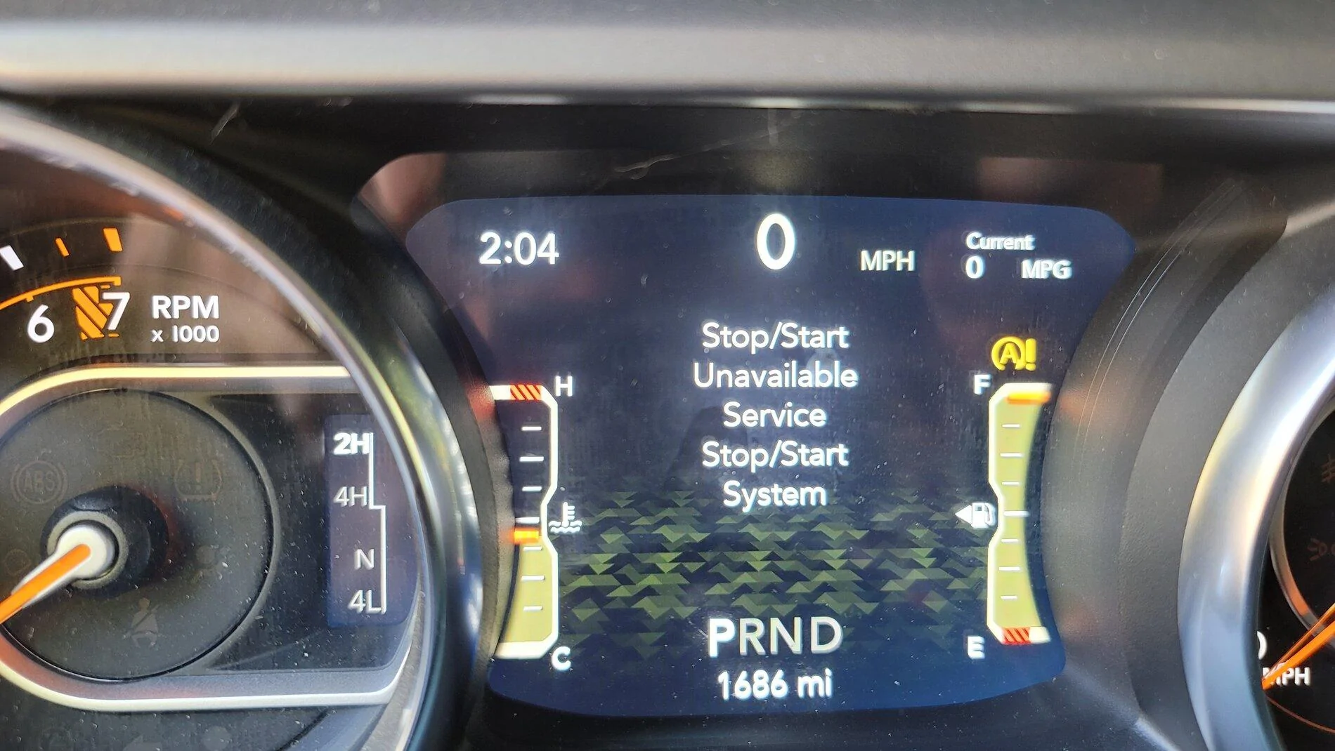

Just disable it if you don't like
it ! No Tazer no cost .
Jeep Gladiator Enough about the ESS ! ( Auto Start Stop) 20210902_132850
Jeep Gladiator Enough about the ESS ! ( Auto Start Stop) 20210902_132913
Jeep Gladiator Enough about the ESS ! ( Auto Start Stop) 20210902_133527
On my test drive (which they
required I do alone. Yeah )
I felt a vibration/ shudder leaving a stoplight and thought, what the hell is that?
ESS . Knew right then I didn't like ESS .
So like most new JT owners I

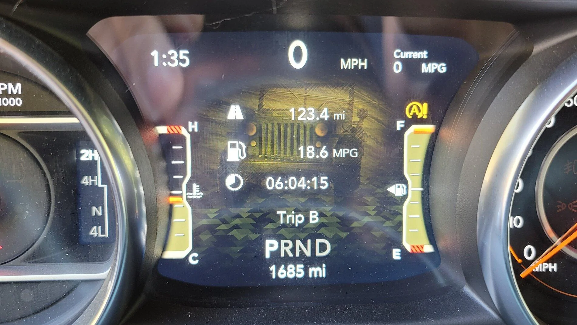

looked on the forums and saw lots of posts about it . One of them said just unplug the hood plunger, problem solved! Yes there will be an icon on the display( A! ) but so what?
In fact I think the alert bugged
the OP so much he couldn't take it . Just like the "man bun"
thing it doesn't bother me at all.
There will also be a message in the menu but so what ? I just scroll right by it .

Like so many other things after awhile I don't even notice the alert . If the alert bothers you more than the ESS that's up to the you .

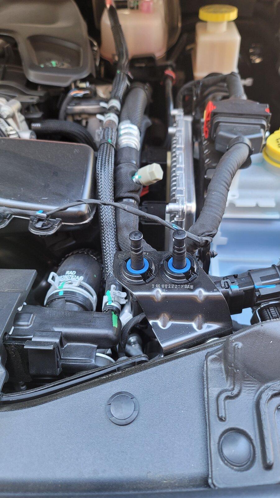

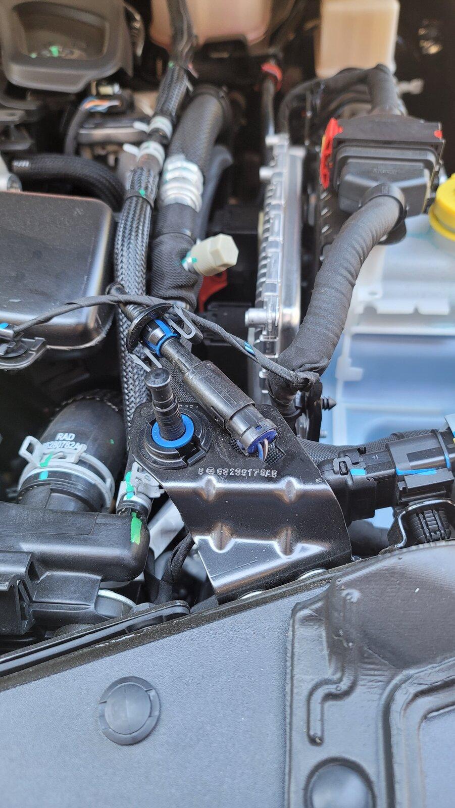

I just popped the plunger out
(two tabs ) rather than unplug it so no dangling wires and keeps the plug clean .

For some reason there are two plungers . One will warn you the hood is not latched the other disables the
ESS and as far as I can tell that's all . I suppose you could add a switch to enable/ disable from the inside.

So if you have to scroll through a warning on the dash, why not just push the ESS Off button instead? Then you don't get the warning, no A!-alert, and the ESS is off.

The menu warning is only one of the pages . If you left it on any page such as speedometer that's what you'll see the next time you start your truck. You only see the warning if you actively scroll to another page .
Jeez !
I'd have to double check but what it is is the messages page where it always says " no messages ". You have to scroll by it to get where you want anyway .
