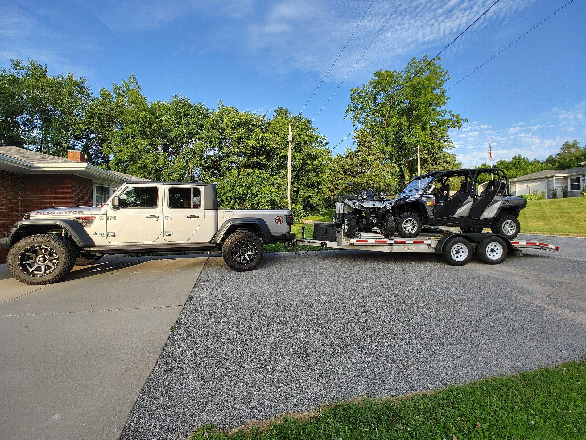

I tow these plus one more SxS, and my Mustang and Corvair, no issues

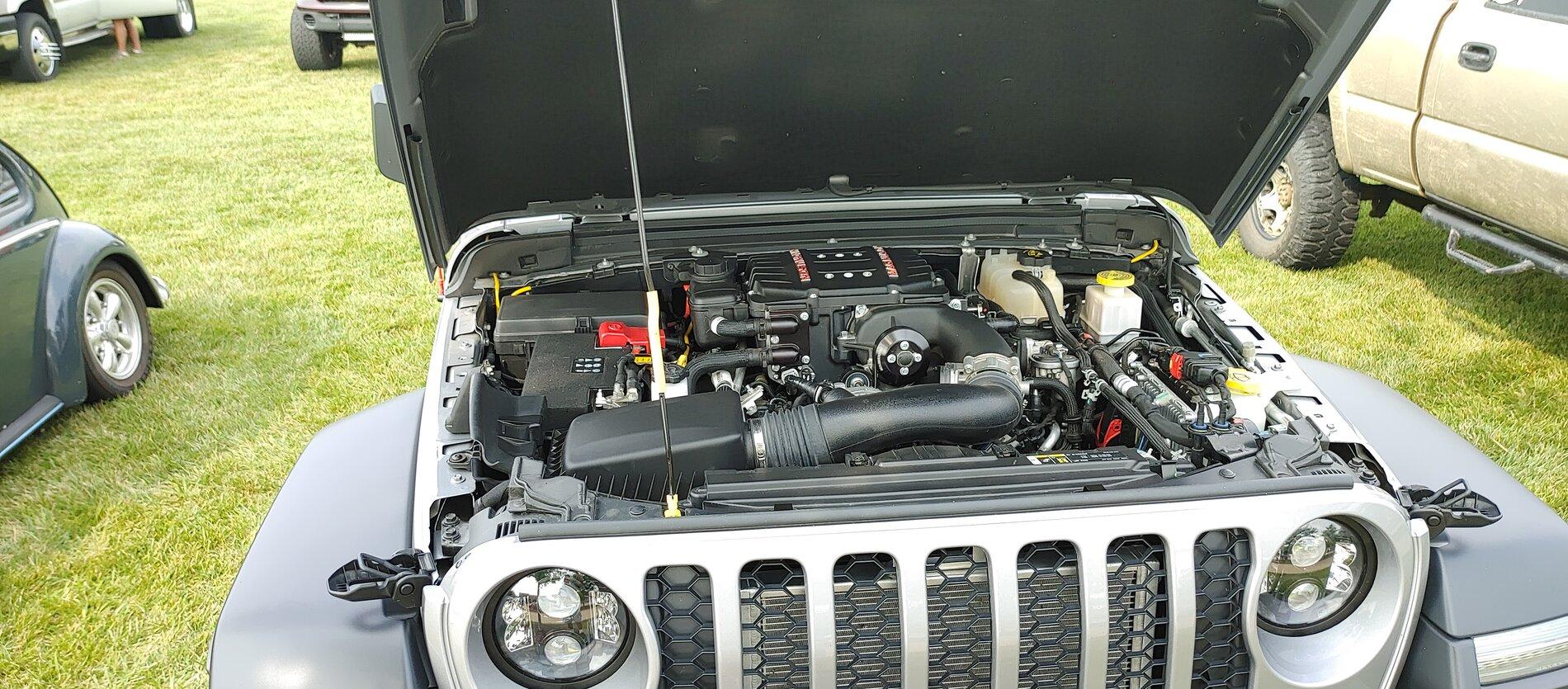

I can’t describe in word just how insanely fun this truck is now to drive, after a couple tune adjustments and soon to be a suspension overhaul this Jeep has now become my favourite one to drive I have owned.
Its too bad none of the supercharger kits actually come with a tune that works.
A month or so ago I posted a thread to this forum asking to hear from anyone who had a truly "bolt-on" experience.
I didn't get a single reply.
I'm not new to all this. I've had a VW and a Subaru STi with custom tunes. Its just that in this case, I just want it to work. But have more power.

I have helped upwards of 60 different jeeps with forced induction, from 18-21 production years. Out of all those I have seen at least 15 unique operating systems. Not little stuff either. I have seen alternate fuel enrichment schedules, airflow model differences, and big changes in cam timing and torque models. There does not seem to be a date or naming convention correlation from the files I have. My guess is there are probably many more. I imagine that is the problem with an install and done solution. If you happen to have a new variant, it may not have the right tables in HP or the changes needed are not like the last 16 other variants. My cam timing tables will not work on all the 21s I have tuned so far. Any attempt to change the cam timing, causes idle and ignition instabilities. So either the definitions are off or the differences in the airflow and fueling are significant enough it will require another couple days on the dyno. My goal was bolt and go on my sc purchase, but after putting up with the calibration I that came with it, I threw my hat in the circle.

This is the factory "tunes" that are different. The aftermarket tunes all start, run and idle, and for the most part, they also drive right from the start. What happens is unexpected fuel enrichment, this leads to altered shift points. They also have a throttle model, that is completely different from what an operator inputs to the pedal. If torque and fueling are off the throttle will do off the wall behaviors like osccilate while accelerating, or slowing down, or power surge cruising on the highway. This is what is most typically seen. The aftermarket is treating this like an LSX, or subaru, or audi and just trying to add more fuel where there is more air, the problem is, there is no straight forward table or way to do this. You HAVE to take into account the interactions between the airflow, throttle, and torque models. If you don't, it will remap over the altered one and then proceed to do some weird cht.
