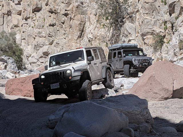

I like to run and lead trail runs over moderate level trails in the Southern California and Baja, Mexico region and I want my Gladiator to handle the same trails that my 2003 TJ Rubicon is built to complete. Since 1999, I have led runs into the Joshua Tree area (via Berdoo Canyon Road and Gold Crown Road) then in 2004, the 1942 Baja Pole Line Road outside of Mexicali, Baja California, then 2006 the "Mission Impossible" outside of Rancho Santa Inez/Catavina, then the Pioneer Trail in 2019. The Pioneer Trail and "Mission Impossible" being the most challenging.

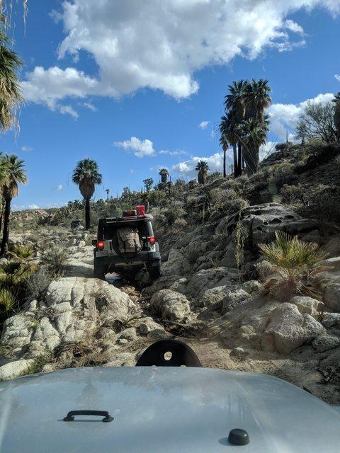

Berdoo Canyon Road got a little dicey due to low clearance and small rocks

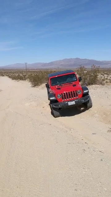

Travel maxed out with the stock shock absorbers

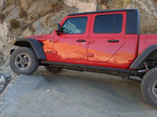

These trails along with lots of quality trails in the Big Bear area along with Truckhaven and Ocotillo Wells made up my mind that a high clearance build was the most practical. I ran Gold Crown Road and Berdoo Canyon Road - both 'EASY' trails that I ordinarily ran in my mid 90's short wheelbase Ford Ranger, and later my 2003 TJ Rubicon without incident. In fact, these trails are simple trails offering scenery and little if any challenge for my well-built TJ. But, with my stock Gladiator my wife was worried about rocks scraping the rockers and doors. I got some usage out of the stock Rubicon skid plates as well. There had to be a better way.

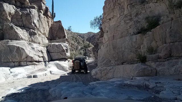

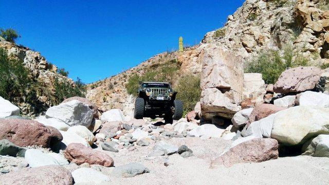

Dropping into "The Swamp" along the "Mission Impossible" trail outside of Catavina, Baja California, Mexico!

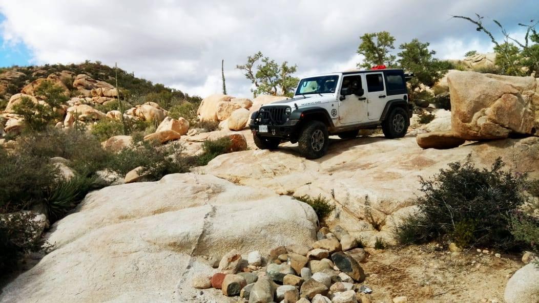

Coming out of "The Swamp" along the "Mission Impossible" trail

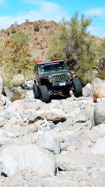

A JK running 38" BFG KO2s at the welder in San Felipe after this happened along the Baja Pole Line Road - February 2019
Matomi Wash, outside of San Felipe, Baja California, Mexico
Pioneer Trail outside of Bahia San Luis Gonzaga, Baja California, Mexico
