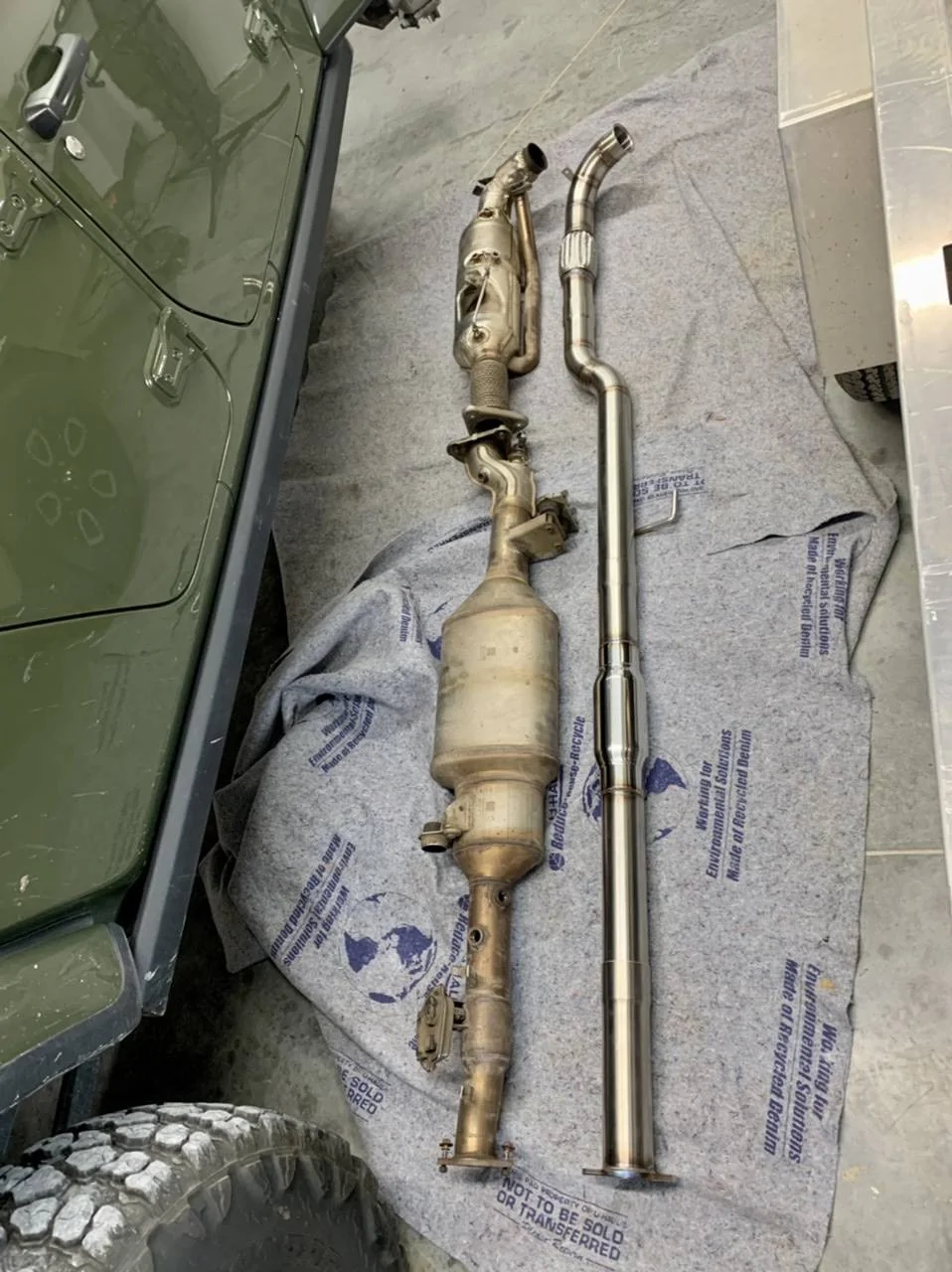

I'll keep it short. It's tuned by EOC on a PCM I had cloned at Jeep. Lost 110-ish lbs. of weight, picked up roughly 80hp/140tq at the wheels. The truck absolutely rips.

Did you leave anything in the exhaust or straight pipe it out the back? As above, I'm also curious about backpressure loss.
I've gotten curious where the choke points are with the ecoD because it seems obvious it has serious breathing restrictions, and exactly how much each area limits the 3.0's potential.
DPF?
Cat/ res/ mufflers?
TB/ intake?
Turbo?

I've only got a few hundred miles on it post tune, so far zero hiccups and smooth as can be despite not opting for any tranny tuning. I haven't had any issues with the OEM shift points etc. and I didn't want to introduce another layer of complexity (not running a tazer or anything either). I'm back to making up excuses to drive it all the time. I never really fell out of love with the truck but the honeymoon has restarted that's for sure : o )
@Pescatoral Pursuit - I'm looking to get it on the dyno in the coming weeks. It's nearly a 2 hour drive so just waiting on another reason to head out that way.

Where did you buy the exhaust?
