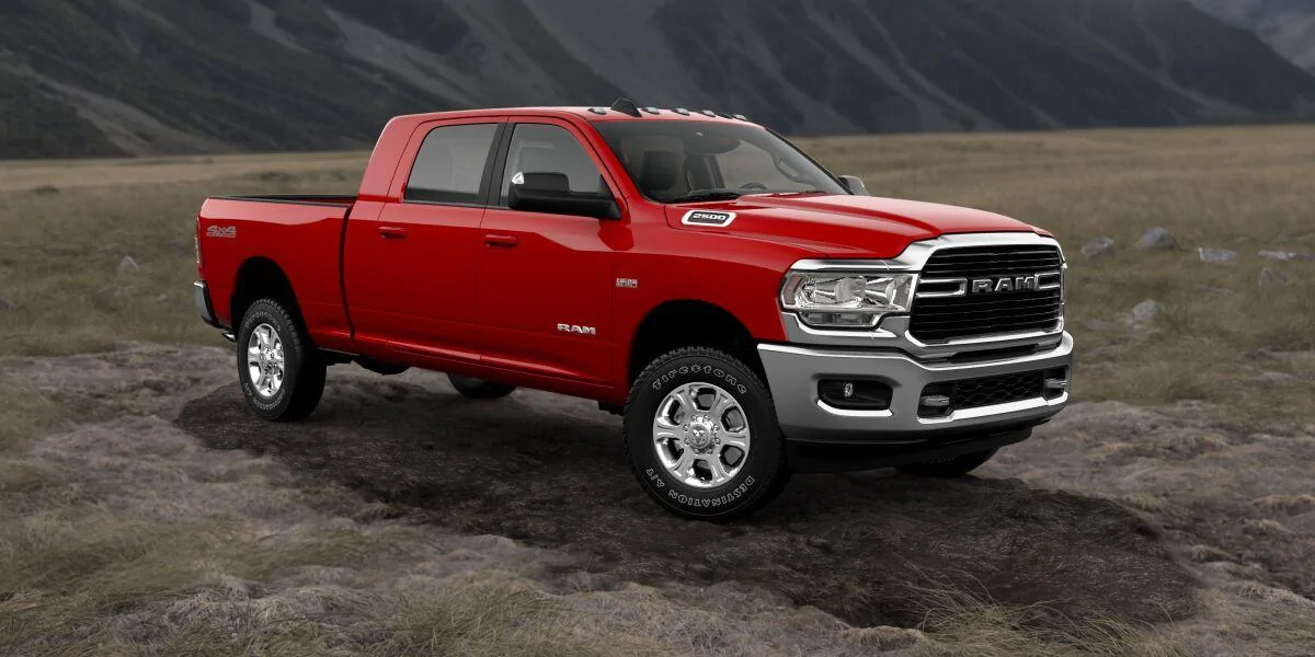

That's great but I need the mirrors to be a tad larger &/or extendable.
ACAD_Cowboy
Francis
May 1, 2019
1,414
1,953
NY
15 jkur
You know, they make that, called a Ram
