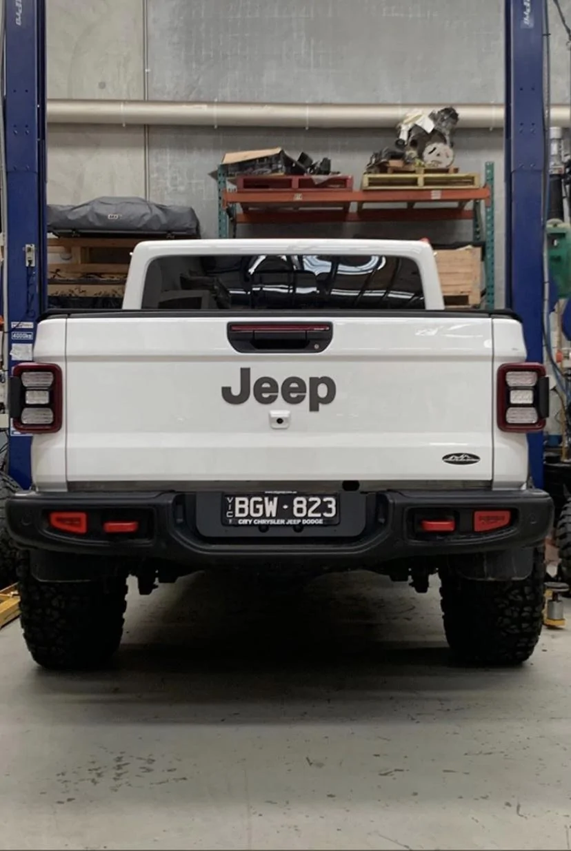

Hey everyone, I’m curious if anyone knows whether a set of export Tailights are plug and play for the North American Gladiators ? I’m talking about the clear tailights that have amber turn signals in them. I would really like to switch them just don’t know if there is more to it then just plugging them in ?

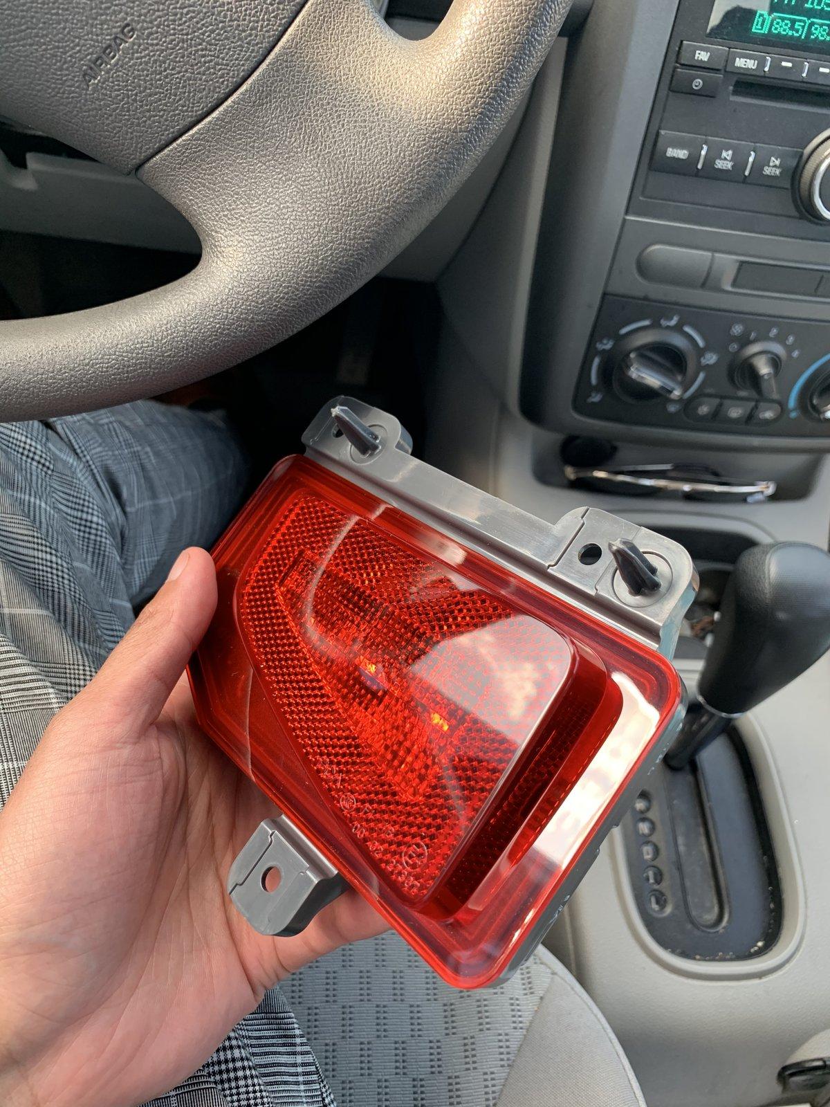

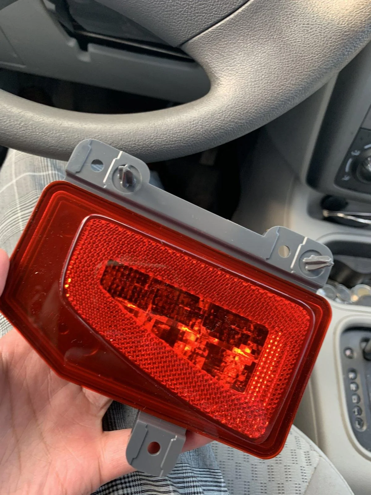

Anybody know ? Mind you I’m about a month away until my Gladiator arrives so I’m just trying to collect parts for it right now. I have already received my rear fog lights for the swap and would like to add the tailights as well if they would work. Any info would be helpful.

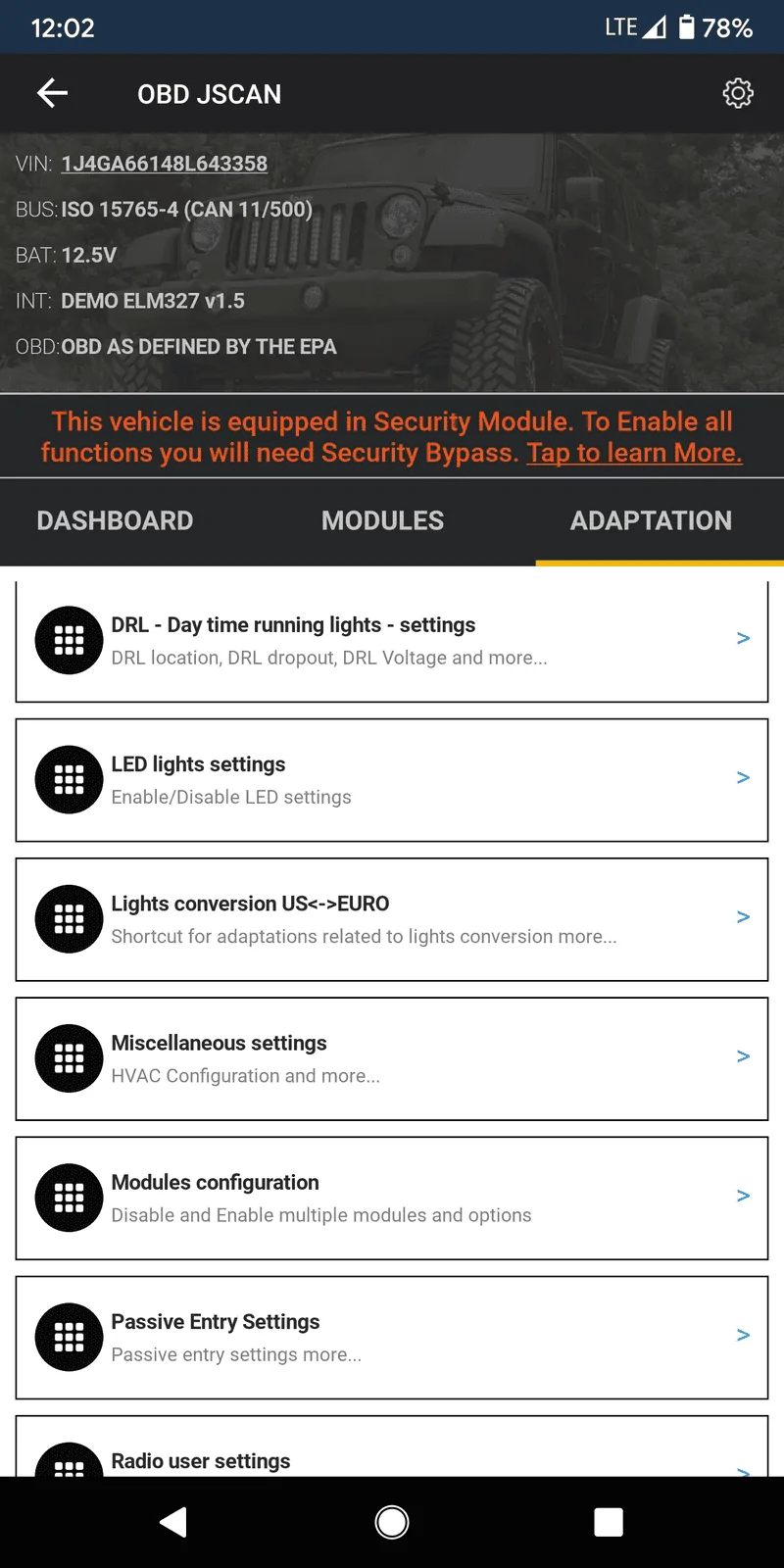

I know they are plug and play but you will need to flash the system with JScan to get it work properly but I think it will work. JScan has a us to euro conversion adaptation.

I bought the export rear fog lights from the dealership I work at. You can order them with the part numbers. Plan to do full export conversion, hood, mirrors, tailights, and rear fog lights

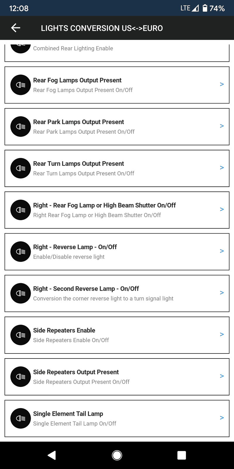

Yep it has a option to enable rear foglights in the us to euro adaptation. Only cost around $90 for everything and it doesn't vin lock so as long as someone pays the $22 fee online you can use the cables on multiple vehicles that the app is compatible with
Jeep Gladiator Export Tail lights on NA Spec Gladiator Screenshot_20200614-120831
There's a screen shot of the option in the adaptation
