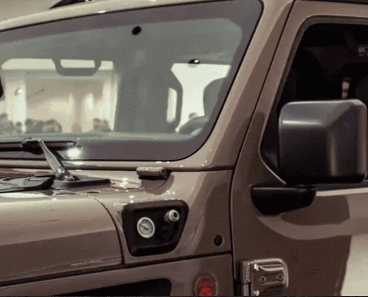

I haven't seen any commercially available, the closest I've seen is from the Jeep Gladiator Wayout concept build.
Jeep Gladiator Fabrication - Air Compressor Coupler - Thinking Outside the Box 1620677803643
More details here https://www.topspeed.com/cars/jeep/2019-jeep-gladiator-wayout-concept-ar185138.html (edited to remove link from banned site)
I'm not sure how big the market would be but it would be interesting if someone put this together with an install kit and color matched cowl. More likely something that you would have to custom fabricate but it would be cool and unique. Good luck!

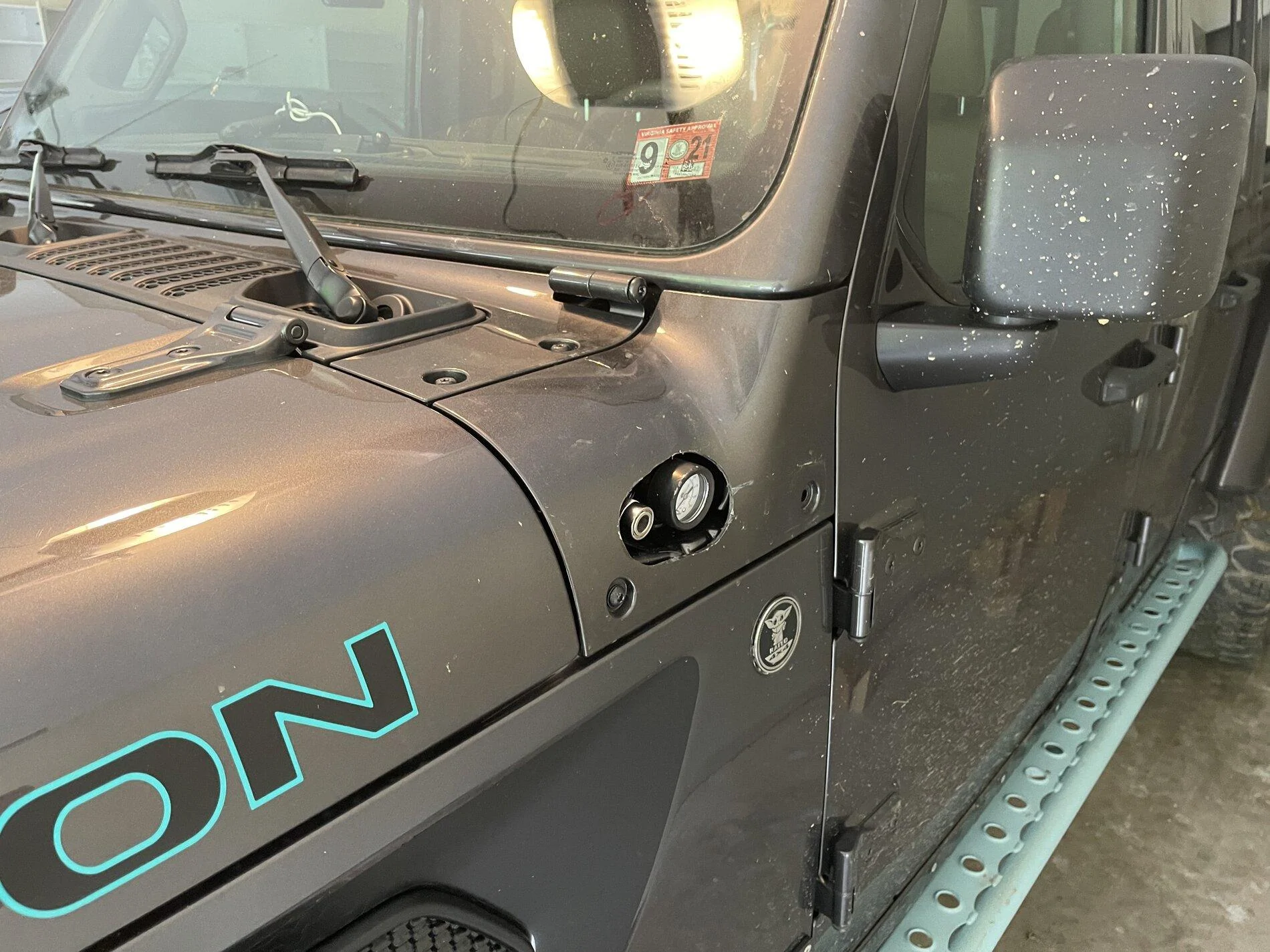

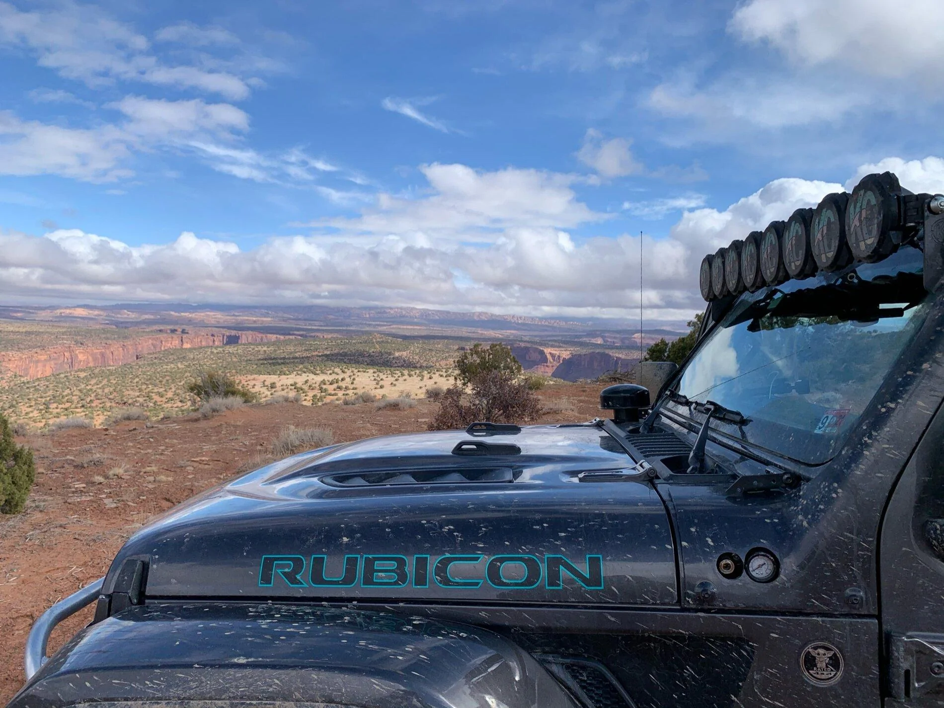

So i just mounted the coupler and the gauge, no electrical outside since that’s just asking for trouble.
This is my version 2:
Jeep Gladiator Fabrication - Air Compressor Coupler - Thinking Outside the Box BFA20601-5453-48B3-B717-1702483CB6C4
Jeep Gladiator Fabrication - Air Compressor Coupler - Thinking Outside the Box 55EE71B5-F7DB-4AB3-996A-B6074F1579DE
Mounted an aluminum hub to the pinch seam, and drilled some holes. the hole drilling required some very careful measurements :)
Working on V3, but it will probably be a month or so before I have a prototype out. Biggest change I’m thinking is just moving the hub mount to the cowl itself instead of the seam, and making the holes prettier.
Covers haven’t really been necessary in my opinion. I live east coast, and have driven it through just about everything. Put some graphite in the quick connect half way through winter, about all the maintenance it requires.
Will share the designs when done.

Great Feedback and pics.
It appears you had to drill holes to both the faceplate and the light mounting bracket; see enlarged pic.
Did you by chance save a pic of the stock faceplate that you had to drill into; that's the part I am looking for, as I do not have a Light Mounting Bracket?
I think also with that concept in mind, you could have done passenger side; did you consider both sides before choosing the driver side? Am assuming, just more feasible, as you are driving?

Without a light mounting kit, I've only seen 2 options so far; pics attached.
4xe Cover
Body shop could cut out the holes where the plug-in goes
Wayout Cover
Another option
