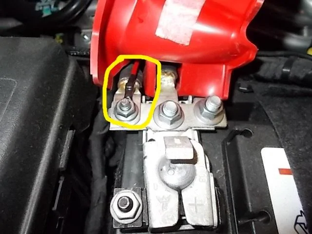

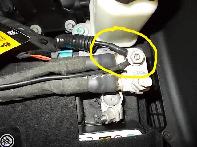

Whenever possible, it is always best to run the power & ground for accessories such as these directly to the battery terminals.
I have both the power, & ground on my RSE Stepsliders connected directly to the battery terminals. They have been installed since March of last year, and have been completely trouble free to date.
This located the fuse holder for the steps right next to the positive terminal of the battery, and is handy to get to if need be.
You might want to re-shuffle how you have the wire harness routed under the carpet in the cab to gain the 6" you are short of reaching the negative battery terminal without having to add additional length to the ground wire.
The harness that came with my kit was able to reach without any issue, though I realize that it is possible that yours may just be a bit short.
If you have to add wire for the ground, I would strongly suggest soldering the joint vs crimp connectors for the extension which will insure the least possible resistance added to the circuit.
The fact that the RSE electrical harness is completely independent of the truck's wiring, and not having to cut/spice into the factory body harness for power or to activate the steps was the deciding factor between RSE, and the AMP power steps for me.
Just not a fan of splicing anything into the wiring of this truck to prevent any potential electrical gremlins down the road.
Hope this might be a help.
Dave
