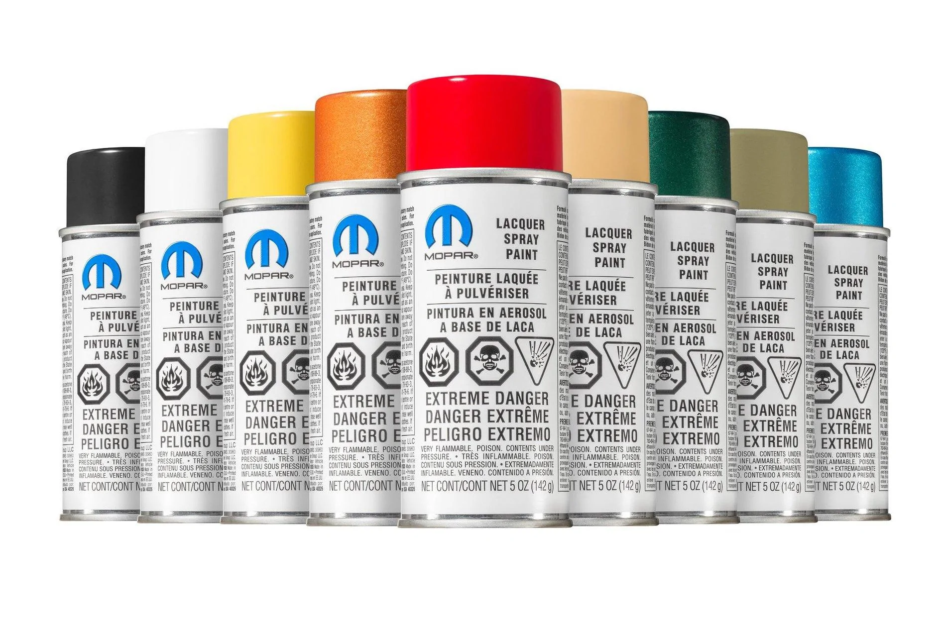

That'll do but it's not the company I was thinking of. What I saw before was a two stage can with an inner cylinder that was punctured when you were ready to use it. The inner cylinder held the hardener and once mixed and applied it was as good as professionally sprayed paint. You still have to buff and polish it just like a pro job.
