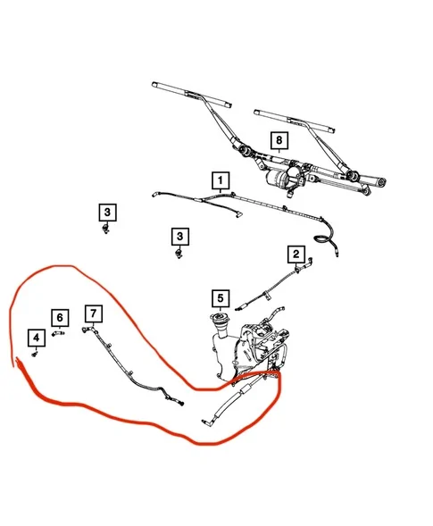

So did a little more research. On the washer diagram, you can see the main nozzles are item 3 and the main washer hose is item 1. I’ve deduced that items 4,6,7 are the trail cam washer hose and nozzle. There seems to also be a pump below the reservoir for the trail cam. When I get my Jeep back from the dealer I’ll try to pull apart the reservoir and investigate if the hose and pump are there as well as the harness. I really hope so otherwise I’ll give up on the washer idea.

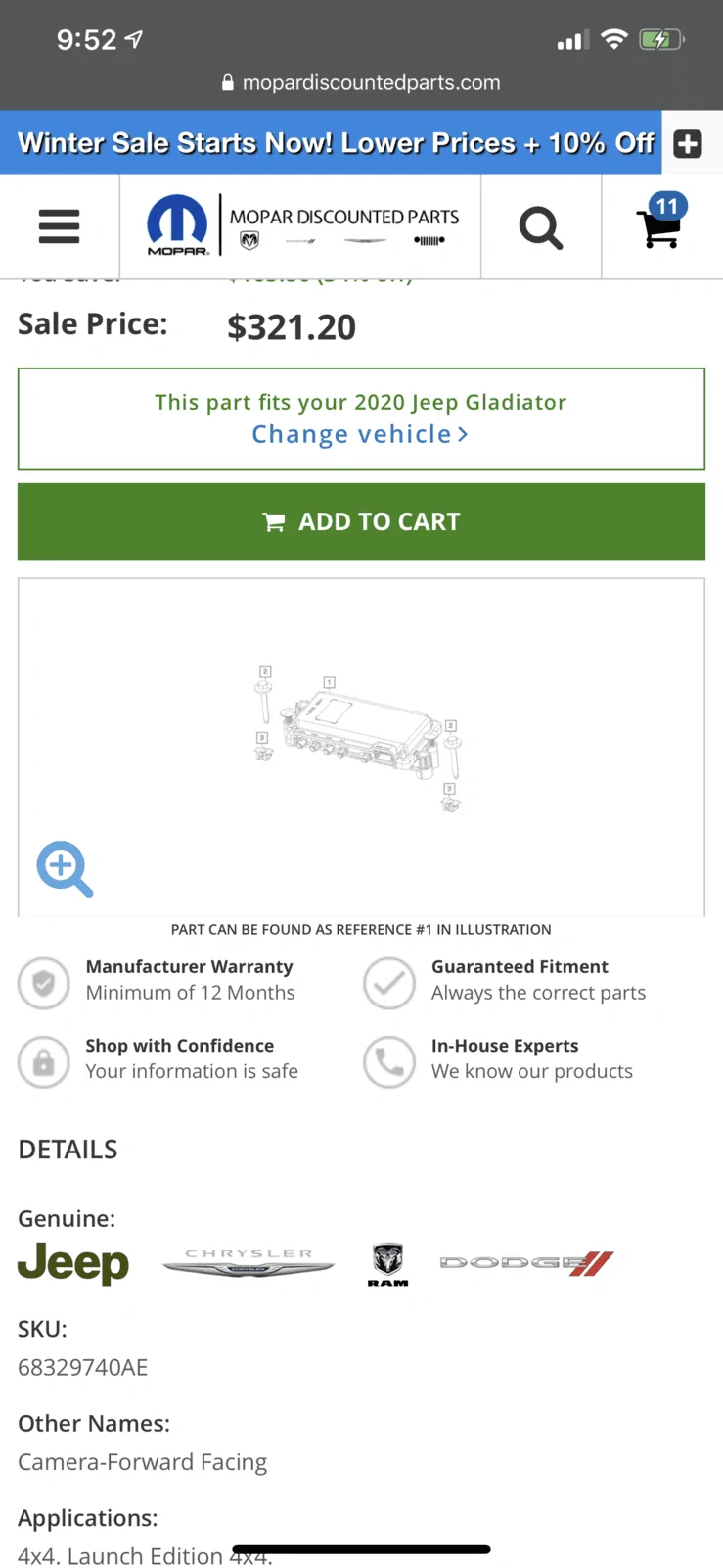

Also found a part called a video processing module for the front camera.

I saw the video processor too. It's pricey. Wasn't sure if it was for the front camera or maybe both cameras.
Maybe that video processor gets you "HD" for the front ? like the back ? I am hesitant on the aftermarket trail cam because I want HD in the front like the back... It seems that might be possible with the OEM stuff ?
