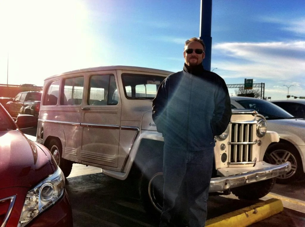

I wouldnt worry about it the picture issue. At any rate, if the engine is recently rebuilt then that part is probably fine, other big concerns would be transmission and rust. Transmission could be anywhere from 1000-3000 to fix depending on variables. Rust on a vehicle of that age could be anywhere from minimal to gaping holes, and you'd have to figure out your comfort level. Personally I dont like anything with body rust because its harder to fix, frames I can fix. I've ran into issues where people epoxied a plate to the floor board, doesnt stop the issue. Typical places are wheel well, fender well/seams, floor board, a/c holes in firewall, anywhere where leaves can get traped and stay wet, like around bed/tailgate crevacies. I love old jeeps, I've had Cj's, Xjs, Willys wagons, Wagoneers.. this is my wagon I had for a few years, would drive it to work weekly.
