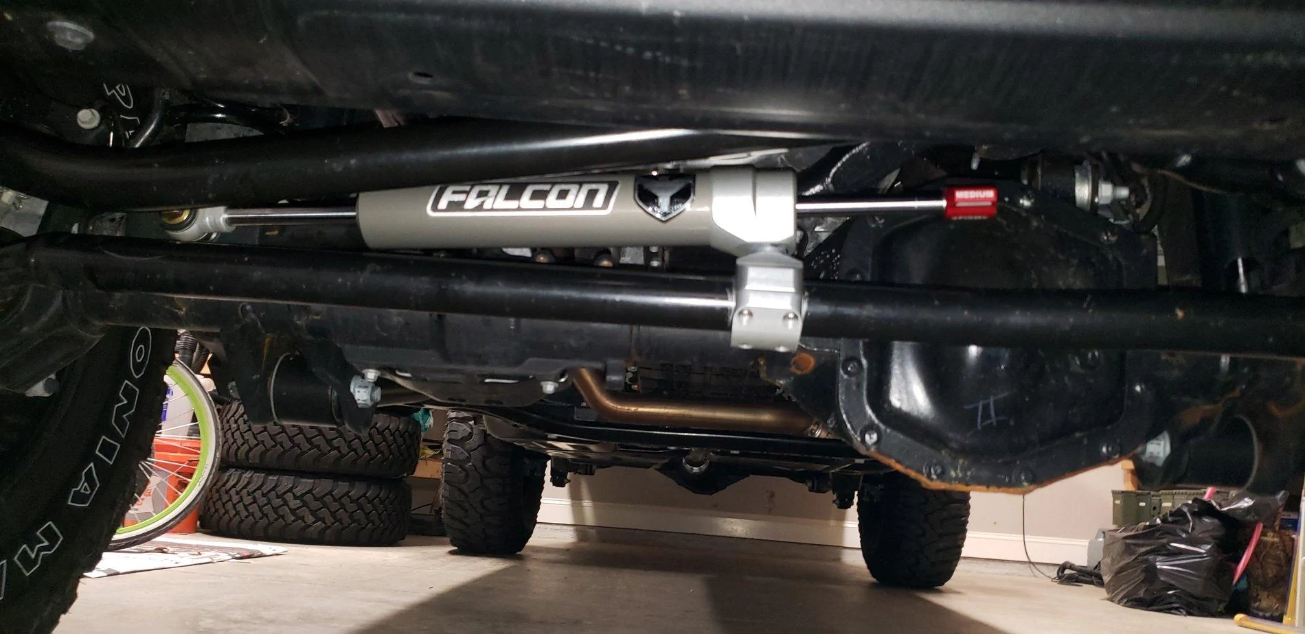

I’ve been hearing and reading about many people tightening up their steering feel by using adjustable steering stabilizers. After a couple of weeks of research I decided I wanted to go with the Falcon Nexus 2.2 but, the location of the JT stabilizer is just begging to be smashed on a rock the first time it leaves the pavement. Not wanting to spend $300+ on something that was going to get destroyed I sought out to find another solution.

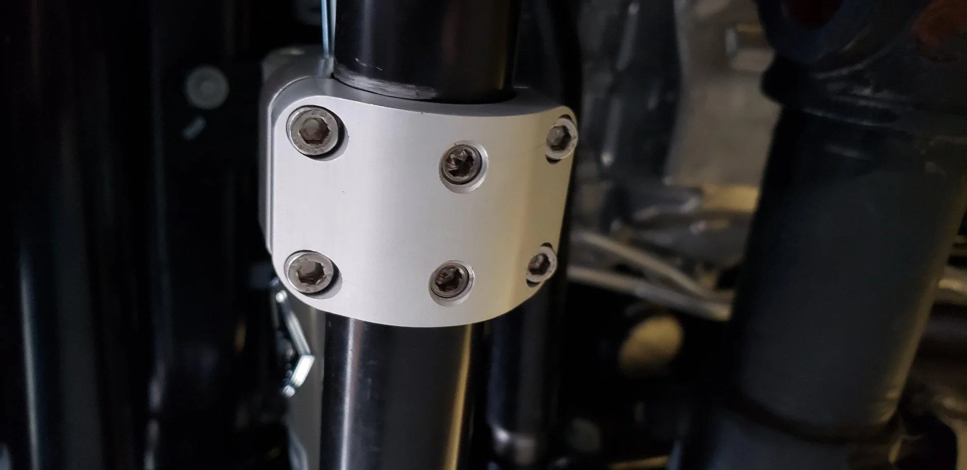

I noticed that the JK version appeared to be the same as the JT but came with a tie rod clamp that would allow it to be flipped on top. It also turned out that the track bar bolts are the same size on each so I went ahead and ordered it. Note, there are two sizes, 1 3/8” and 1 5/8” and my tie rod measured 1.57” which doesn’t match either of those. I figured it would be easier to make a bushing if necessary to fit the larger size than machine the smaller size to fit (for me at least). I ordered the 1 5/8” and it arrived next day from Northridge 4x4 (use one of the many discount codes to get 10% off)
https://www.northridge4x4.com/part/...us-ef-2-2-adjustable-stabilizer-1-5-8-tie-rod

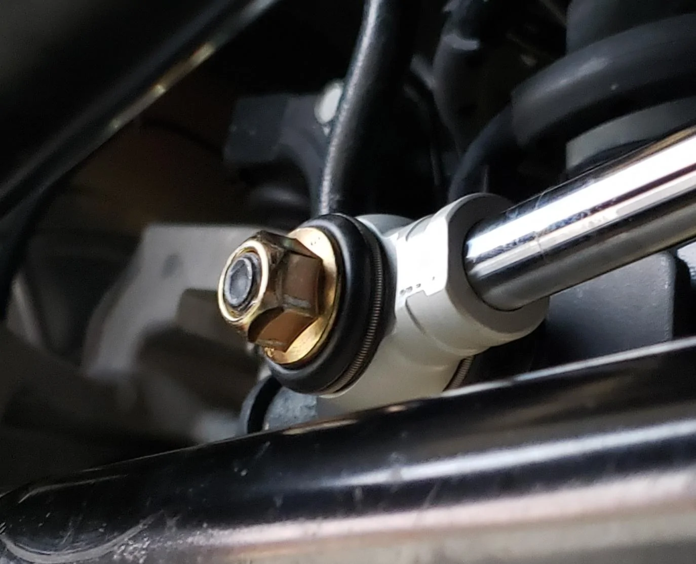

I’m not going through the install directions here as it’s pretty basic stuff but, it took me about an hour. I was pleasantly surprised to find a couple of set screws on the tie rod mount so I was able to mount it without a bushing. I was also happy to find that TeraFlex must have made an update at some point as this one had a track bar bolt with a stud for the stabilizer. I bought a synergy relocation stud as all pictures online showed a swivel stud that I planned to remove.
After applying some paint marker lines and test driving for 25 miles or so everything stayed in place. Bottom line, the JK version in 1 5/8” works as a flipped steering stabilizer on the JT.
