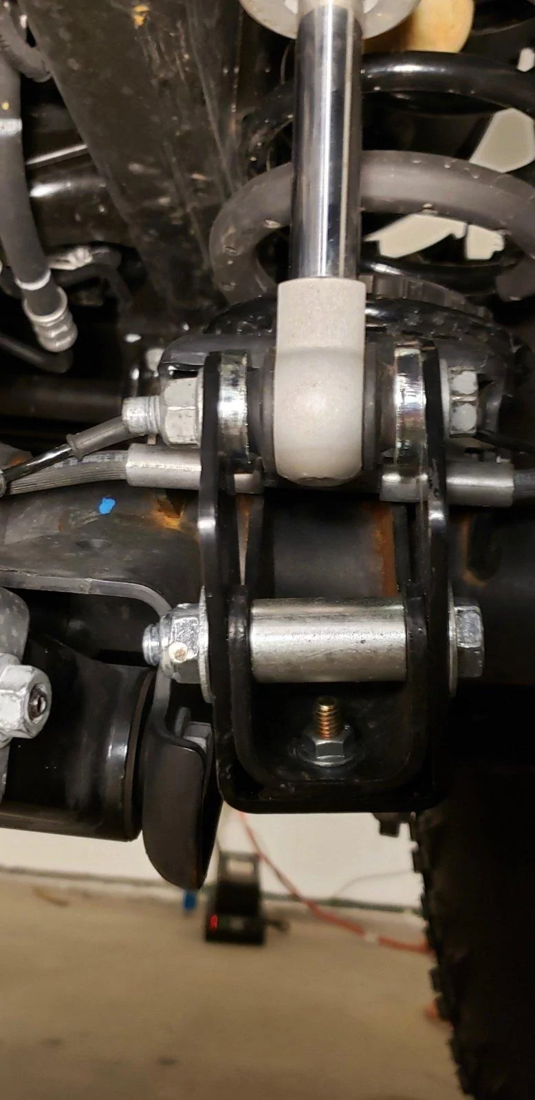

Gotta ask.. just to ask.. When I got the Gladi, I got some Falcon shocks that are 0-1.5" of lift shocks.. Can I get away with having a 2.5" spacer on the front without shock extenders? Would suck if I needed to drop some more cake for shocks again.. I do have shock extenders on there now, but I just don't feel right with those ..

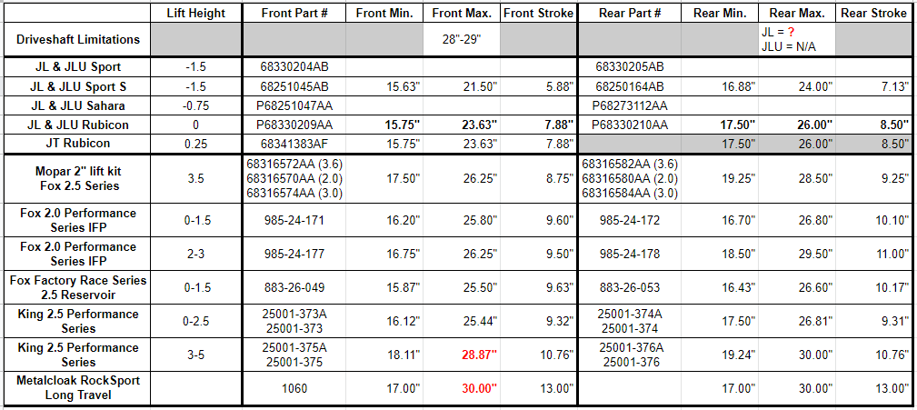

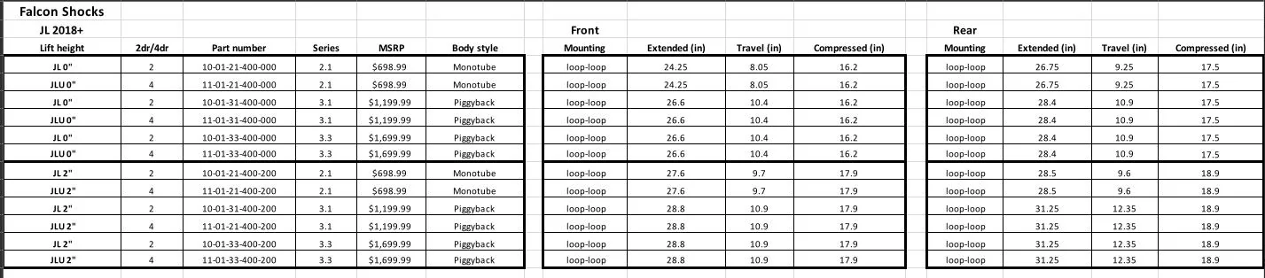

Do you have spring spacers on there already? It’s would be a bit odd to have shock extensions but no spacers or lift springs. Here is the Falcon JL shock length chart, as well as another listing stock shock lengths. The JL front is the same as the JT. There’s nothing wrong with running shock extensions if the shock travel still matches the suspension travel.

Hi .. yes I do have a 2.5" puck in there at this time
