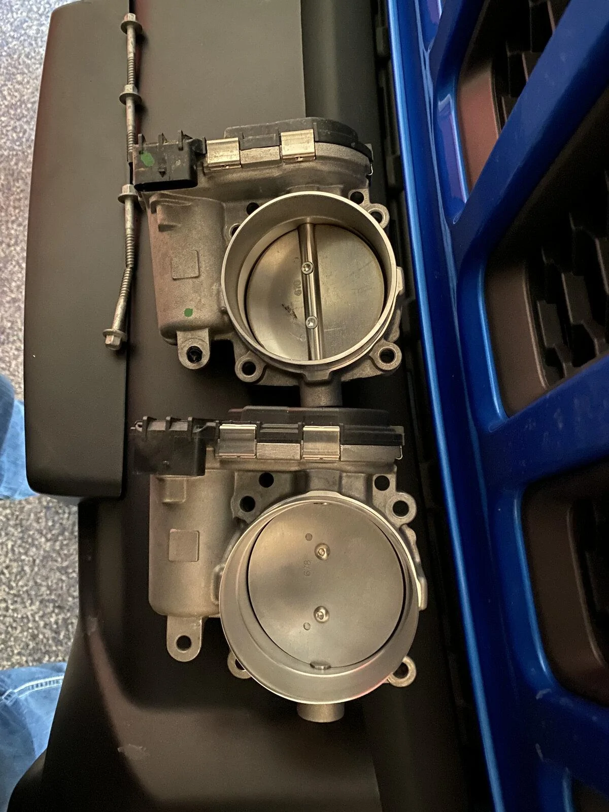

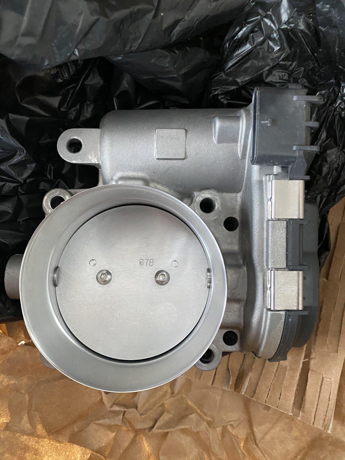

Oooh. Extra special thanks to @TroutFishingInAmerica who graciously thought of me when he ended up with an extra FastMan throttlebody on his hands, and offered me a great deal on it.
Heading out to bolt this guy in now, will update with more pics.
Jeep Gladiator FastMan ported throttle body installed C44A2822-3688-4D09-AC08-0AA3A2E0B6CD
Jeep Gladiator FastMan ported throttle body installed AE8D3026-1006-4AC2-A8FA-05295AC4FE85
Install was easy. Pull the intake snorkel and its 4 bolts. Quality of the porting work is top notch, and the mod to the butterfly is a nice touch of attention to detail.
Im surprised at the amount of material they found to remove, because porting TB’s is definitely “old magic” given the machining tolerances of today. But, they found material to remove, got part of the butterfly bar out, and ramped the inlet same as in the “before times”.
Noise of the intake changed noticeably, which tells me a change happened, but a dyno would have to show me what the actual gains are. Im interested to see any improvements to my mpg test loop soon, and when i baseline for my blower ill try to remember to swap the stock back on. Ill comment more after I drive it more, but i am surprised how much it changed the sound on first drive.
I certainly wont say this should be anyone’s first stop, but if youre doing an intake and tuning already, and looking for the last 10th, its a nice addition. ?

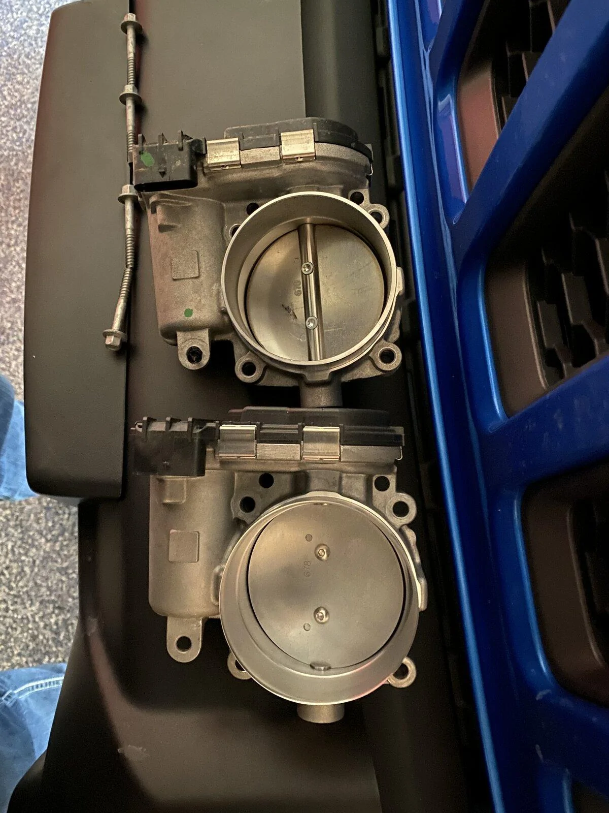

Old is out. Man the smell of oil out of the manifold was stronger than expected.

@TroutFishingInAmerica Really high quality work on the throttle body itself. The inner step is smoothed to the point of almost being gone, and the step/edge work at the opening is really really clean. The sound of the intake is different too. Im not perceptible enough to discern a 5-10hp change when its uniform across the board, but i will be extremely curious to see how my mpg route goes after a few days of adaptation; and i think Ill swap the old TB back on when i baseline for the blower to see what this did.
The sound was changed enough that i double checked the install and actually drove to the autozone to check for soft codes thinking i might have an air leak, so something for sure changed with it.
