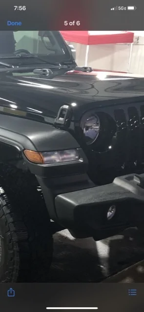

I noticed some people have a white light on the fender flare versus an amber… How does somebody swap that out?
I noticed today a friend of mine has a black sport S But he has white lights when he turned on his lights and my lights are Amber - how do I get white lights or LED installed?

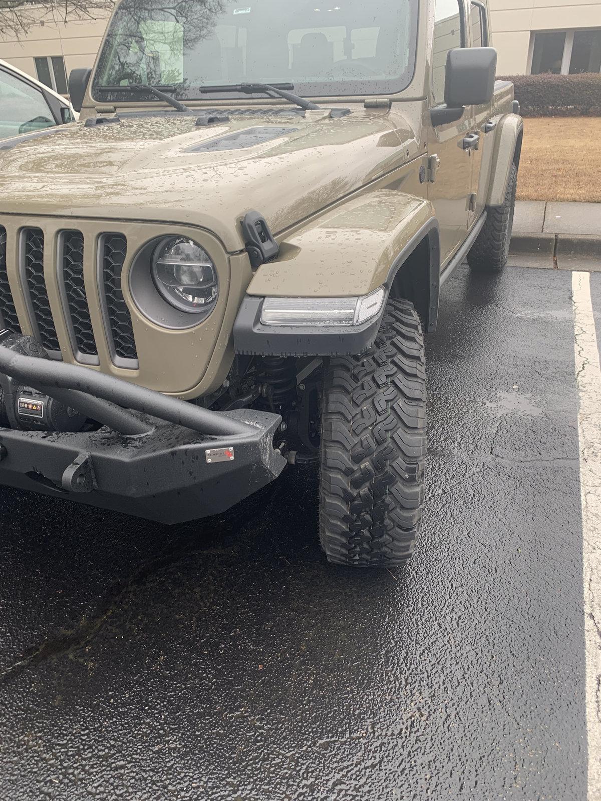

Do you mean the clear side markers? You can buy them for around 80 bucks or so, but they still light up Amber. Diode Dynamics makes these.

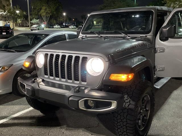

Max tow Sport S, Overland, and Rubicon trims without the LED package have different front fenders with turn signals and halogen DRLs. Non max tow Sport/Sport S do not have the halogen DRLs. You can see in your first pic the truck only has one light bulb per side while in your second pic the truck has two light bulbs per side. In the second pic the inner bulb is the amber turn signal and the outer bulb is the white DRL. The only thing you can do short of buying new fenders and rewiring them would be to buy an LED switchback bulb that will light up white when the marker lights are on and switch to amber when the turn signals are on.

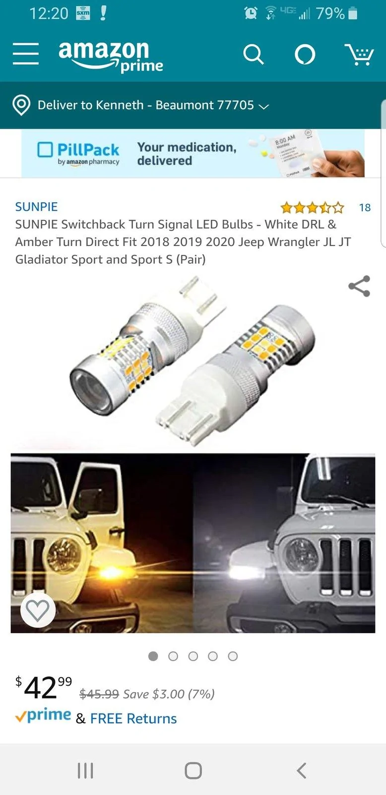

There is a switchback amber/white bulb that you can install. You will have to manually wire the DRL wire to make it work but it looks pretty cool.

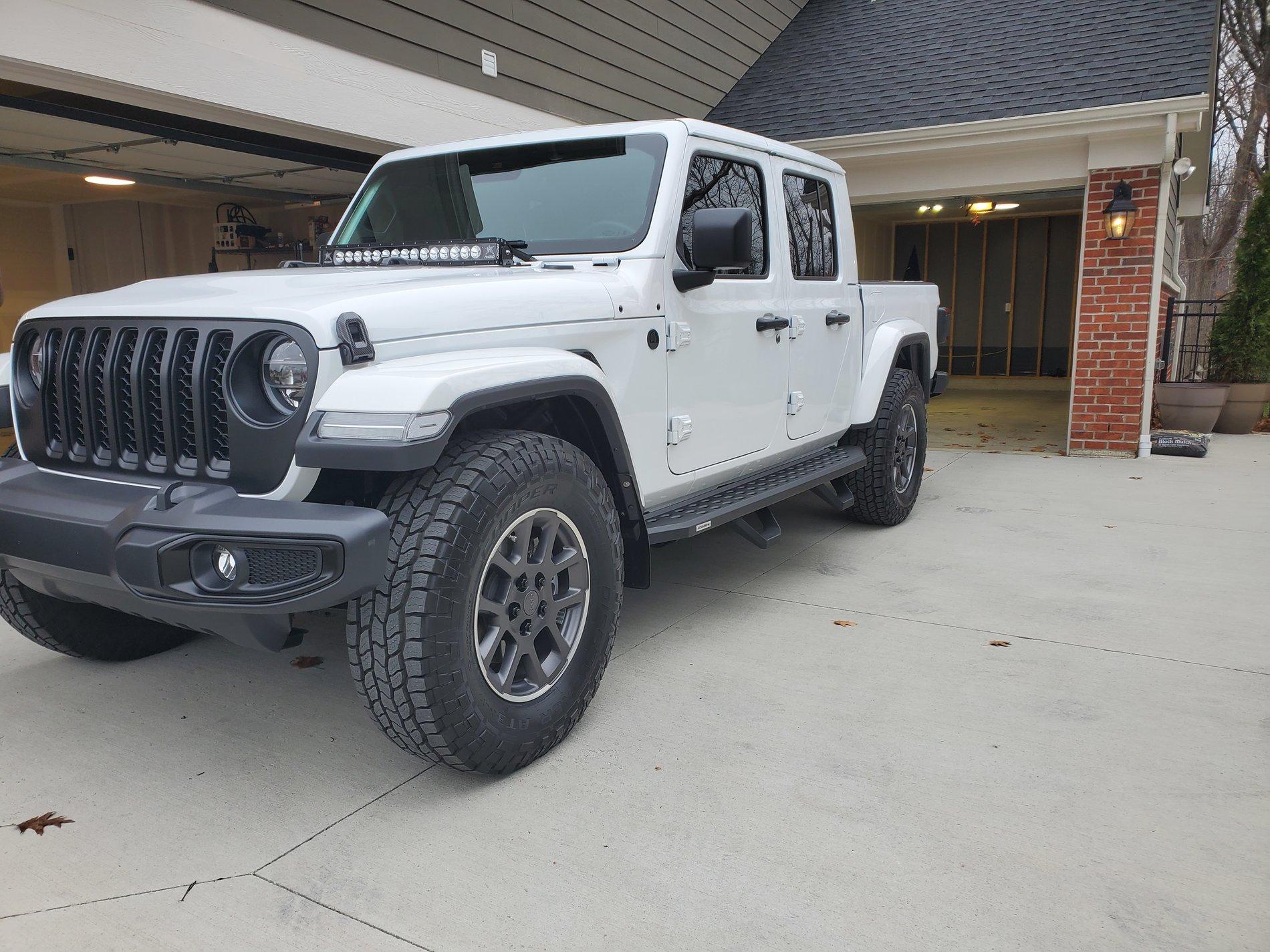

Diode dynamics. Clear to clear. Fits the Gator color well.
