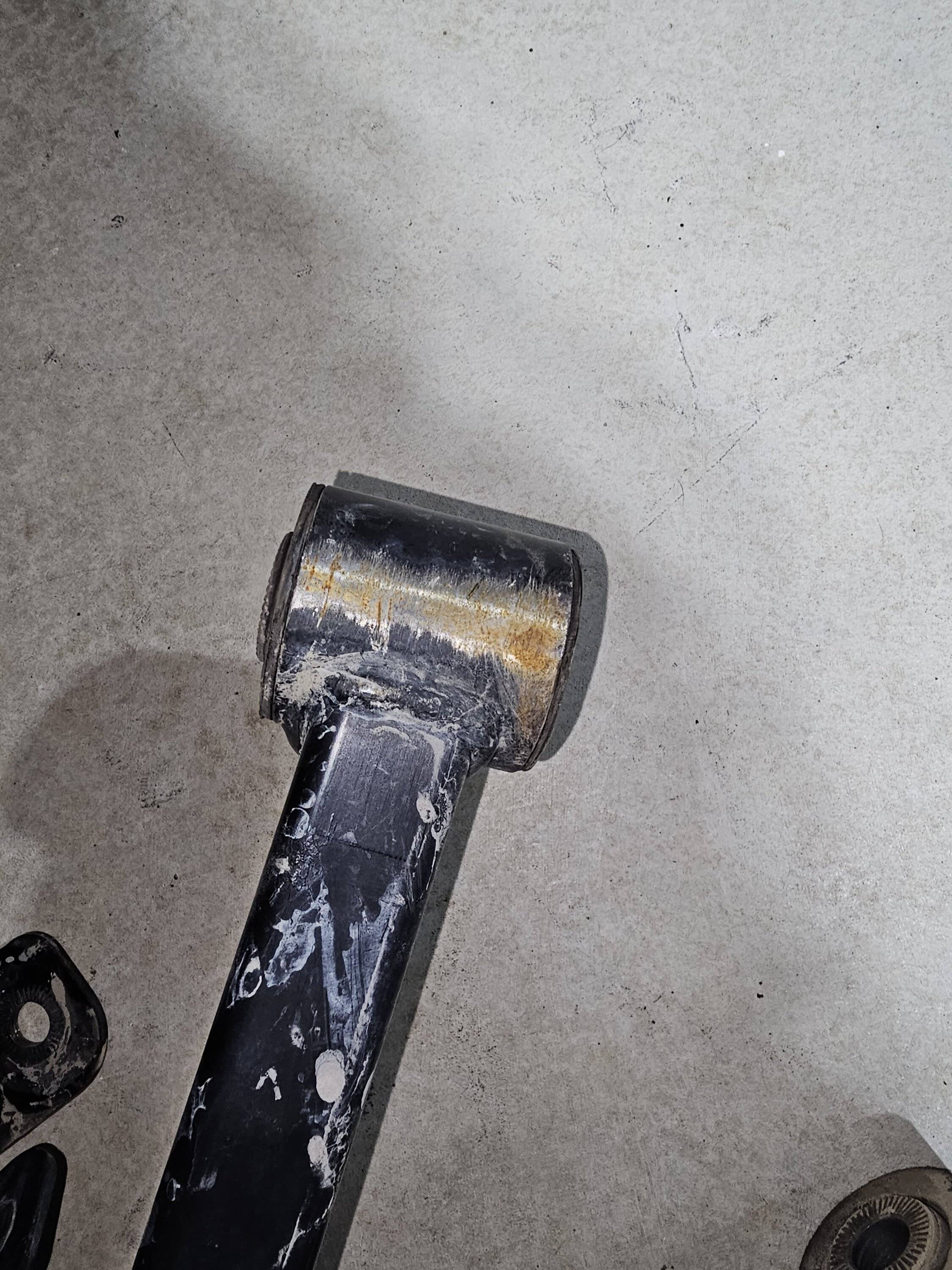

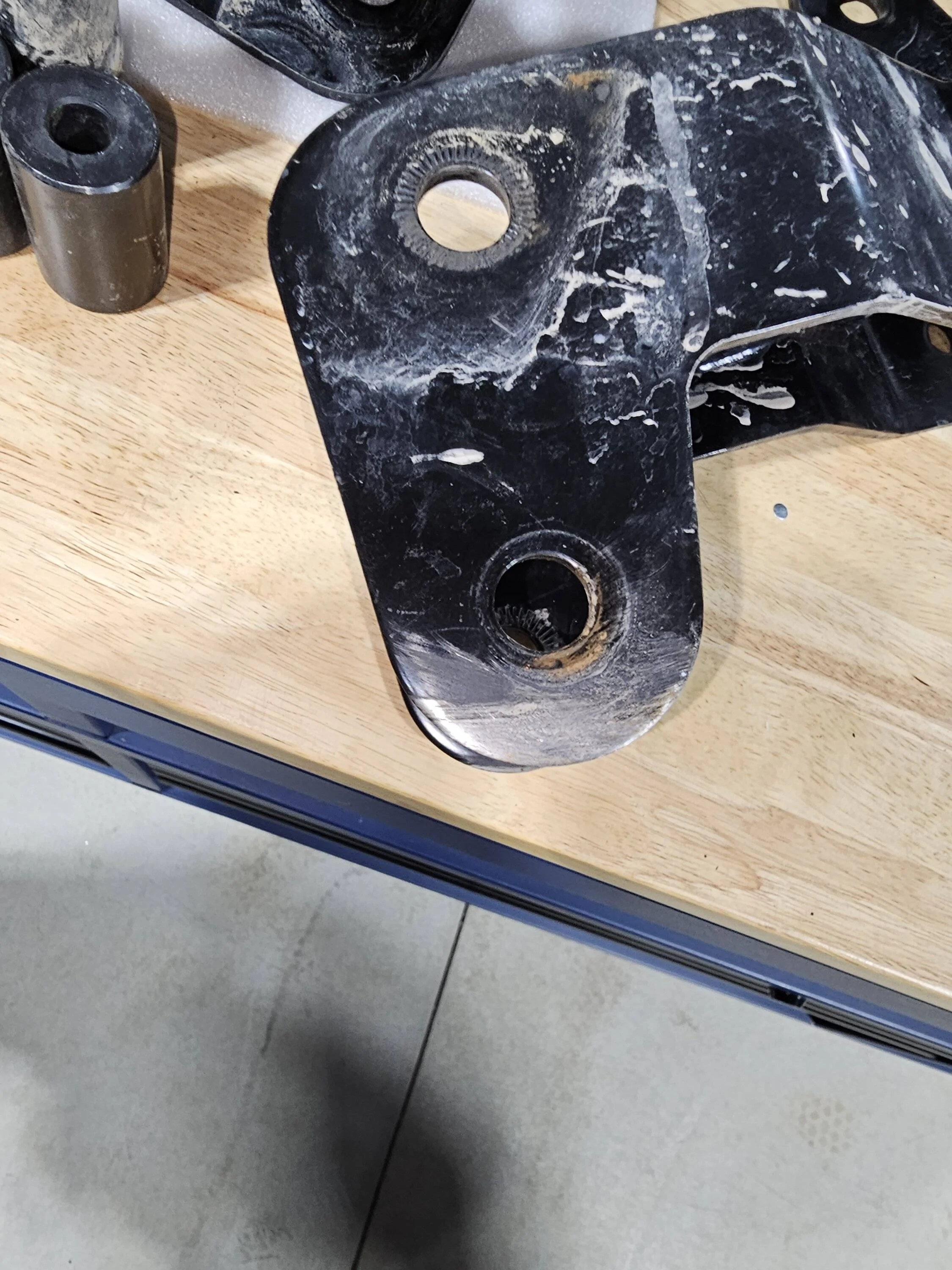

So was running 35's on 3inch lift with Rancho geometry brackets. I had core 4x4 adjustable control arms for 6 month sitting on my toolbox. I been debating on taking the geometry brackets off or running them with the adjustable control arms.
So last weekend went to Holly oaks orv park in Michigan. Nice park nothing really hard so I choose a concrete obstacle and I heard it hit. So this weekend I decided to put on the adjustable control arms. And to my surprise not only scrap the geometry brackets it scraped the stock control arms at the geometry brackets mounting point(see pics) then I notice that mounting point had a slight bend. It was barely noticeable.
So I took them off and running just the adjustable control arms. They will hit and cause damage if you do any wheeling don't use them. You are asking for trouble and possible failure on the trail. Just my opinion for everyone.

This has been discussed so many times. But damaging a replicable bracket is far better than damaging the factory welded non-replicable bracket. You will still hit the arms, only now will be hitting the factory welded brackets too. This is why companies make control arm bracket skid plates. It's hardly, IMO, a reason to ditch brackets. You will have better ride quality with them, which is the point of them in the first place.

1st they hang 4inches Lower as I measured them. Your not going to bend the factory brackets as they are recessed. And of course it's been discussed how many people post pictures or just run the mouth. And my ride has not changed and steering is great. I believe geometry brackets are not needed and for people that don't wheel. Because with good quality parts and installation you don't need the brackets.

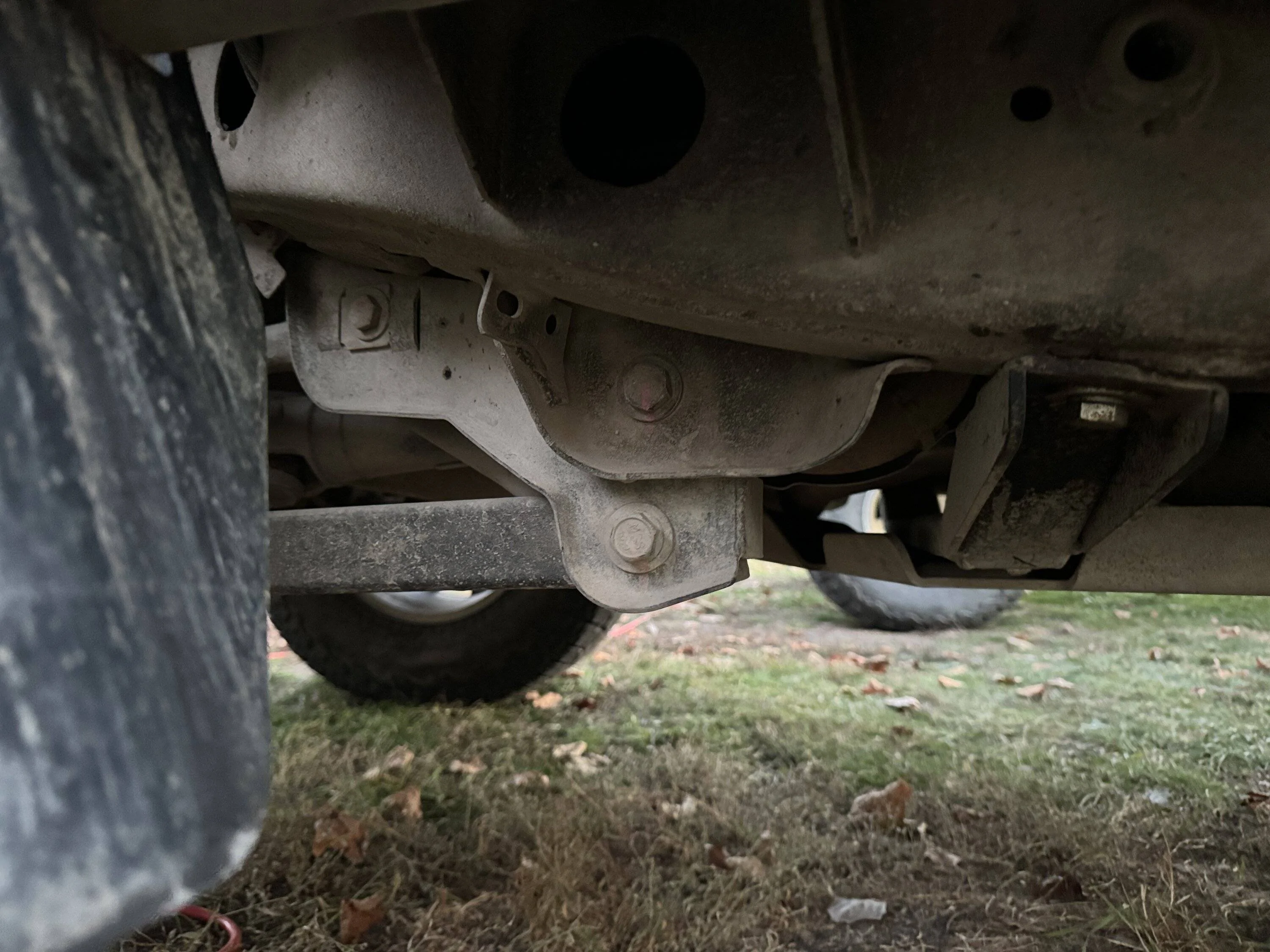

Factory brackets do in fact hang down. They are not recessed... Here's a photo reference.
Running just adjustable arms works for you and thats awesome, glad you like your configuration better. Ride quality is a very subjective statement.
