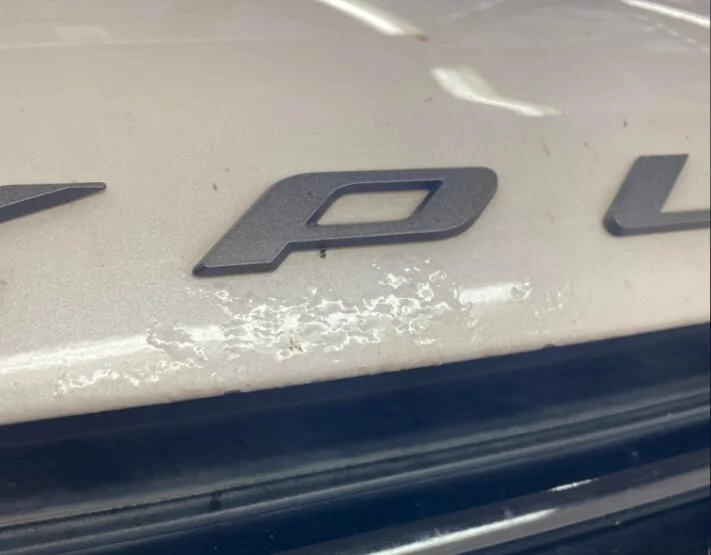

FINALLY saw my first corrosion case yesterday.
wranglerrush
Jun 12, 2020
46
Scranton, Pa
'20 JT
On the hinges, correct? Not on the door skin itself?
Majority on hinges, but there are small bubbles forming on door skin. The 2018 friends wrangler was all door skin six inches up along entirety of two doors bottom. That was a few years ago before I saw it on any of ours. I thought his was from possible clogged drains or something in the door.
wranglerrush
Jun 12, 2020
46
Scranton, Pa
'20 JT
What about inside the hood - where the hood framework or skeleton has the aluminum skin crimped around it? I expect it on ALUMINUM where it contacts steel.
Yes, it is at the seem on the inside edge of hood, both sides almost identical. Small bubble forming both sides
40,442
53,860
My hood looks terrible. Tailgate has spots too. And of course the hinges. I'll try to post some pics later.
Among the Ford and GM people, they keep talking "contamination" or "chips" - we know that our hinges are very prone to chipping and once there's a chip, all bets are off. Any compromise to the paint's integrity...... be it a chip, improper PREPERATION, or any contamination.
Jeep people need to check in with the Ford people - yikes! Some of them look like they are rotted so bad, they'll fall off. Tailgates, hoods, nasty problems.
Ford replaces the whole panel.
And that makes me think maybe Ford also believes it's a contamination thing - either in the metal itself (the aluminum panels aren't pure and clean) or prep............
Ford Exploder with the issue ->
That is how my hood looks.
I'm not sure if the bottom of the tailgate can catch rock chips. It might be possible.
I've had a few F-150s and haven't had paint issues. Current one is a 2020 without issues. Knock on wood.

I have seen it in the MIDDLE of the tail gate.
FORD and CHEVY have had problems with it on their hoods for years.
But it's ONLY a Jeep problem - just ask a Jeep person on a forum.

Now - if someone wants to try something, there's an easy way to prevent galvanic reactions real or imagined!
Look at the screws for the hood and door hinges - plastic sleeves preventing the STEEL bolts from direct contact with the NON-steel hinge. Allowing that bolt to contact that hinge, which is likely an aluminum alloy, perhaps a zinc or magnesium alloy, would be a problem.
So try this:
Door closed (to hold everything in place) Shim between the bottom of the door and the door sill or rocker panel if you wish with something padded to further prevent sag of the door while hinges are unbolted.
Remove the bolts holding the lower hinge to the door.
cut a piece of mylar in the shape of the back of the hinge, put holes where the bolts would go through, and put that mylar between the hinge and the door skin.
Also make sure the steel bolts cannot contact the aluminum alloy door skin - they ARE steel.
Do the same for the top hinge once the bottom is done.
Once you prevent electrical contact, it's impossible for any galvanic reaction.
Galvanic reactions also REQUIRE an electrolyte - water, etc. - so if it's dry, there can be no reaction.
The insulator can be extremely thin - it only needs to prevent contact.
Seeing the bolt sleeves should show that Jeep is aware of how metals react with each other. They ain't stupid.
