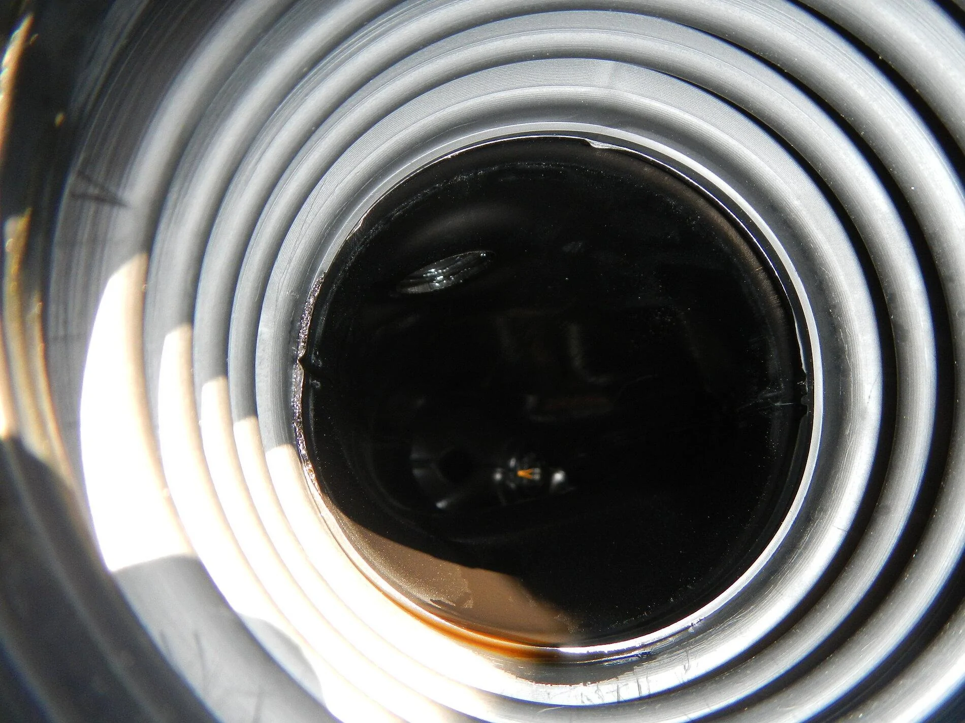

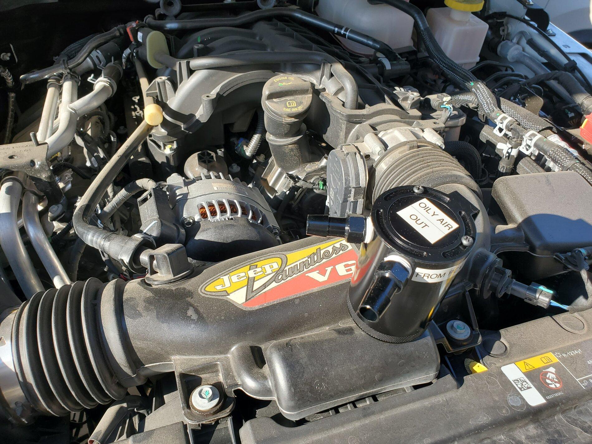

UPR is the silver one, Generic one is the black. I'll be getting another UPR to replace the generic one, (just so it's the same). I'll post pics later of what is in the silver one later today. Super easy to install. UPR comes with stock style fittings so its plug and play, also UPR has a drain fitting so you don't have to unscrew it all the time. "Also had to include a pic of the jeep as well"

Where does the second one connect? I assume the UPR one connects/intercepts the EGR on the drivers side of the motor. I have had one on my truck for about 15k miles, I have to empty it every 3-4k miles, more frequently when towing a lot, surprising how much stuff it collects.

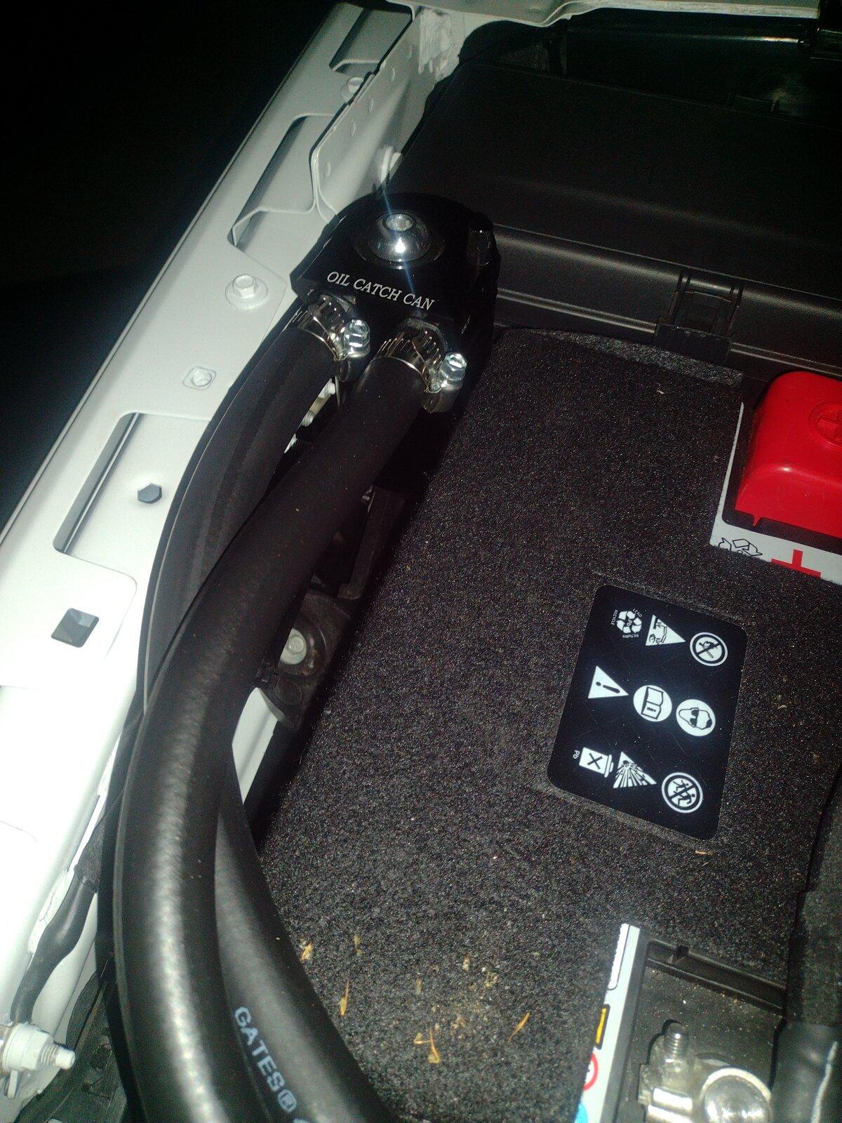

So you're running two catch cans in-line, or something different? Pics of the whole setup?

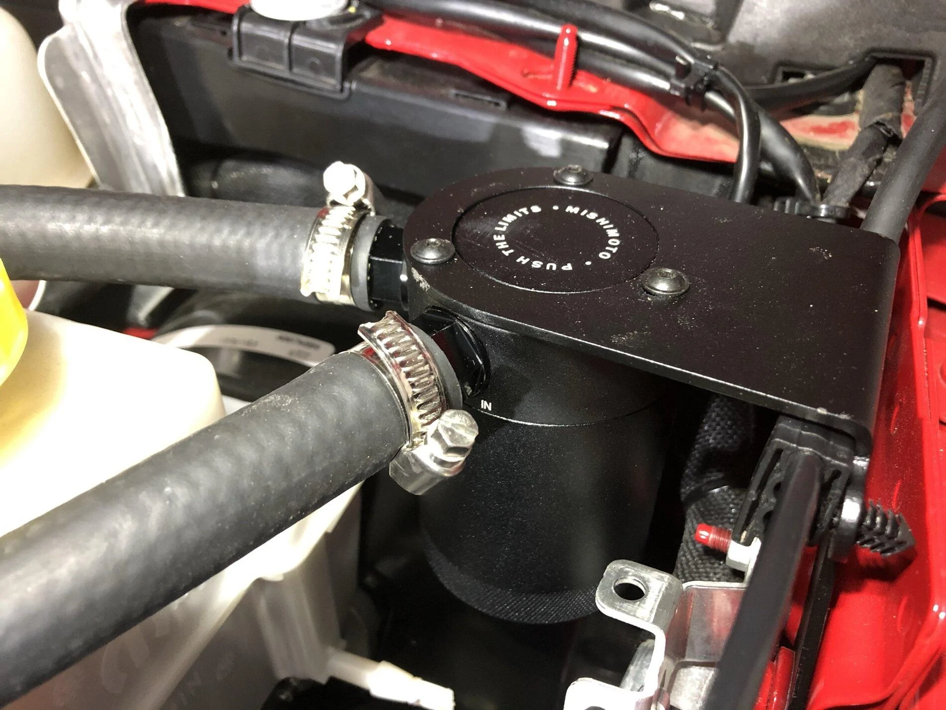

i just installed the mishimoto and knock is 95% gone on 89 octane. I tried to put the jeep under load, low speed, uphill at 1,500 rpm in 90 degree weather, 400 ft elevation, and i could not get it to knock but once. I'd call that a win. I think not having to burn blow by on lower octane fuel with 11.3:1 compression makes life easier on the pentastar
but curious about your two-can setup as far as how the lines are run for the two cans

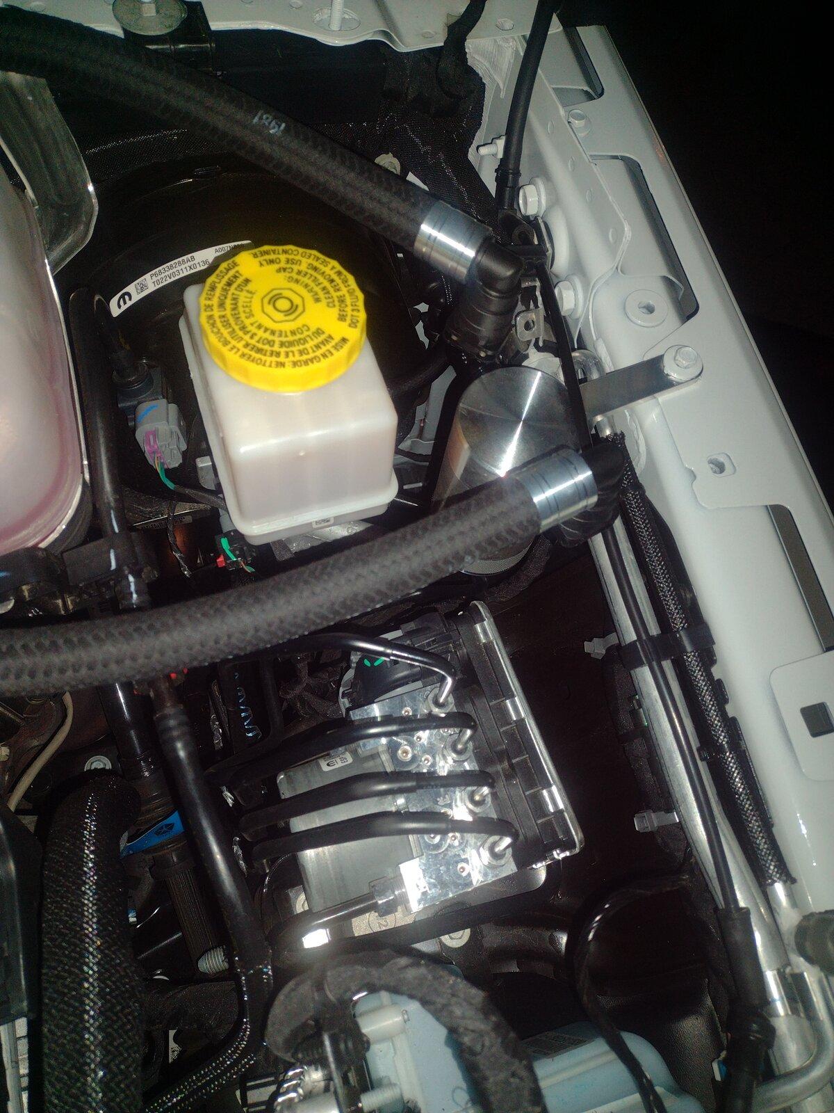

Ive noticed oil in both sides of the PCV. Intake side obviously, but also the fresh air side at the air cleaner end. Took off the air filter housing and saw a small pool of oil beneath the fitting that goes to the crankcase breather.
Im gonna try the two catch cans. One on the intake manifold run and one on the air cleaner run.
I got two of the style with the baffle plate and sintered bronze filter.
Gotta finish the mount bracket still...

I just bought a Mishimoto, haven't installed yet. UPR is cheaper and I think I like UPR baffle set up and hoses better. Still the Mishimoto sould be fine, haven't heard anything bad about it. Raining today, put it in tomorrow. I have to poke around and see where you are installing the second one after I get this one installed.
