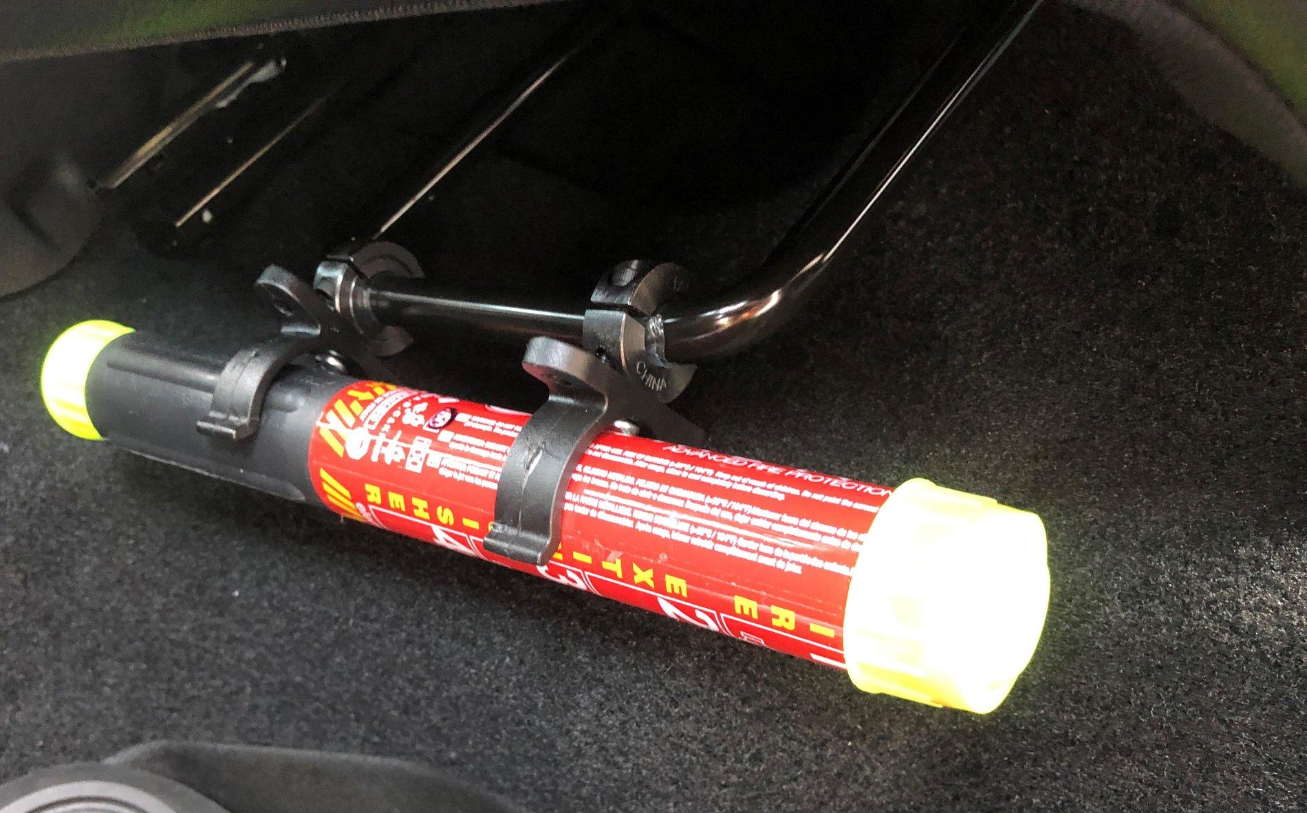

I have one of these in the netting in my driver door.
I just mounted one of my Element fire extinguishers on the driver's seat adjustment bar so its right under my legs.
I used two 1/2" split shaft collars that I drilled and tapped for a 10-32 screw. I used the screw to attach the shaft collar to the plastic bracket and clamped onto the seat adjustment bar.
Its the first mod to my new Overland (147 miles now)
