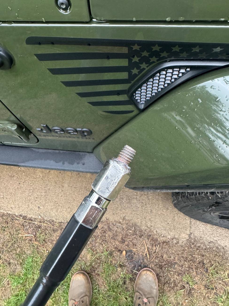

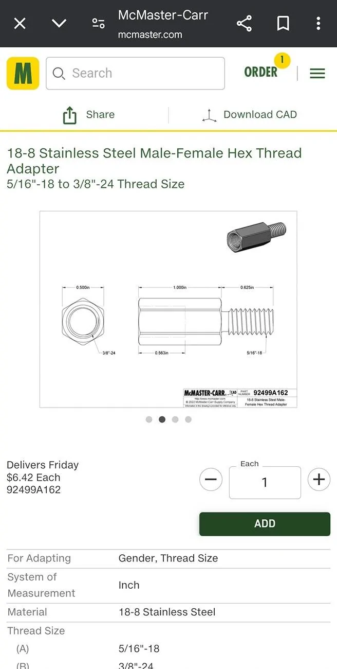

So I’ll have to get pics after work but I did this to mine as well. I did find an adapter but I wasn’t about to pay for the shipping. So I ended up making my own adapter. Eventually I’ll be having the machinist at work make me a prettier one.

Maybe make a few extra because I bet I'm not the only person who wants to do this. I would get a bar and make as many as you can, then price out labor+materials+shipping

If it’ll let me post a pic this is what I did till I can have my machine shop make me a nicer one

I also thought about running a new wire with an adapter for the radio. Probably need a new mount.

When you have the nicer one made, send me one and I'll cad up a black cover sleeve. I'll QA it's fitment and send you some 😉

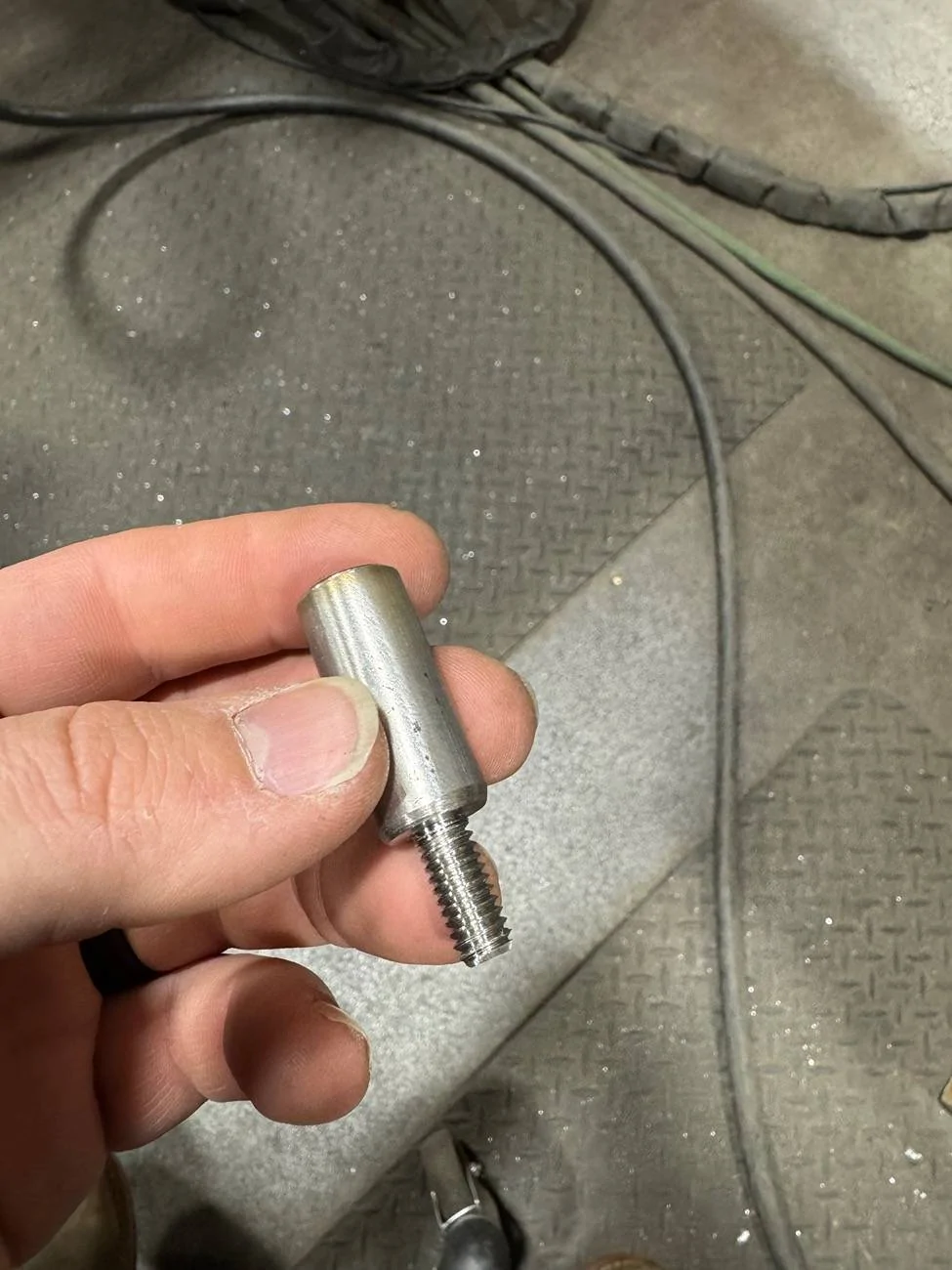

i planned to make a few of them so I could do that. Just deciding how the best way to make it. Either have the threads machined onto the stud for the base like what I made already or machine the threads inside of a solid slug and you’ll just have to put an Allen head thread insert in the base.

I don't have a functioning radio, so the first to go will be the antenna. If it doesn't work I'm pulling the radio to look.

Got one made out of SS at work. Now to test fit it and see if my measurements are right.

Looks clean, if it works I'll make a cover out of PETG if you want.
