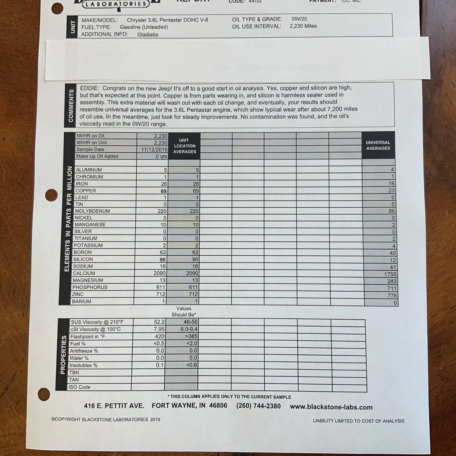

I thought it might be helpful if I sent the oil out for analysis ....
In other discussion on when to do your first oil change the thought ranged from 1000 miles to when ever the Jeep told you to which could be anywhere from 7500 to 10,000 miles depending on your driving habits.
As I’ve said before based on a recommendation from a friend who has been in the R&D side of oil and fluid research I try to make my first change about 2000 miles. My younger son recently got married and that pushed this schedule back a few hundred miles but here is the result at 2230 miles...
As you can see there are several different metals that are quite high but according to the lab is nothing to worry about as the various components are just wearing in...
I’m going to let the new oil (Penzoil 0W-20) run for at least 5000 to 7500 miles before I do the next oil change and hopefully do another analysis. I also installed a Fumoto valve to make the change even easier next time...

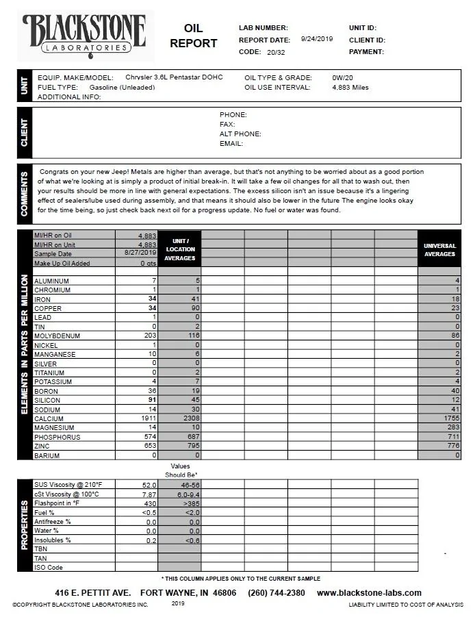

Here is my first analysis and I ran mine closer to 5K miles before changing the factory fill.
My copper is lower than yours with a slightly higher iron values. My experience with other Pentastar's I have owned is that copper will take few oil changes to start going down to universal averages. FCA oil coolers are known for a lot of copper trash left over from manufacture.

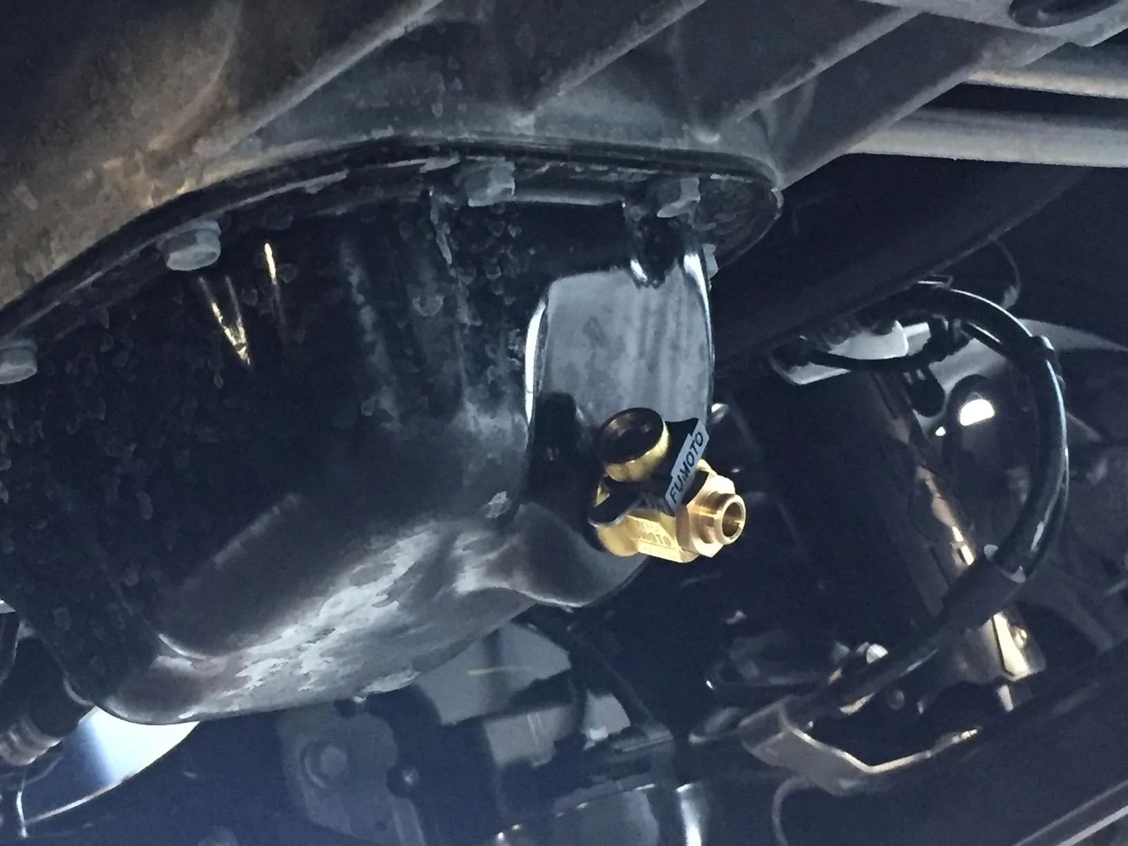

I'm going to research this if I remember to do so.... but what is a Fumoto valve?
It replaces the drain plug so that you no longer need hand tools to drain the oil.
Exactly!
It also makes it easier to take oil samples. I have one on most of our vehicles.
Edit to ad a picture of it installed for those interested.

thats a good share. Thanks.

Just an FYI. You can see elevated levels of copper and iron in your oil for 10's of thousands of miles as bearings continue to break in. The only major break in that occurs during the first 5k miles is ring seating.
The 5.7 in my Ram and 3.6 in my JKR showed elevated levels until about 30k miles. Then everything settled and started showing normal levels of metals.
