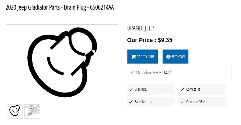

If I can recall correctly, the washer was attached to the bolt itself. Below is a picture of the part itself:

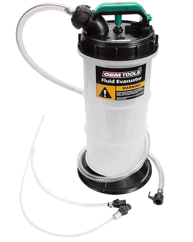

Change oil on a 3.6L with topside oil filter without touching the oil drain plug, not one drop of oil on the garage floor. I'll let the next owner worry about any residue if any left in the oil pan.

I knew the hate would be strong with this suggestion, but it also works so well on my riding lawn mower that really makes a mess when trying to drain the old fashioned way. Also handy for removing other types of fluids. First time I used it on my old JK after pumping the the oil out, I crawled under and removed the drain plug and got minimal amount of oil to drain out of the pan, so now I don't even worry about the very small amount of oil left in the pan.

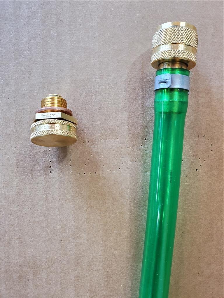

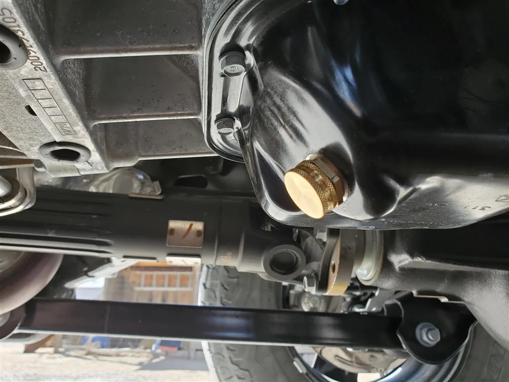

I put a Femco low profile drain valve on mine at the first oil change. Less chance of it getting damaged off road.

No, no removable washer on the oil drain plug... There is a very thick disc that is formed lets say, as part of the oil drain plug.
Also, no magnet on the plug.
