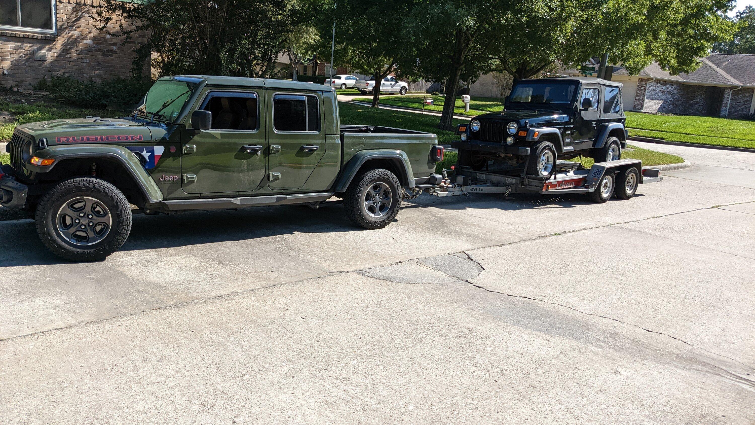

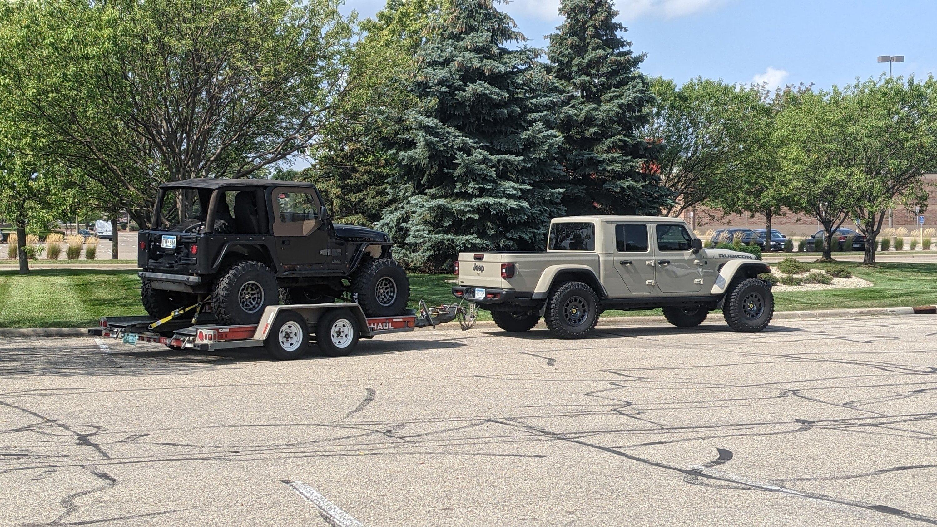

Set the hitch at about 20" and eyeballed the placement on the trailer. The car transport included tie down won't work for tires over 30" and the TJ wheelbase means pulling full forward is far too much tongue weight, so I eyeballed. The hauler does have convenient tow hooks front and back, just need the straps. The scale read 640# on the tongue which is very close to the 10% rule of thumb. And surprisingly, the Glad sat pretty level with this load and the 1" rake compensation. Ran the front tires at 34 psi and rears at 42 psi. And the TJ's at 6 psi, of course.

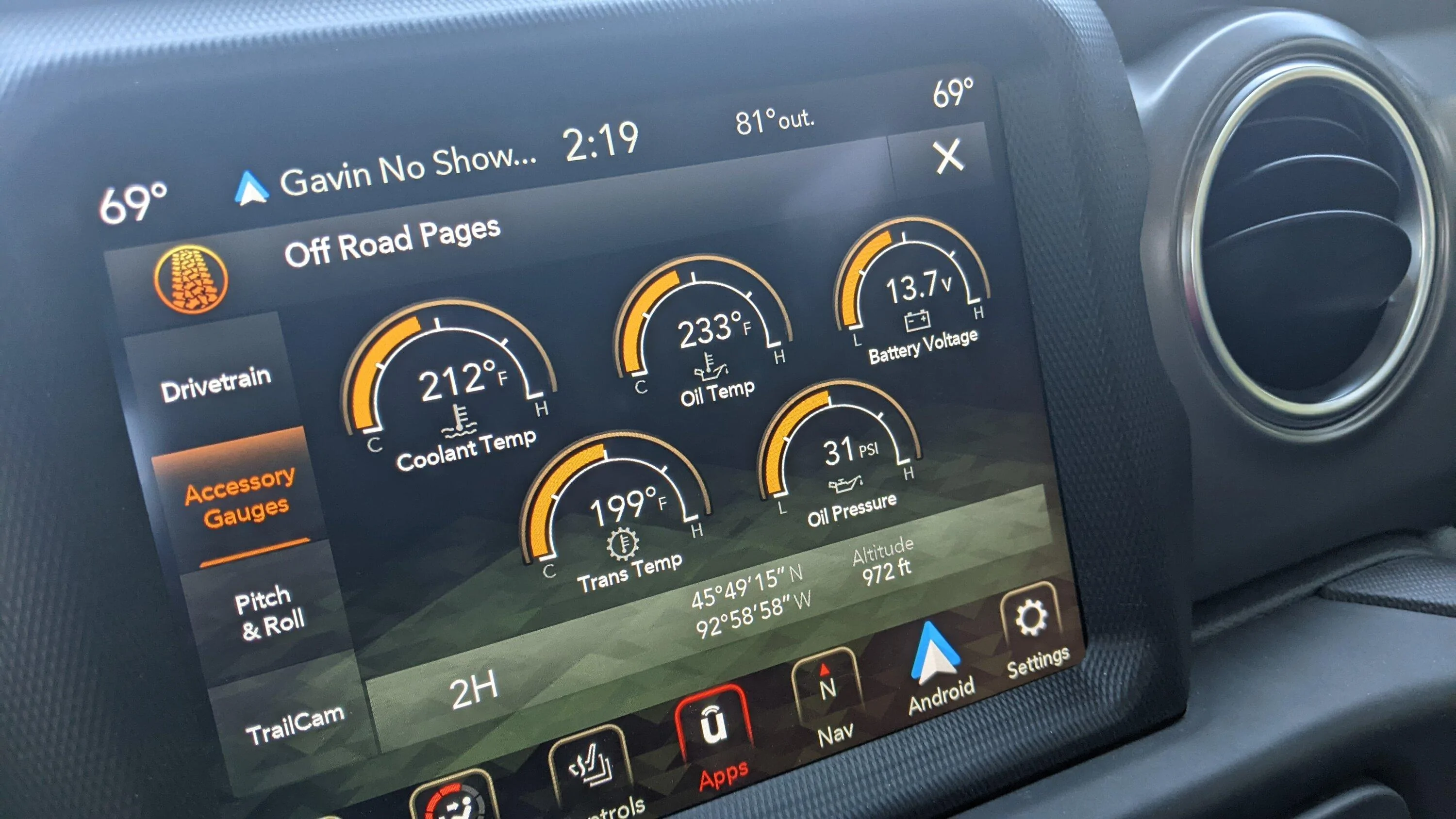

1.5 hours into the drive, all highway at 65 mph. I was running it in 7th gear and bumping down to 6th for bigger hills.

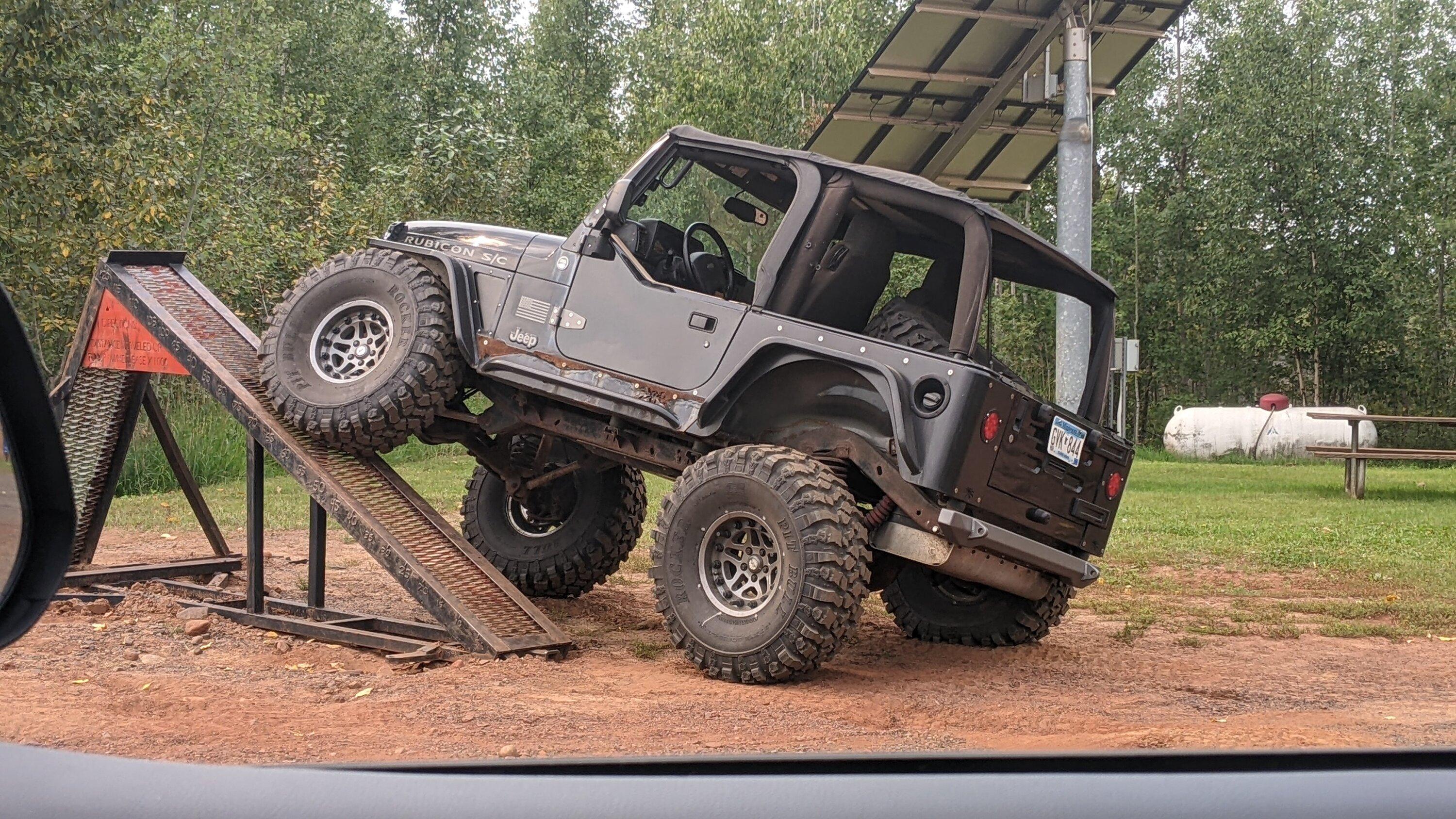

715 RTI on stubby t-rex arms

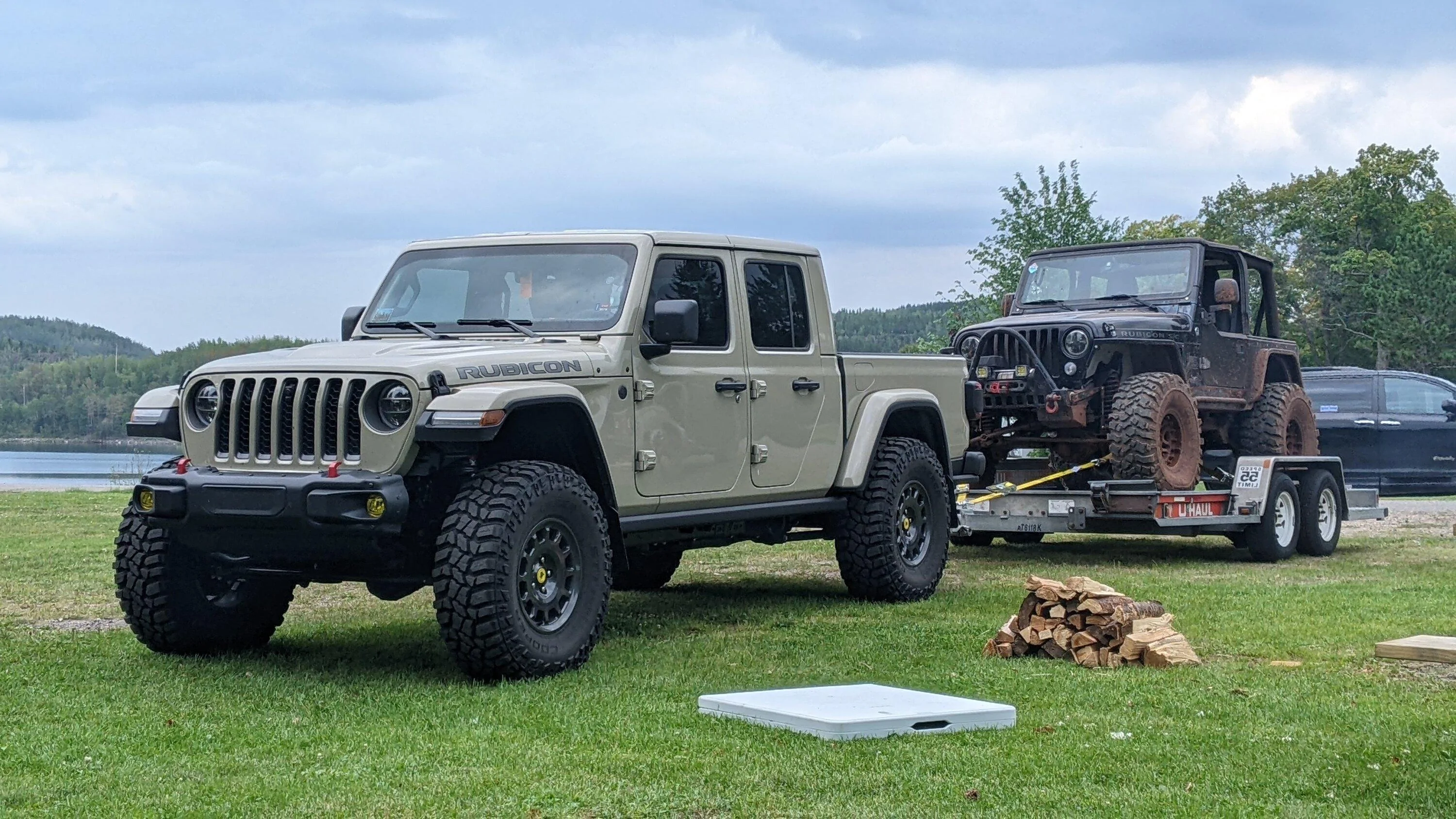

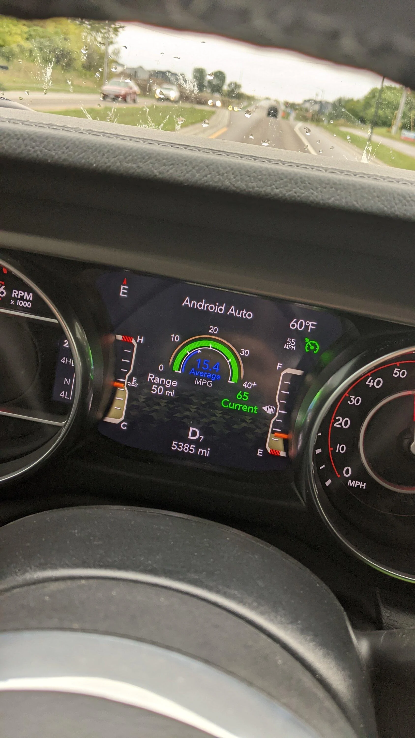

I didn't hand calculate the miles, but this is what was reported after 440 miles. Most of the drive was at 65 mph, gradual hills. Dropped to 5th a few times (3k rpm at 65) to hold speed up bigger hills but never lower than that, never had to put my foot clear to the floor. Stayed cool. Zero sway. The back is definitely soft, but controlled and never hit the bump stops, even over some pretty aggressive dips.
Overall it did much better than I expected, and I had absolutely zero concerns, very comfortable. Maybe if I can find a lighter trailer I could even get it under all the ratings.

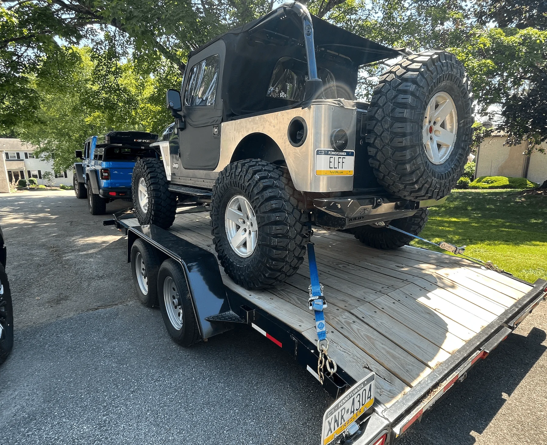

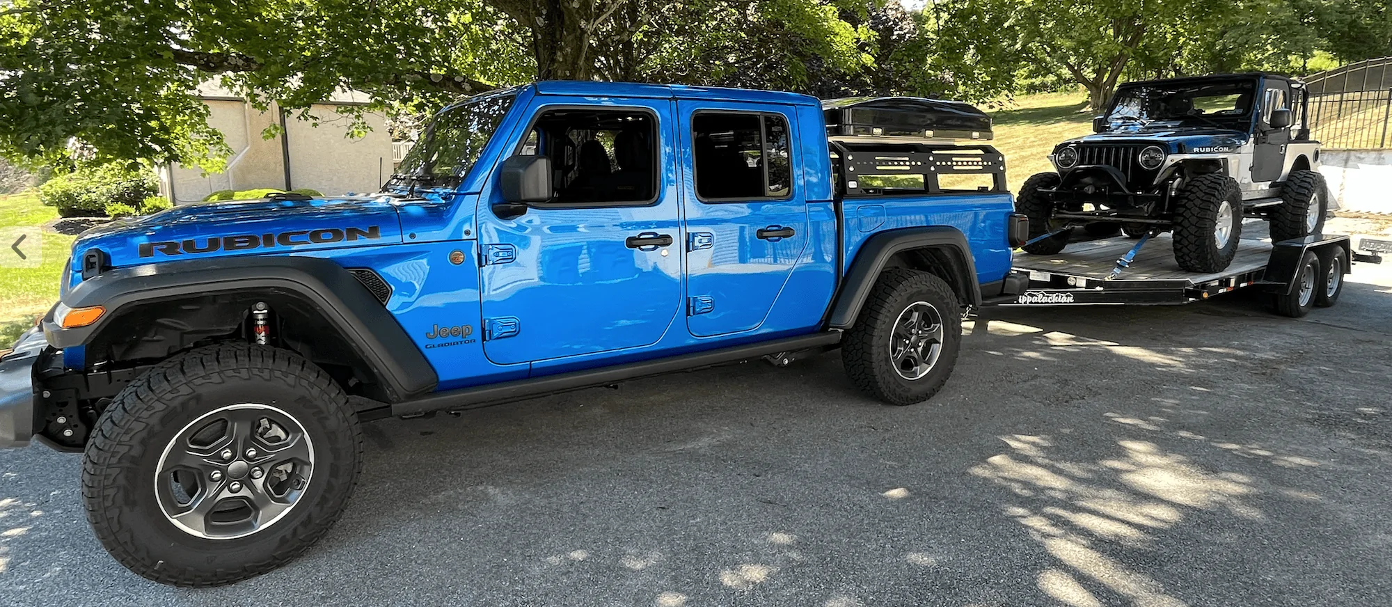

I regularly tow my Rubicon with a Gasser Rubicon. I estimated I am 5900 to 6200lbs so your numbers confirm that for me. I tow about once a month since February. I average 13.1 mpg but have to drop down a little lower in the gears on hills than you and I am on stock 33s. But overall, Towing a Rubicon with a Rubicon has worked out very well. I don't think you have to worry about anything with your setup.
