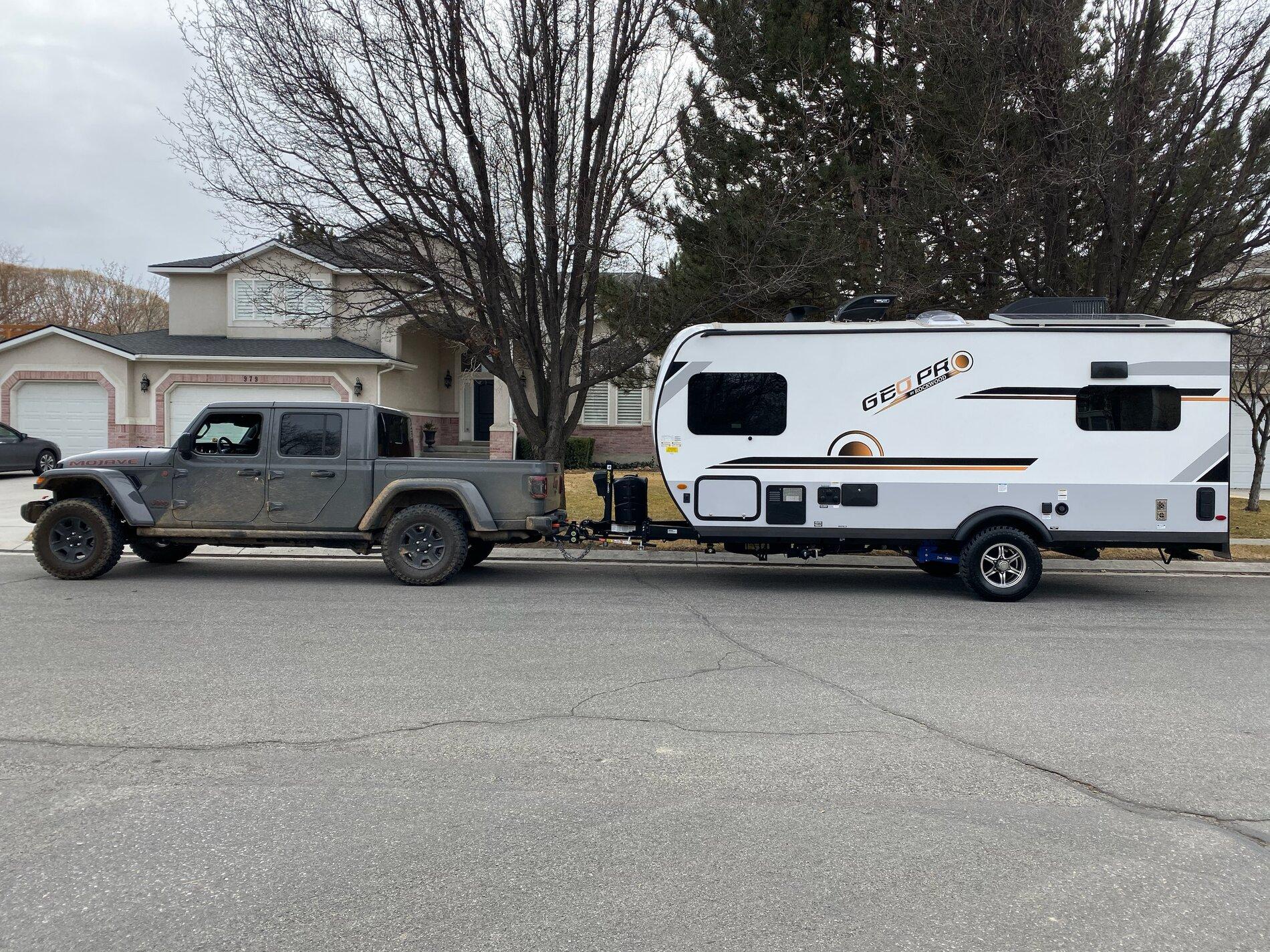

Ocotillo Boy
Dec 1, 2018
So Cal
2012 JK Rubicon, Jeep Gladiator Mojave
Machinery Mover, Rigger

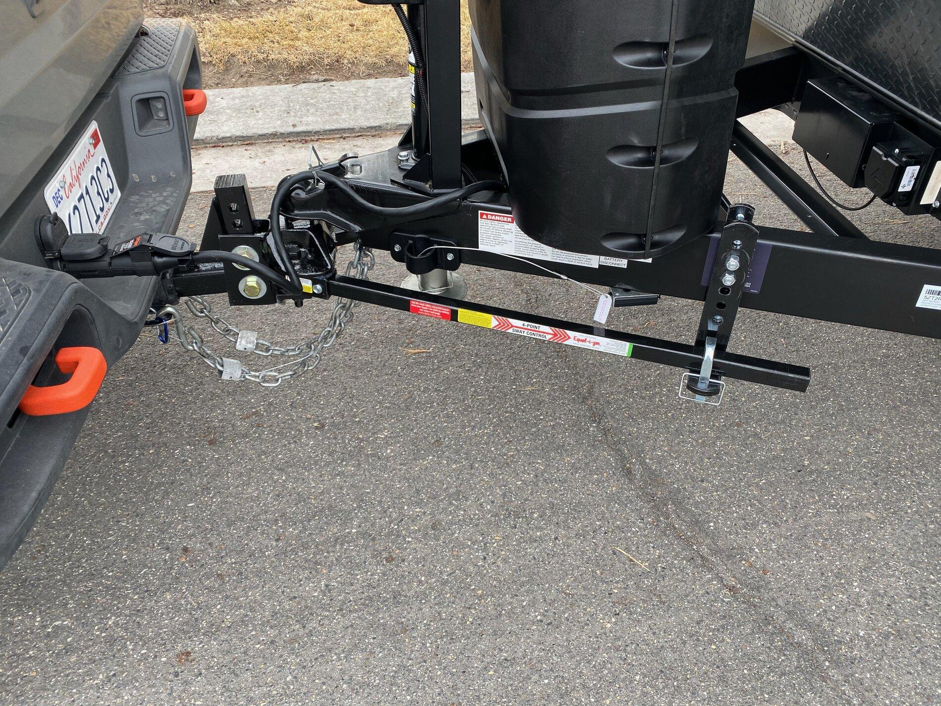

I just picked up my new Geo Pro 19FBTH front bedroom toy hauler yesterday! Just got home from a 624 mile ride home through heavy wind, snow, ice and rain!
I have the equalizer 4 point WDH. Very smooth ride with mine!
My Mojave did great! Suspension and handling wise. Burned a lot of gas though and did not like to hold a taller gear. Constantly had to do a manual up shift because it would just hold at very high RPM’s and not shift. It would just sit at 5K or higher forever if you let it. MPG’s sucked @ 8.9 average. Trailer weighs 3441lbs empty with 548lbs Tongue weight. 31 gallon water tank was full as well as the two propane tanks.
