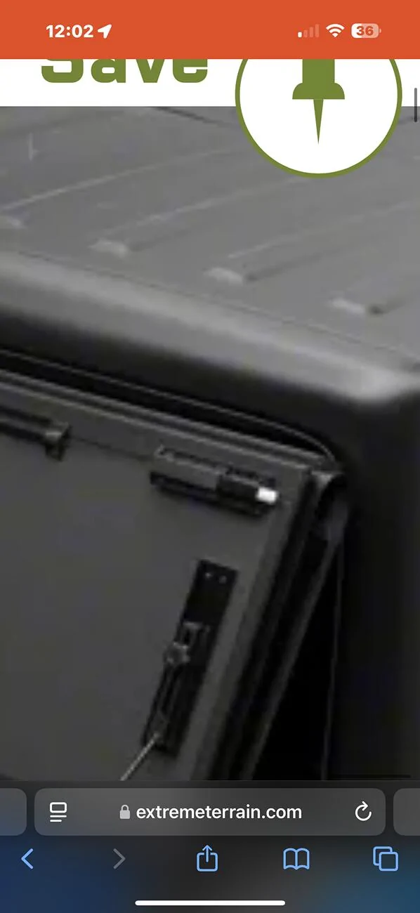

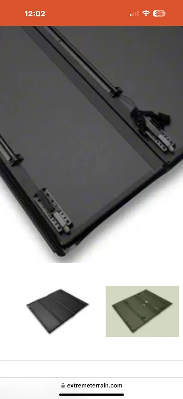

I have a Rough Country hard tri-fold cover. I think I could get into mine using a thin plastic putty knife to wedge up the trailing edge of the cover a bit and then fishing around with a bent wire coat hanger. You could always wrap the coat hanger in electrical tape if worried about scratches. But the RC cover has a much longer run of exposed cable on each side than yours, so mine would be less of a pinpoint operation. Mind you, I've not yet had to try this, so it is just a speculative suggestion.

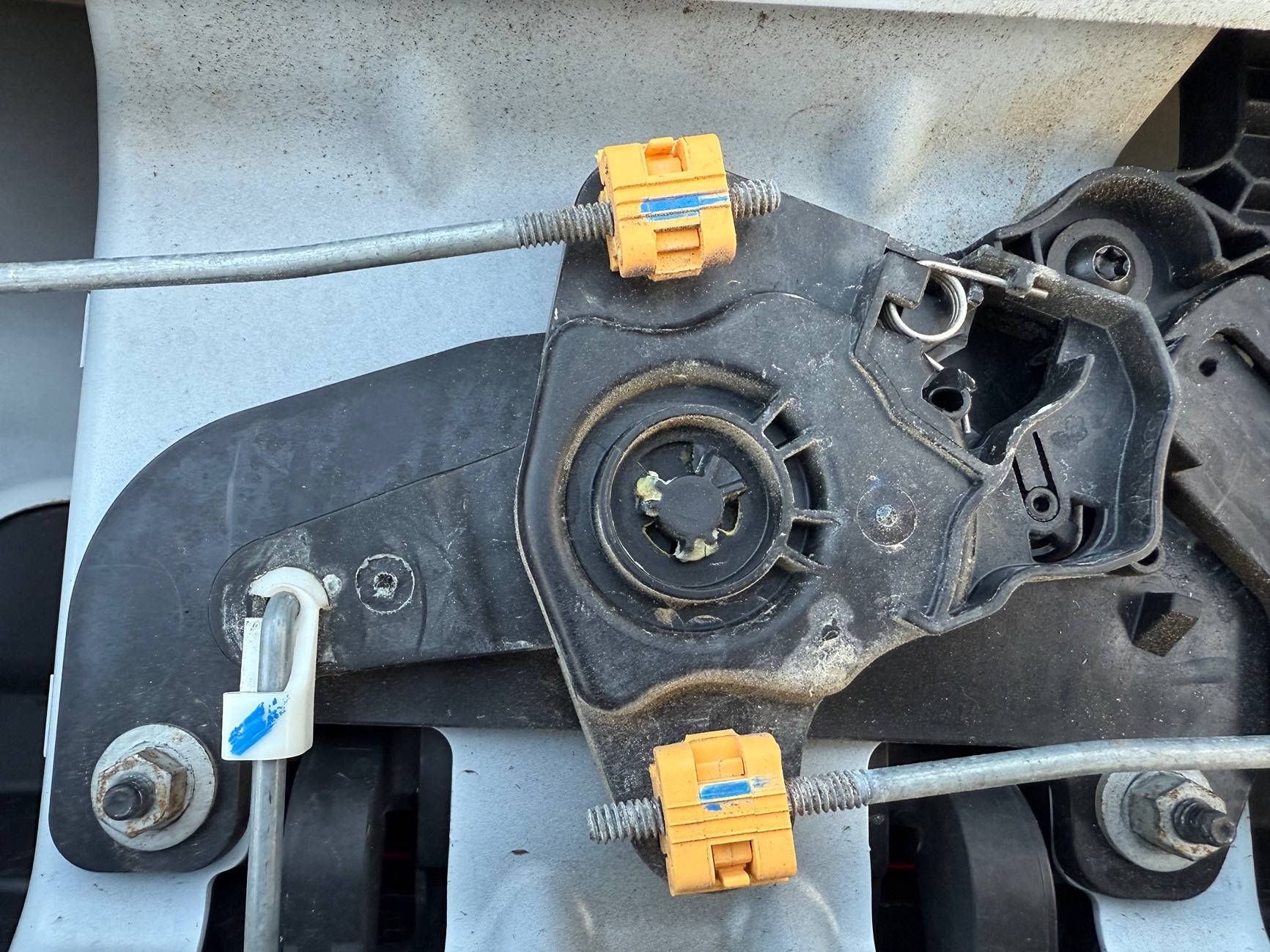

The rod that goes to the tailgate handle came undone from the white clip. I’m guessing this is only a guess cause I’m usually pretty thorough that the clip didn’t fully engage when I was tracking down the bad third brake light connection.. either way it’s reattached and working fine again thanks for the help.
