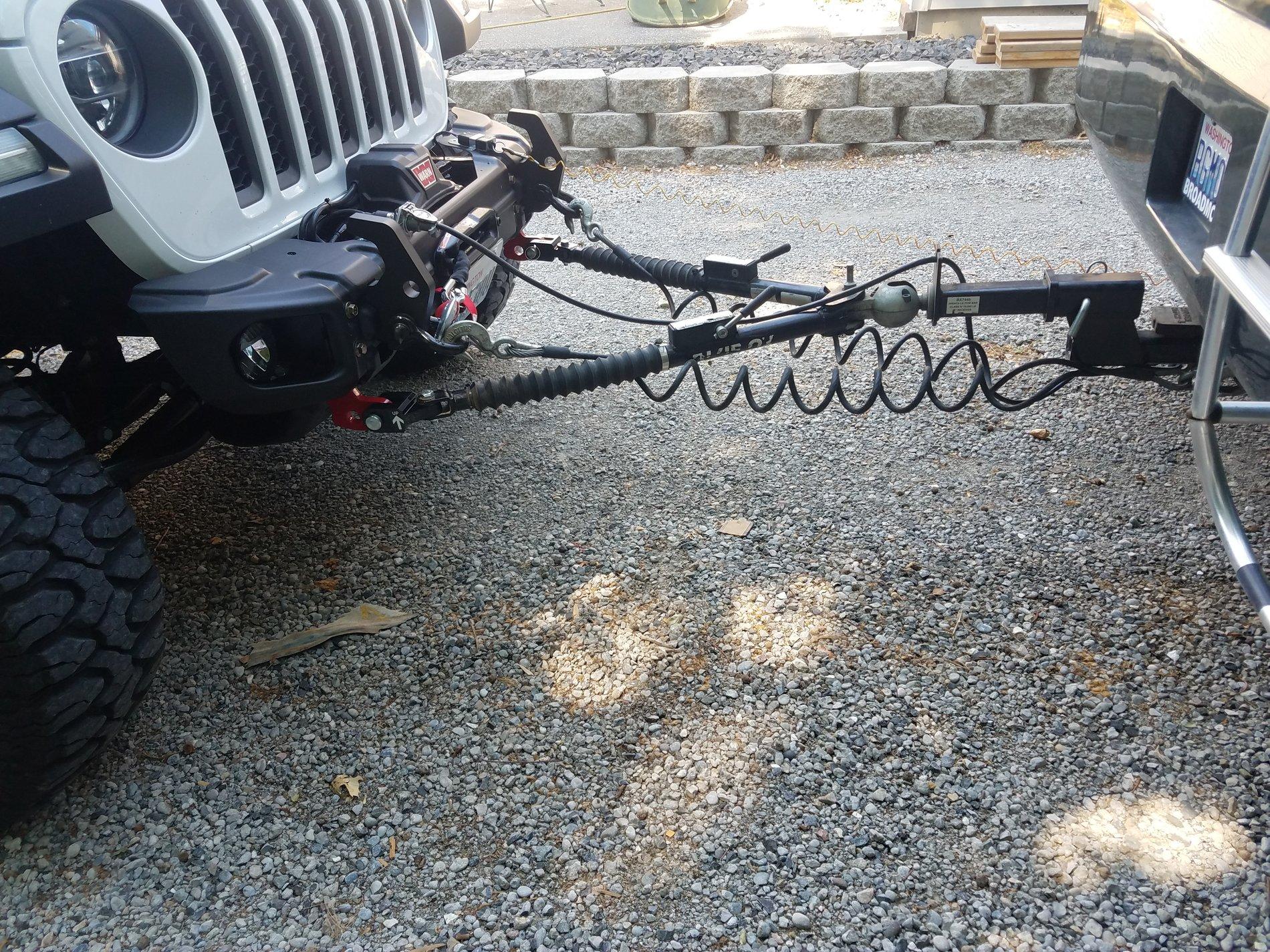

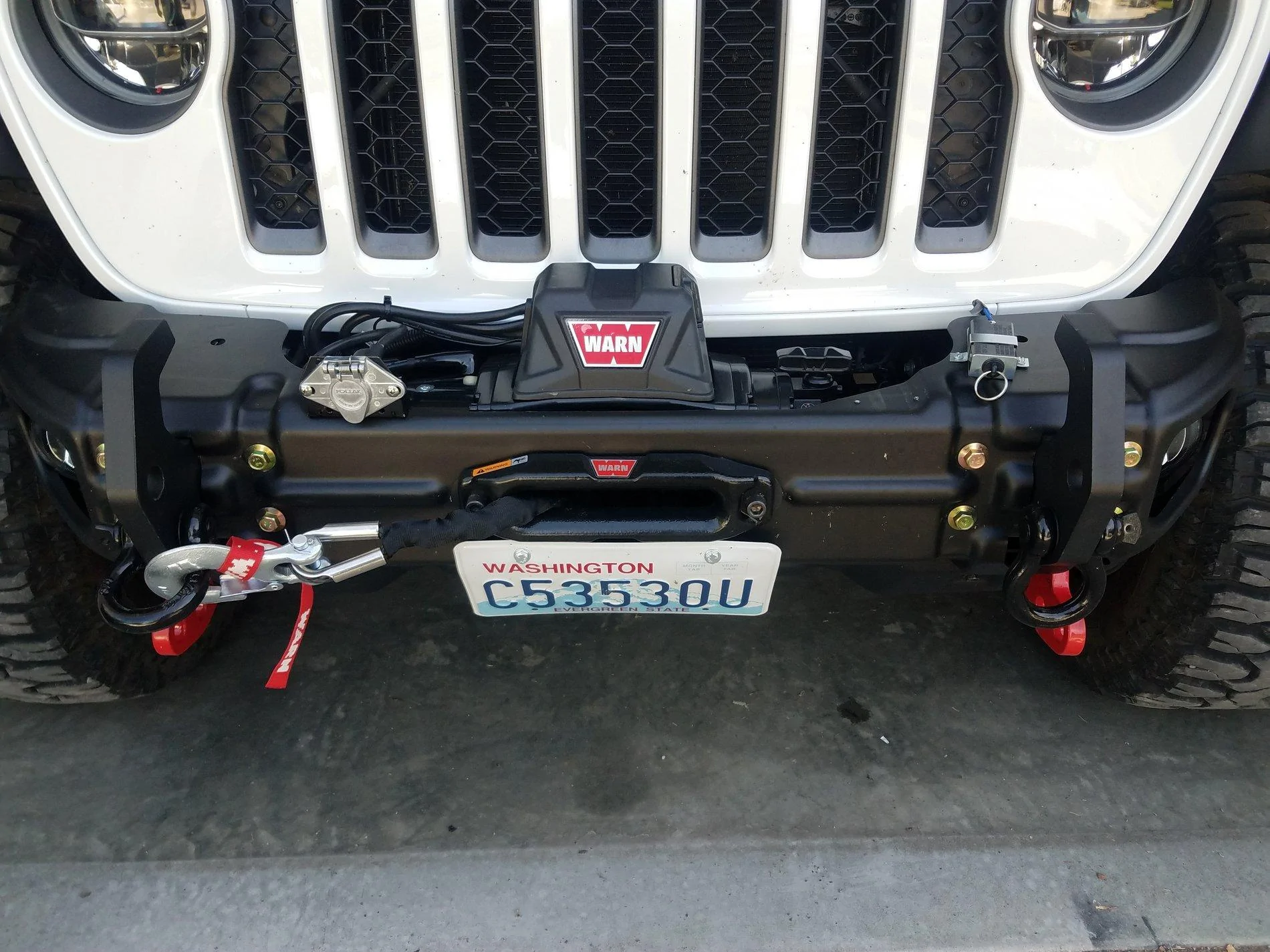

I have a RR Arcus bumper. I use the Maximus-3 tow bar mounts and Blue Ox shackle mount adapters for the ends of my tow bar.
With the added thickness of the Maximus brackets, the provided bolts of the Arcus bumper were not long enough. No problem, I replaced them with some grade 8 bolts.
The Maximus mounts are less expensive than other flat towing options, but not cheap for a one time move. Especially when you add in the cost of the adapters, tow bar, braking system, etc.

Hi TJ, I like your setup!
Did you have to cut your ARCOS bumper, and were you able to install without removing the bumper?
I take it you have no issue with clearance (pivoting up/down of the tow bar)?
I did have to cut a little bit of clearance to the outer shell of the bumper. I just followed the directions/measurements that were provided for the stock bumper.
No up/down clearance issues with the Arcus bumpers.
Two camping seasons down with this combo. Can't wait for spring already.
