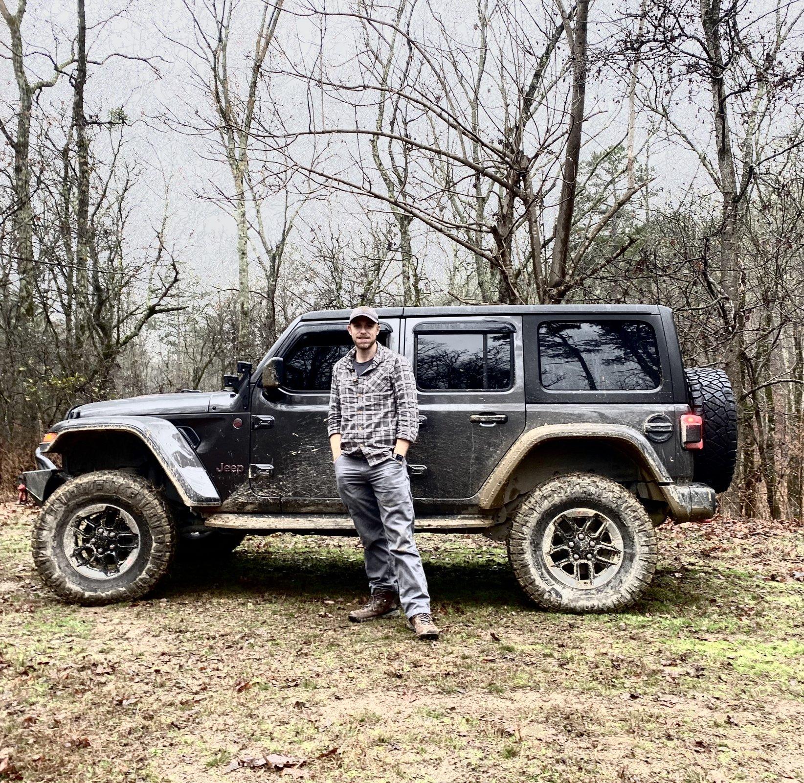

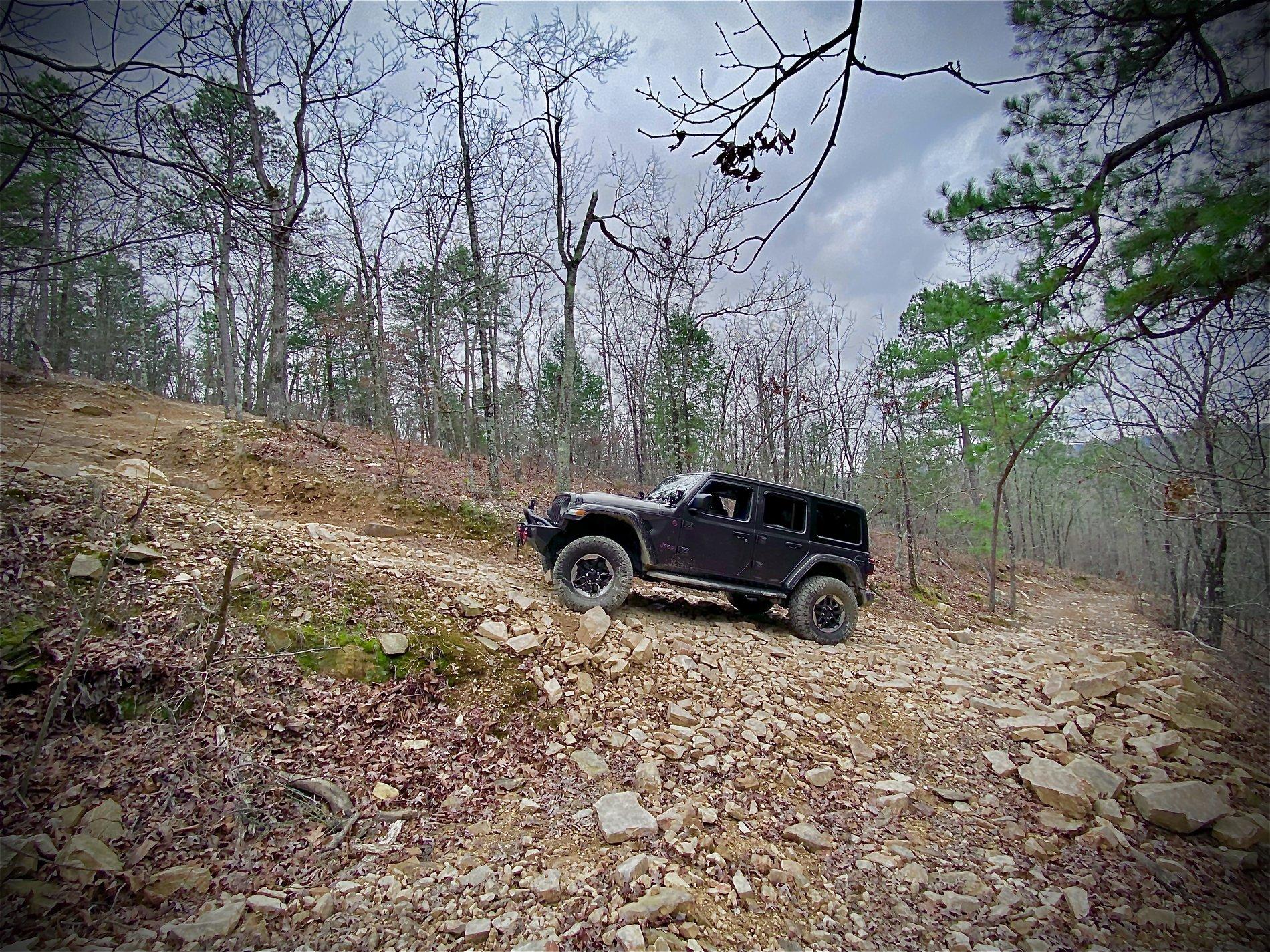

Has anyone had any experience flat towing a JL (or any other wrangler) behind their Gladiator? If so, what types of setups are you using?
I have a small Class A that I will be flat towing my JLUR with, but I am really intrigued by the potential of a Sport S w/ Max tow as my daily so I can continue my JLUR build and have a super functional small truck.
Thanks in advance and apologies for the JL pics! ā€ā™‚
