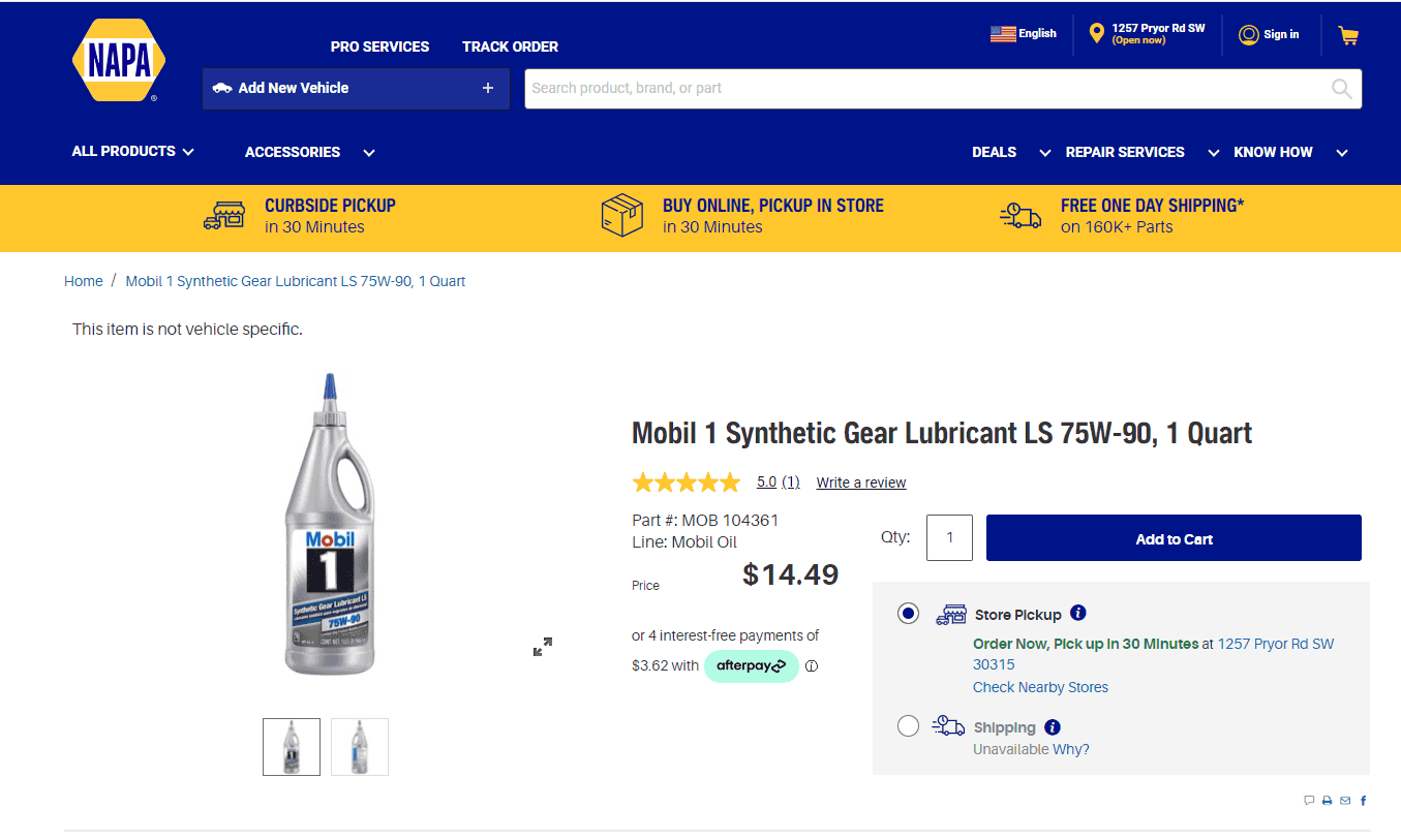

And why no syn? Is the factory LSD clutch based? Need a torsen based unit in there
mrmo
Mrmo
Jan 26, 2021
50
809
496
East Tn
2022 Gladiator
nuke
Syn gear oil designed for LSD (limited slip)....I have used this in clutch type differentials before with no issues
