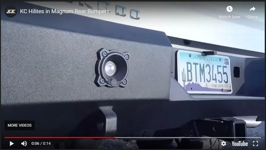

Innovative Creations Inc (ICI) has Magnum Series Rear Bumpers that feature KC Hilites however I don't see that KC sells them separately. I really want a set to retro fit into my stock JT bumper but can't seem to find them anywhere. Here are the specs -
LZR Flush Mount LED by KC HiLITES (In tandem with ICI)
Light Specs:
• 65MM/ 2.5" Flush Mount Flood
• Single Bulb 10W/900 Lumen Cree LED
• Aluminum Faceplate and Housing
• 40 Degree Optic (works flawlessly with OE cameras and sensors)
• KC Branded and Backed
• 23 Year Warranty

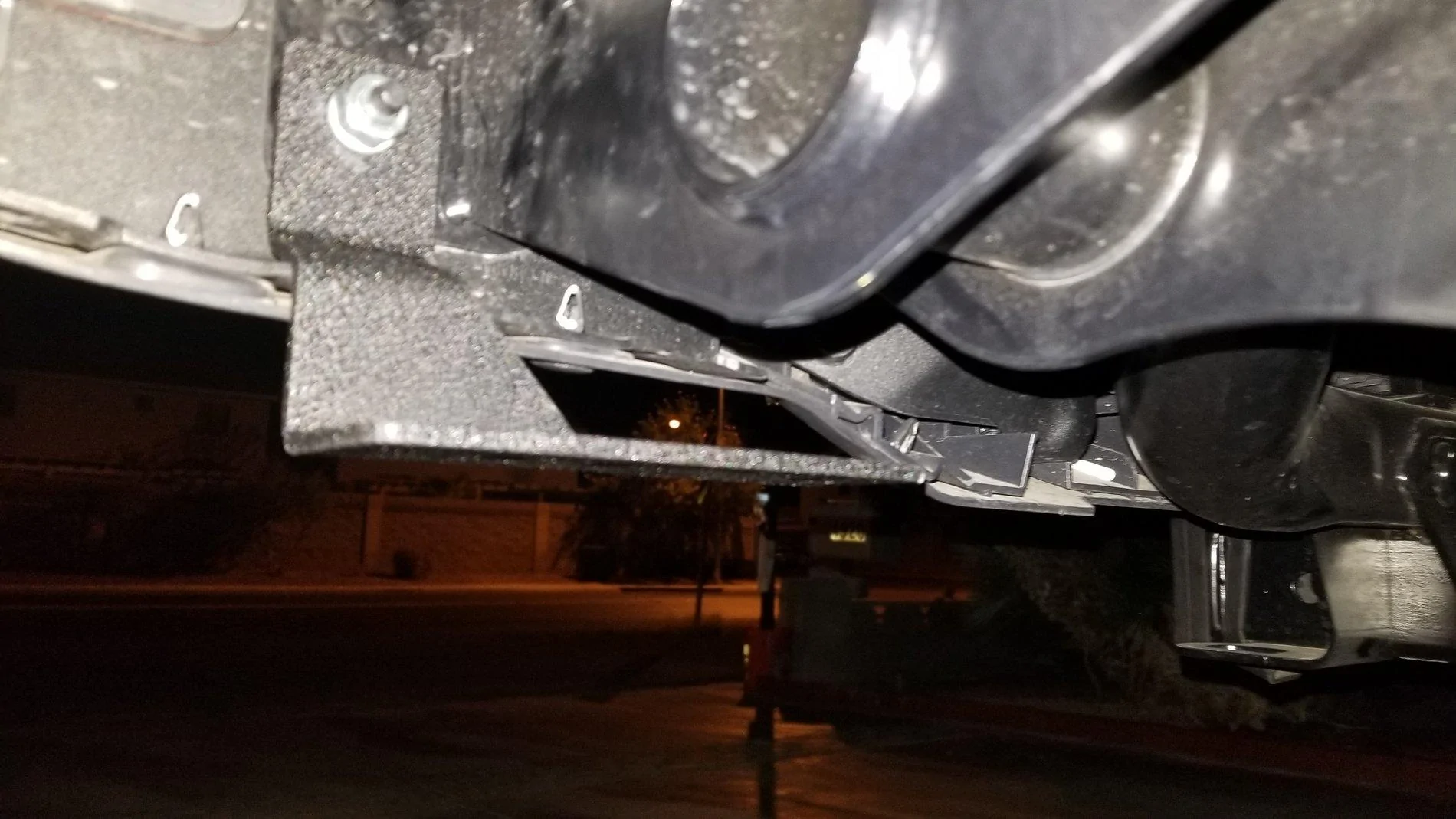

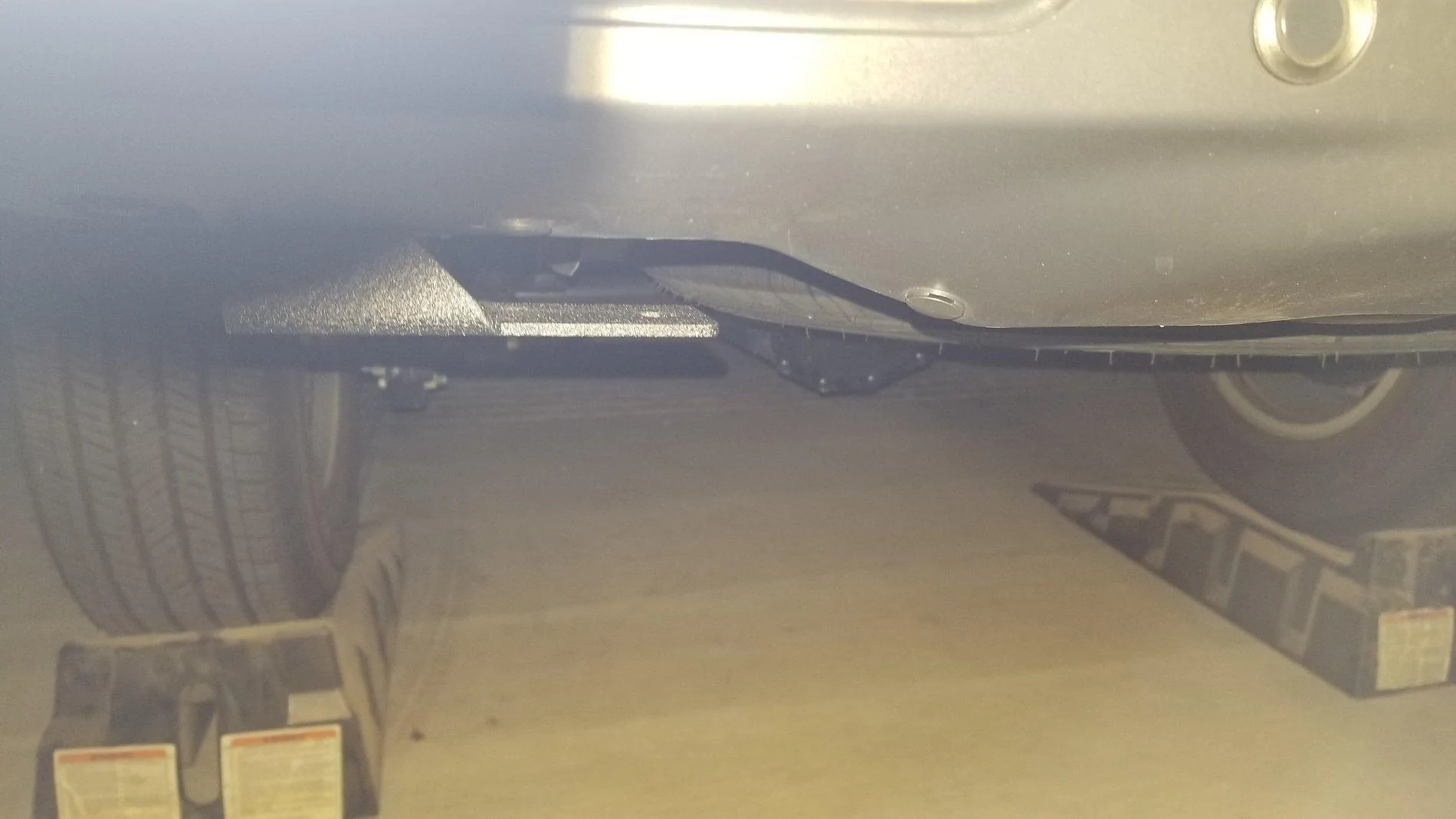

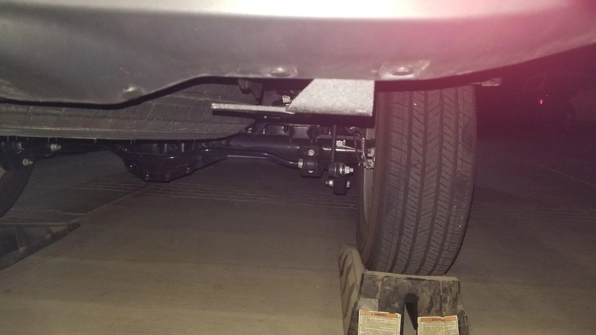

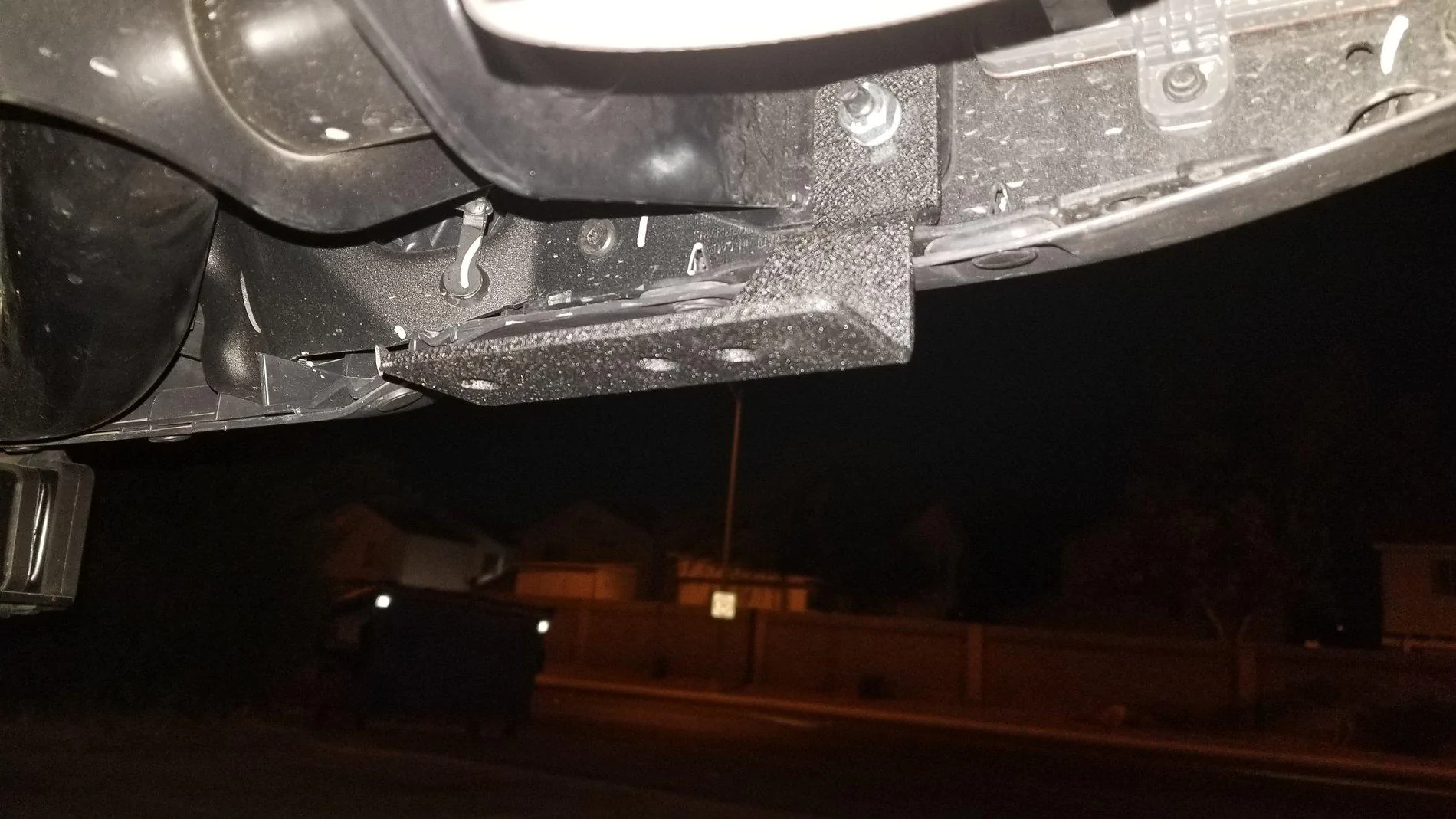

I’m thinking about surface mounting a set of the KC C series 519 floods where the bumper reflectors are. They’re small enough to fit in there and seem to put out a plenty of light from the pictures I’ve seen.
https://www.kchilites.com/2-c-series-c2-led-backup-flood-light-system-519.html
Product Dimensions: W - 2.85" x H - 2.21/1.91" x D - 2.17"
The red reflector is a removable panel. It's held in from the back with three screws.
I bought a set of the KC Backup Lights to mount in the rear. I found them on Amazon for $145. I went with some EAG Bumper mounts for $26. They fit great and go on easy. I just used a split washer and M10 nut to attach them to the lower bumper bolt. They hang down about an inch, and have three holes in them for attaching items.
EAG 20W 2x2 LED Pod Light with... https://www.amazon.com/dp/B07QRF8WDR?ref=ppx_pop_mob_ap_share
The description is a little misleading, but they clarify further down that it's only the brackets that are shipped.

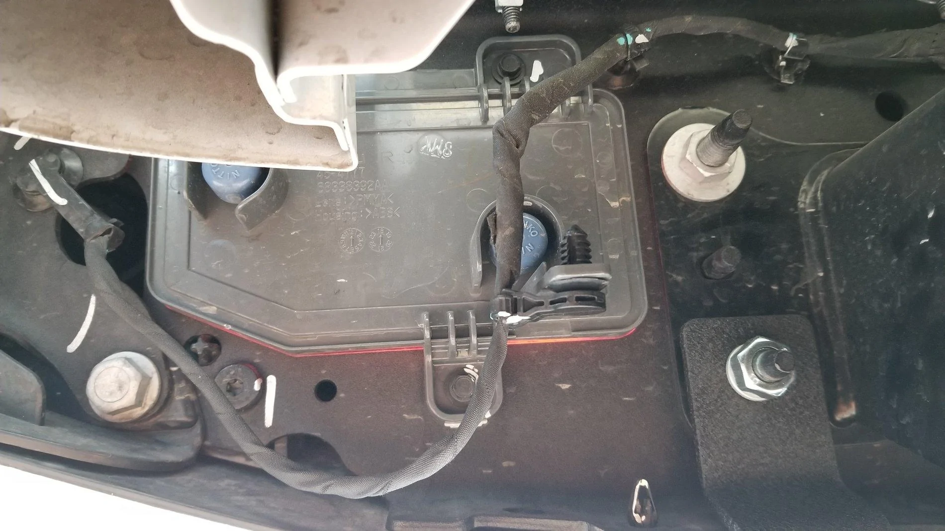

Here's a picture of the reflector from the back. There's just three small bolts holding it on. It has a hanger on the back that holds some of the wiring.

cool, @Troybilt has a plan to make a bracket to attach a light to those mounting holes. This looks very do-able.
