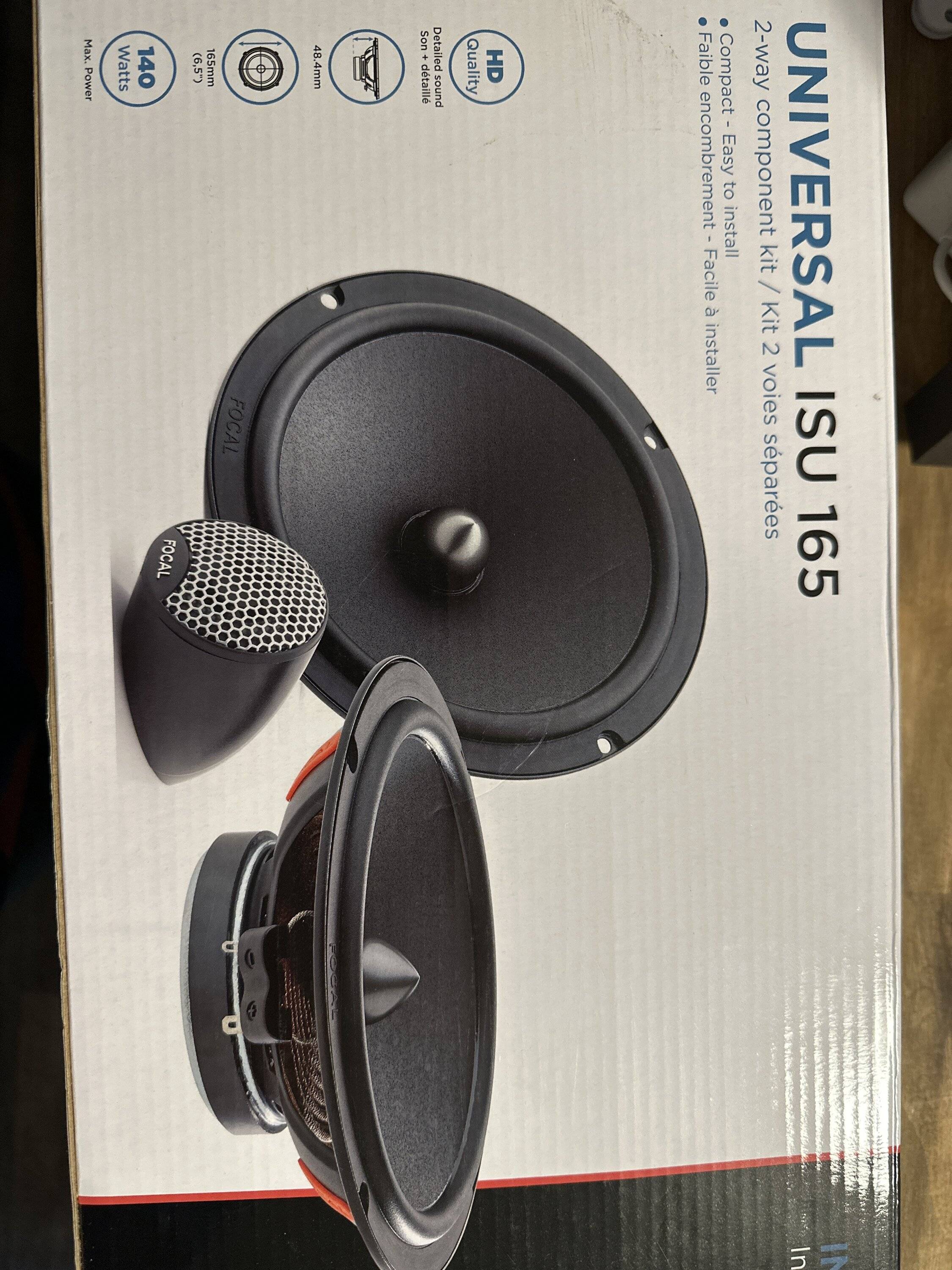

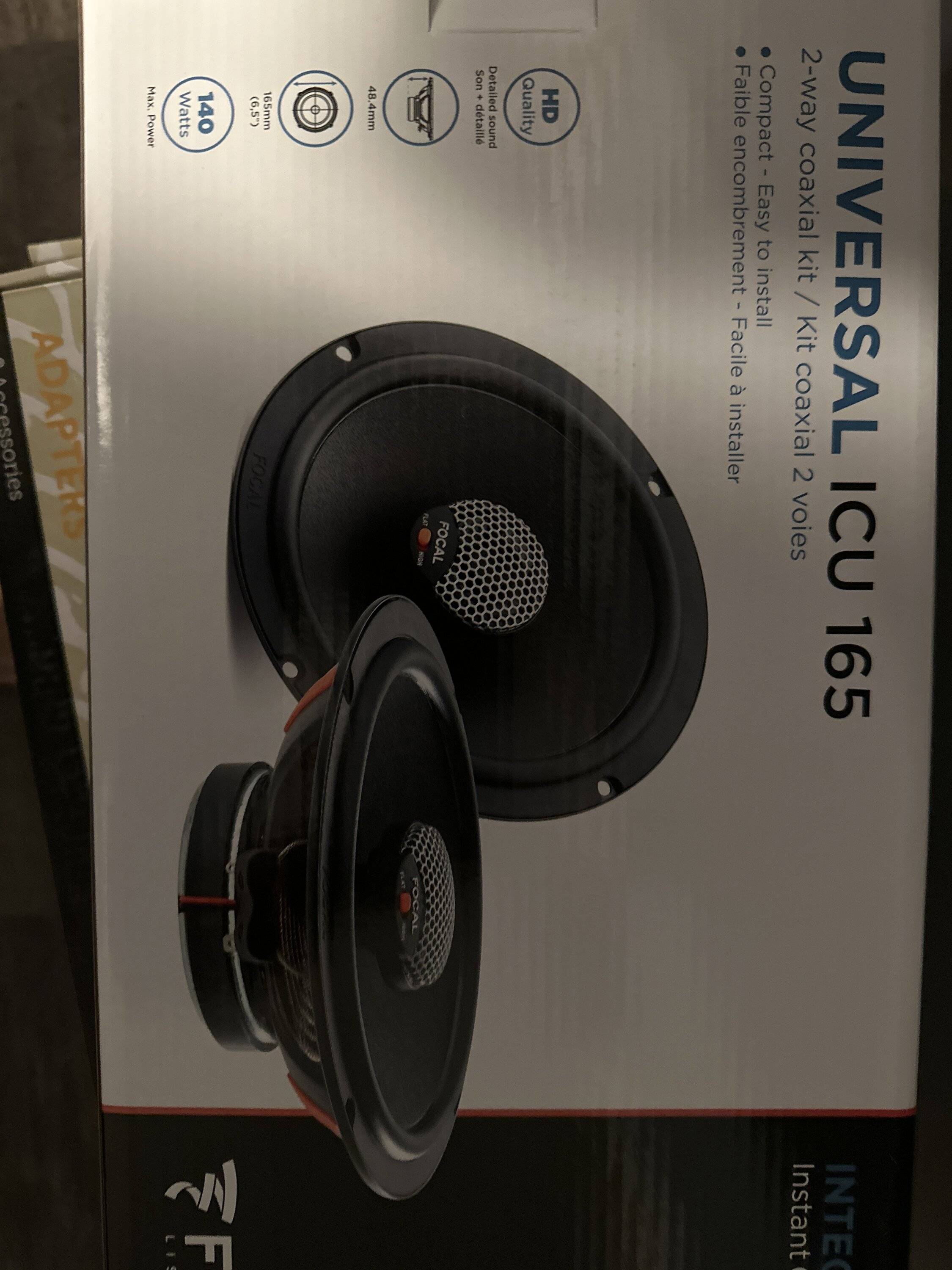

Hey all, time to upgrade the premium sound system speakers. Got a few shops advice and landed on the Focal ISU 165’s and the ICU 165’s with some Metra adapters for the larger speakers.
anyone run these yet and what were the thoughts? For now I’m gonna plug and play and maybe go amp in the future but I wanted to do something now to improve quality without spending 3k.
