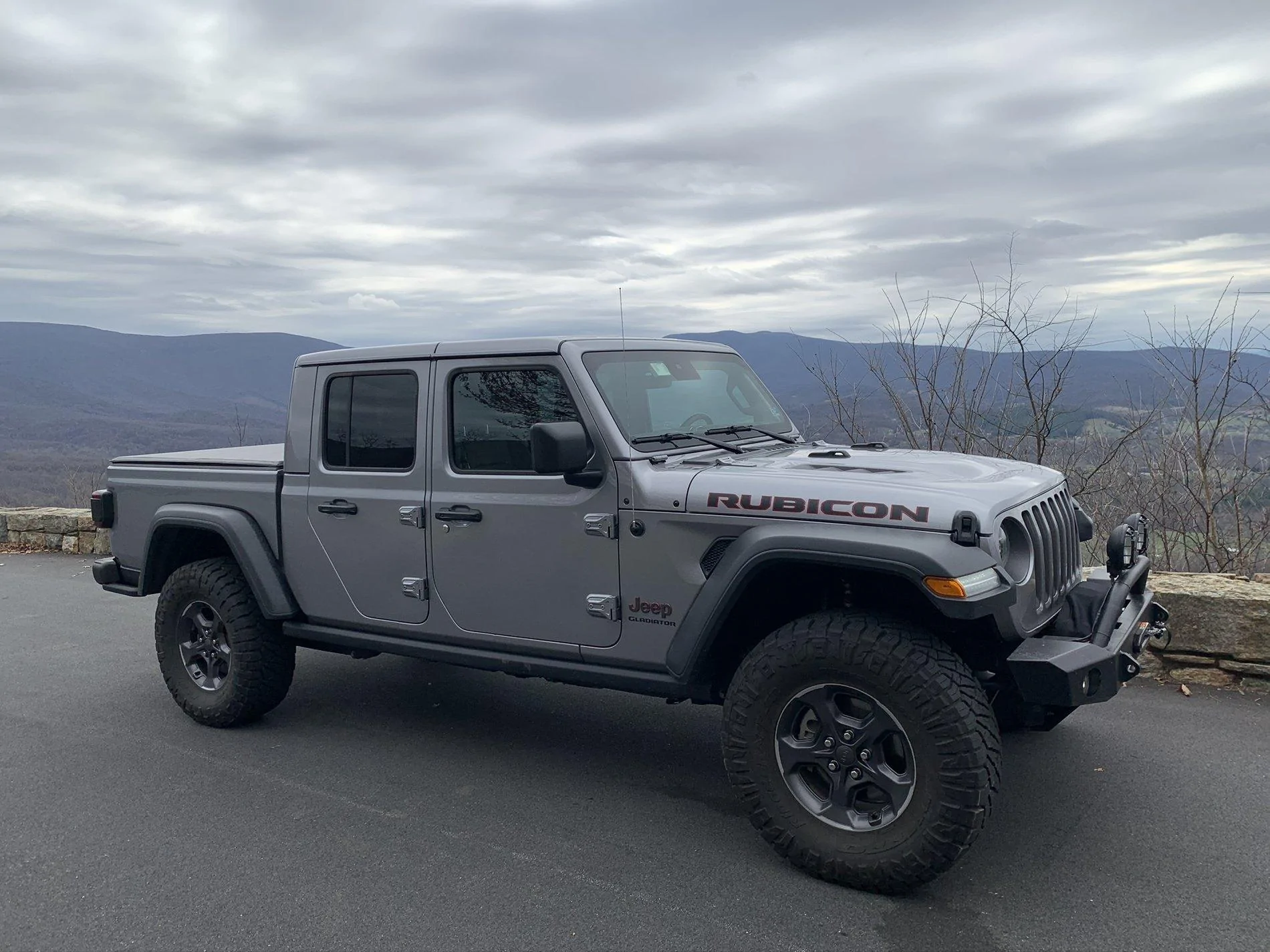

Custom 2” lift with Synergy front 2” lift coils and 3/4” daystar rear spacers. Easy way to give a much higher stance and fit 35s under a non rubicon or 37s under a Rubicon. I am going bigger so need a complete lift. This setup is simple and helps significantly with the weight of a front bumper and winch. Asking $150 plus shipping. Picture shows lift installed with 35” Nitto Ridge Grapplers on my Rubicon. The Jeep sits almost level with the rear about 1/2” higher than the front. I will also include the front daystar 3/4” spacers as well.

Anyone looking for a cheap leveling kit with a great set of front springs?

Couple questions: Did you measure how much lift the springs gave you? Did you notice any difference in ride quality? what did you do about shocks when you went to these springs?

Yes I did measure but then lost a bit with the bumper and winch. I would estimate I ended up about 2” on the nose after the bumper and winch but was closer to 2.5” before. Rear is exactly 3/4” up as it’s a spacer. Shocks are stock no changes. I was planning to add a 2” extension at some point but with this setup I took it to Rausch creek and it did great and didn’t rub it over extend shocks running 35s. Ride quality is great and feels stock maybe slightly better as the front coils are better quality over stock.

This is just 2” lift springs front and 3/4” spacer rear. No arms needed with such a small lift. It makes the Jeep about level with the rear still sitting about 1/2” higher than the front. Great stance for my 35s. I also have the stock rubicon springs for the rear if you want them.

Yes, I am including more than originally posted to include:
Synergy 2" lift springs front
Stock Rubicon JT rear springs with 3/4" Daystar spacers
Longer front swaybar linkages
Extra parts I will throw in but likely won't need - 3/4" front Daystar spacers, front Rubicon springs
Overall this gave the Jeep a decent boost that is a bit taller than a standard leveling kit. It easily ran 35s and would allow space for 35s under a non Rubicon too. Multiple vendors are selling this same setup as a 2" lift. The vendors selling this don't typically include or require taller shocks. They could be helpful but I wheeled my JT like this at Rausch Creek on moderate trails without issue.
