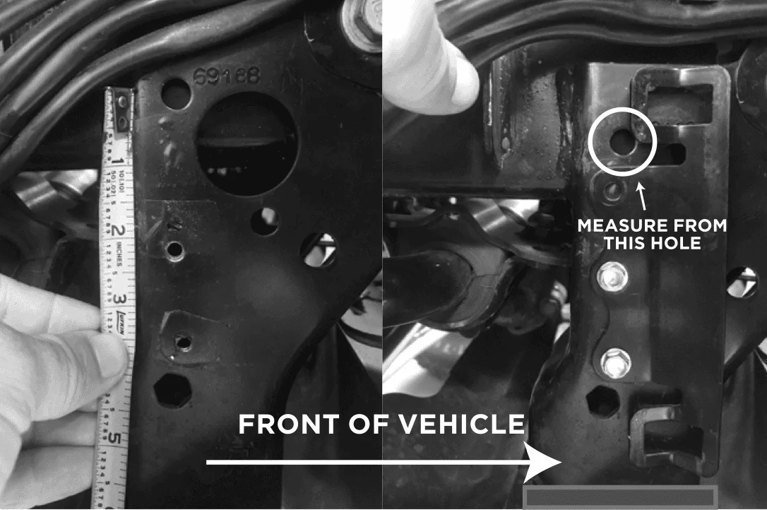

This might better illustrate the question.
From the Fox website
Jeep Gladiator Fox 2.5 Remote Reservoir shock install Fab Fours stubby bumper Screen Shot 2022-01-25 at 4.47.46 PM
My Bumper and the same mounting location

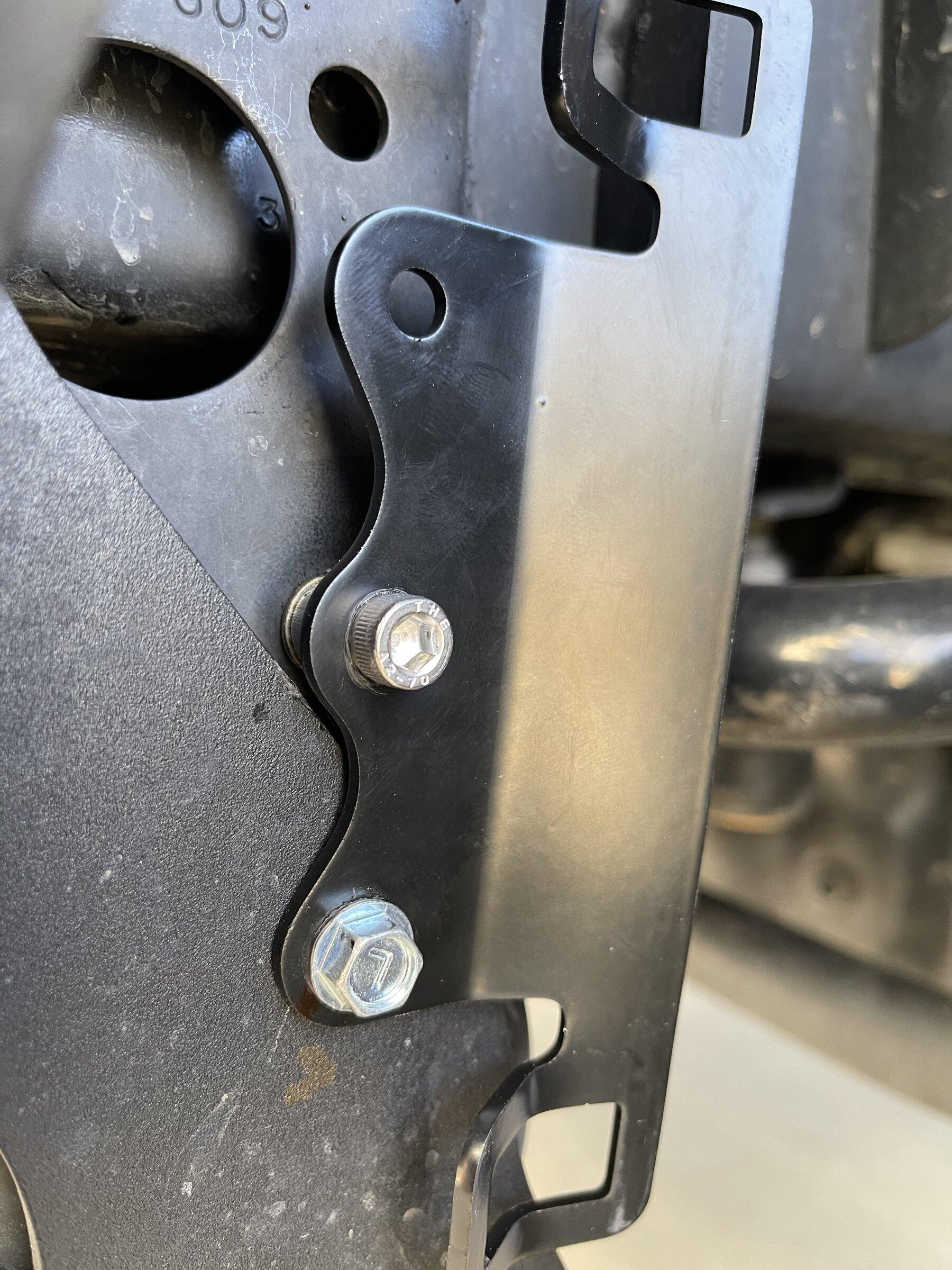

I ended up tapping the fram for some M6 bolts and then using aluminum spacers. Thinking about making a guard for them, but have not done that yet.

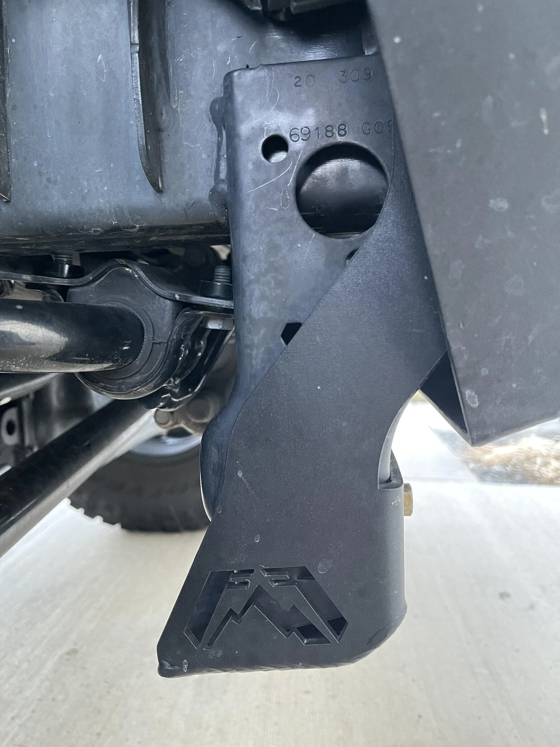

I ended up drilling through the plating of the lower protector and then the frame. I used the self threading screw on this hole. On the middle hole I used a rivet nut insert and a spacer and M6 stainless bolt.
