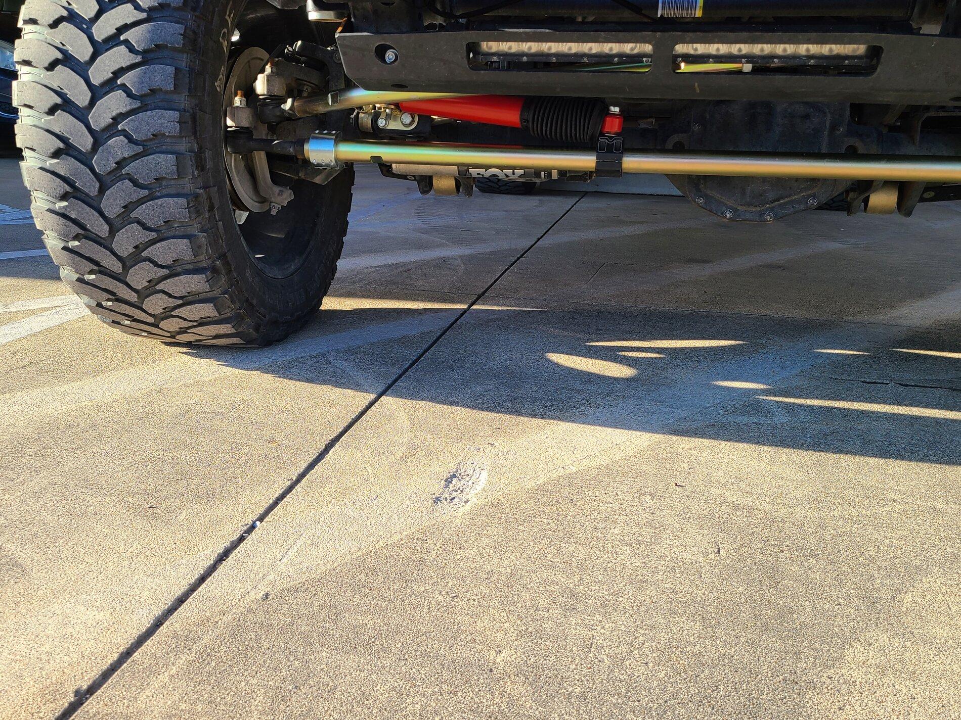

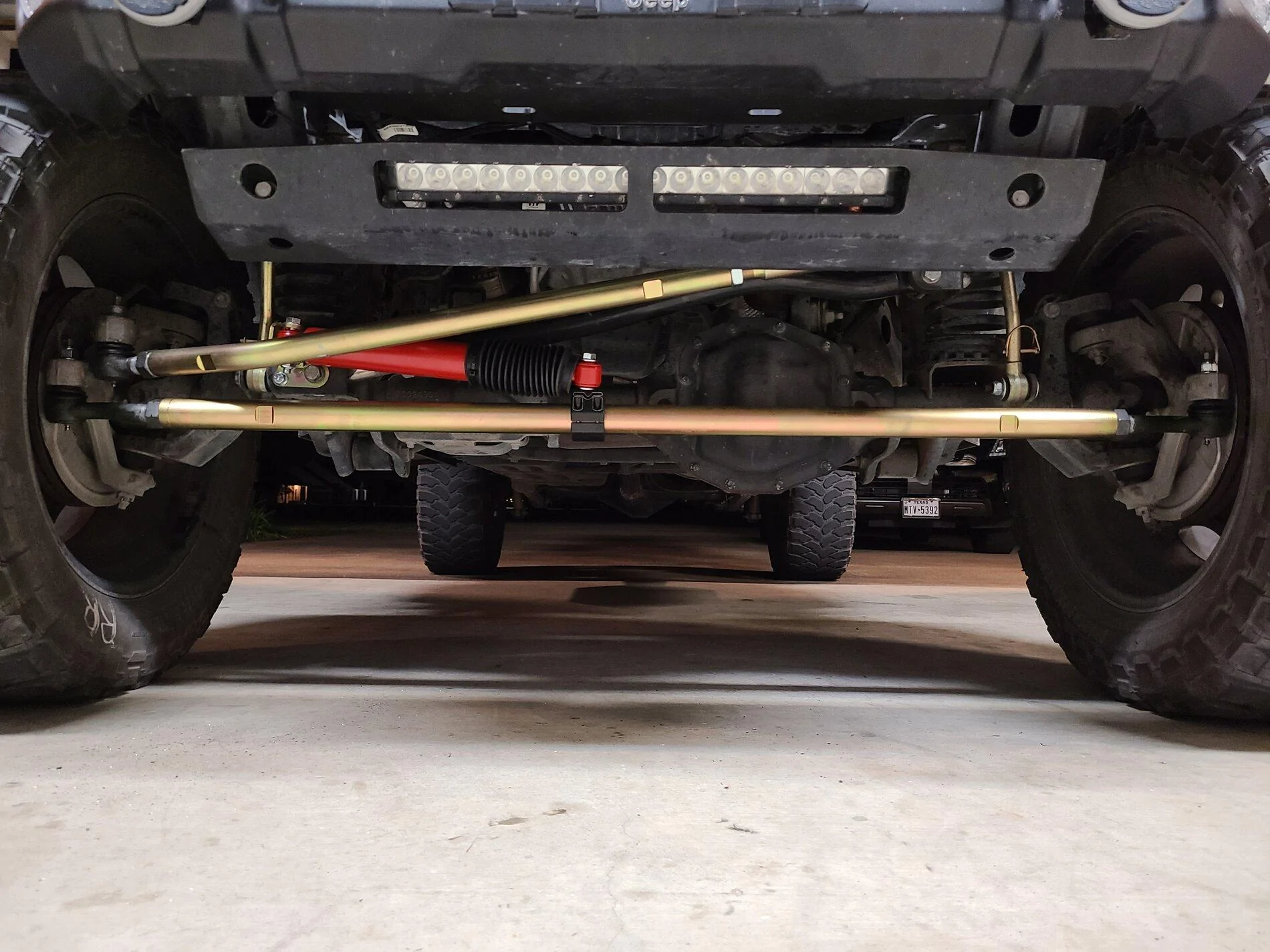

I had a bad steering box and the Skyjacker lift I had installed did not provide enough caster with its control arms. My steering was terrible and had occasional/intermittent DW that was progressively getting worse due to my tires wearing poorly. I started with upgrading the stabilizer to the Fox TS, then added the Synergy brace before eventually upgrading the entire steering. The stabilizer and Synergy brace pretty much eliminated the steering wander and 10-2 dead spot but the DW only stopped after I added the adjustable FCA's and ran my caster way out. This is a pic with both stabilizers that I currently run with.
