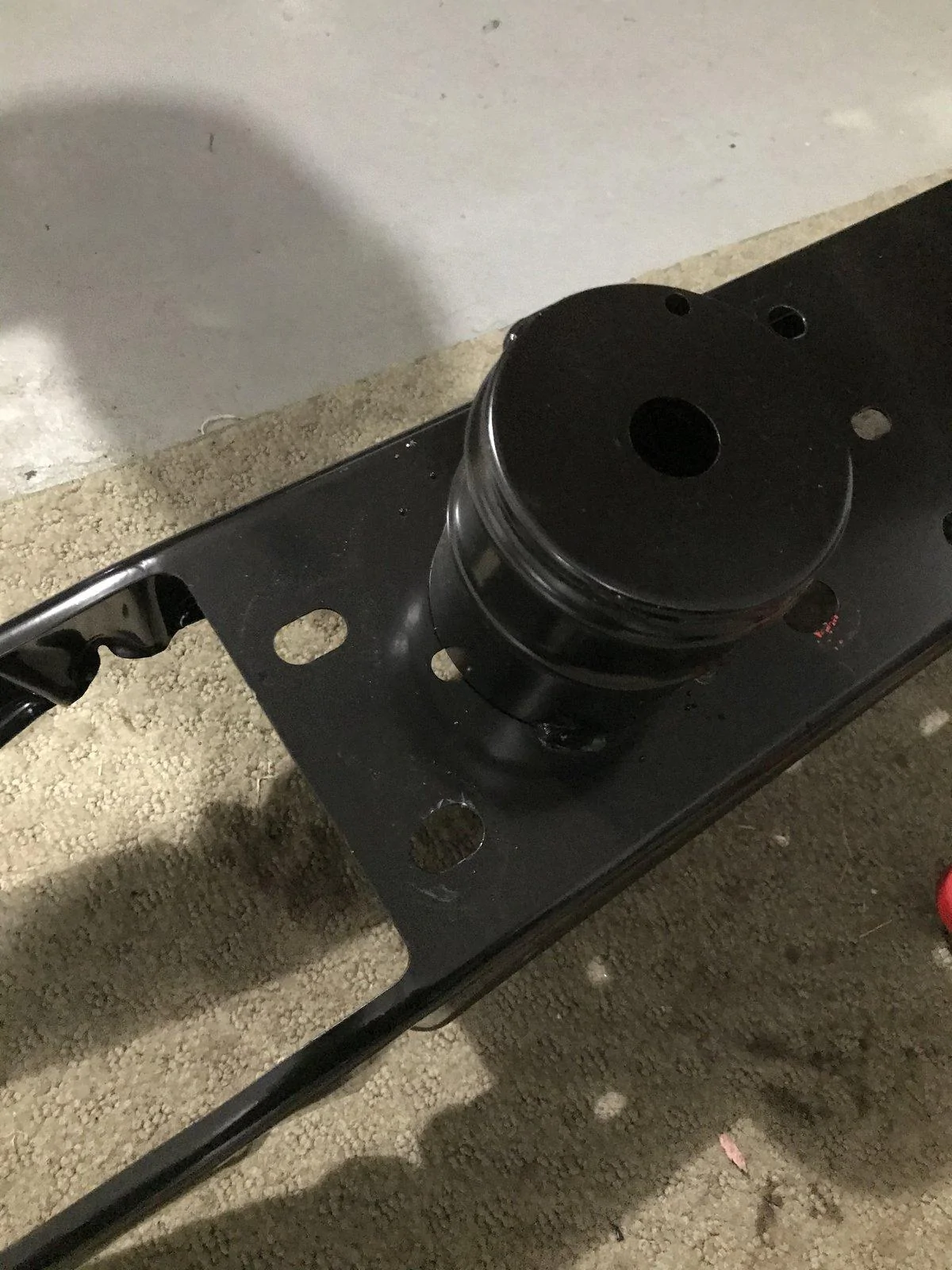

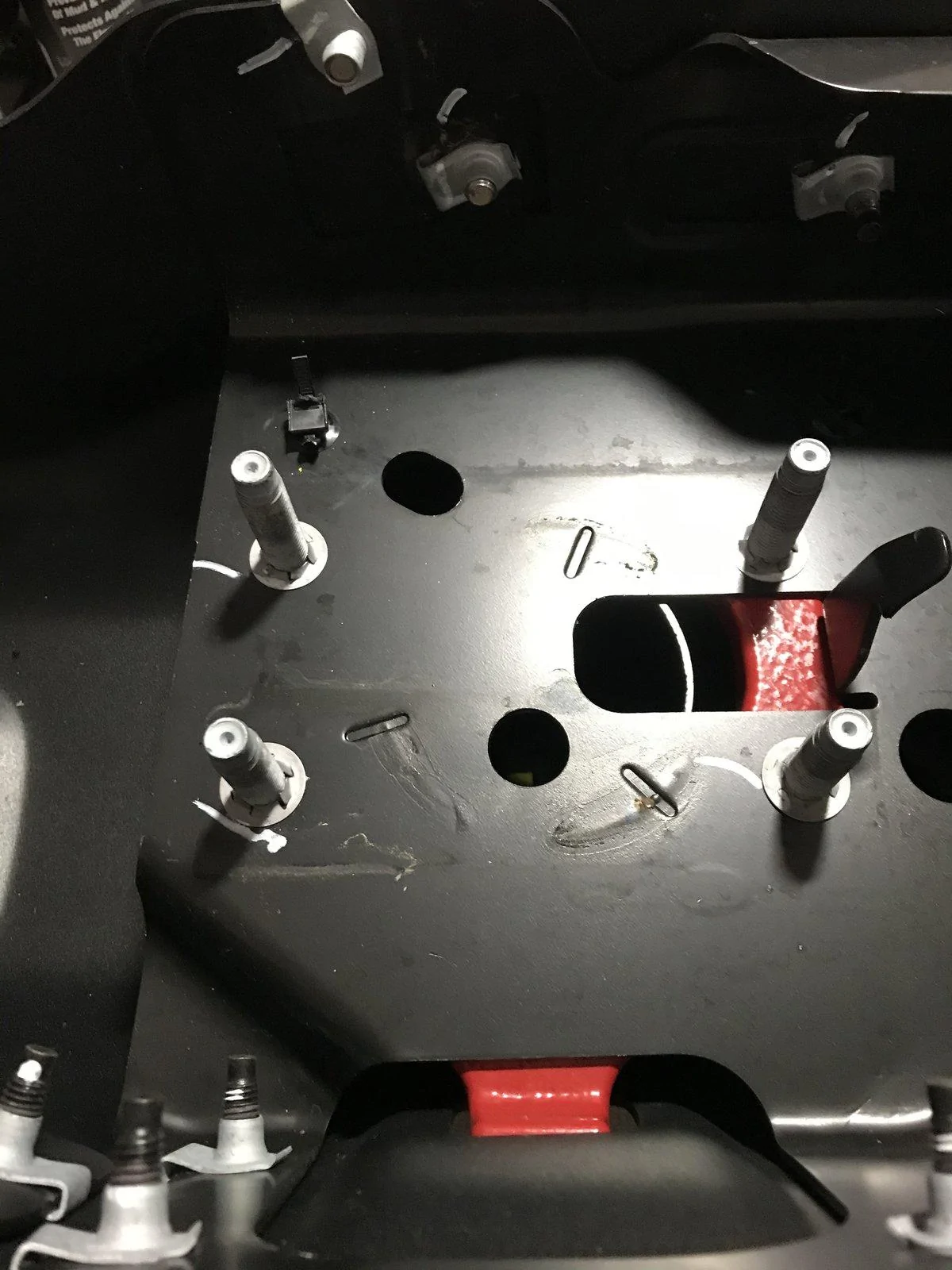

second, Should there be cylindrical crush bumpers (excuse my lack of a better term) that fit between the red tow hooks? The plastic bumper has a metal inlay that has two cylindrical metal pieces that lay in the middle of the mounting studs. And on the steel bumper, there appears to be round rub marks where these cylinder crush bumper should go. A parts diagram or microfiche of the steel bumper group would be incredibly helpful, but I don’t think one exists.
This is hard for me to explain, so thank you to those who bared with me. I’ll attach pictures of the rub marks and the cylinders I’m talking about. I think the steel bumper group has the cylinders mounted to the frame but I’m unsure.

Figured it out. The crush cans I’m talking about are housed within the steel bumper, behind the plastic covers.
