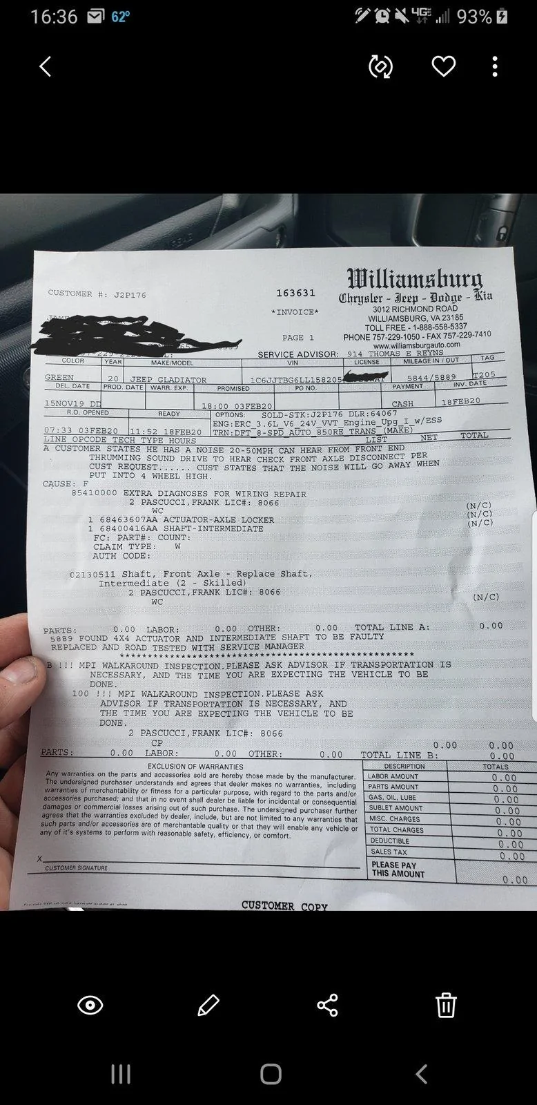

If you hear a thrumming noise from your front end that goes away when you shift from 2Hi to 4Hi, take it to the dealer. I'm told there's a TSB now. Here's the worksheet.

Oh god please let this actually get my truck fixed, it's pretty clear there's a common issue and boy have I gone through hell trying to have this resolved

I was told that a bushing was the problem. An upgraded bushing taking over 1 week from Michigan is being shipped to my local dealership. I see this as a stop gap before moving on to one piece axle shafts and a FAD delete kit and truss.

This just started happening with my truck last week. I took it in to my local dealership this morning and just got a call this evening that there is indeed excessive play in the FAD intermediate shaft and parts have been ordered. ETA is about a week or so. FYI my service department and the tech that rode with me have been great so far.
Also..
Because Iā€™m always the driver and never the passenger all I noticed was the noise like described before, but the tech said he could feel the vibration with the sound in the passenger footwell. Hope this helps someone. To me it sounds like the noise a spun bearing makes..
Iā€™ll update you all when it gets repaired

There is an actual TSB for this issue. The service manager and my tech showed it to me after I gently persuaded them to check for it. . They took mine apart to check for free play then went to one on the lot to check how it should be.. They said yep itā€™s faulty and ordered up the parts.

My dealer just ordered parts for an intermediate shaft according to a TSB that came out recently. Does this sound right to anyone? They'll have the parts in 3-4 days so hopefully I'll have her back by the end of the week.
