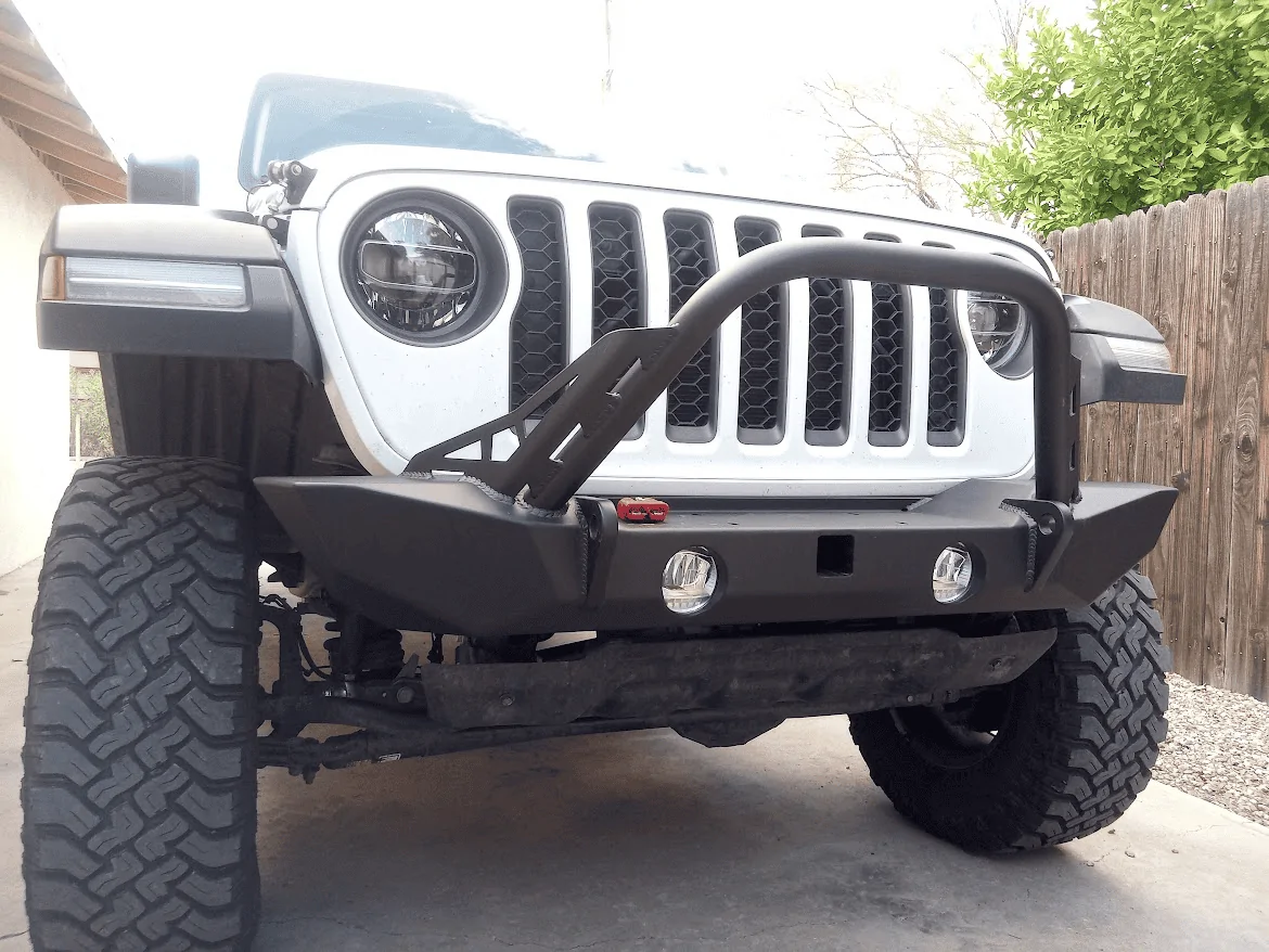

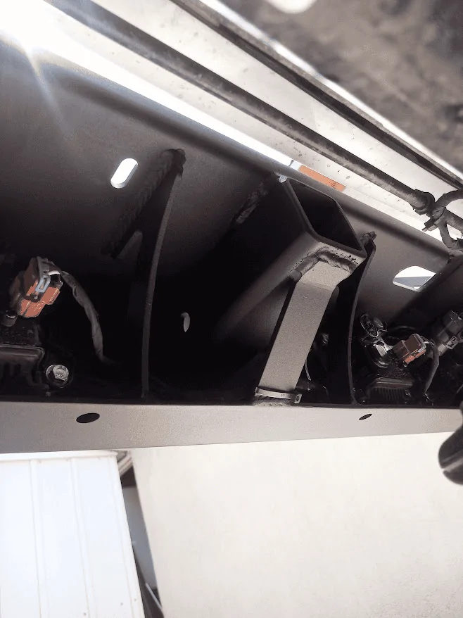

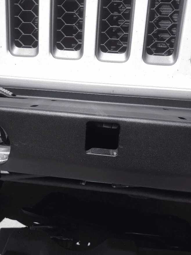

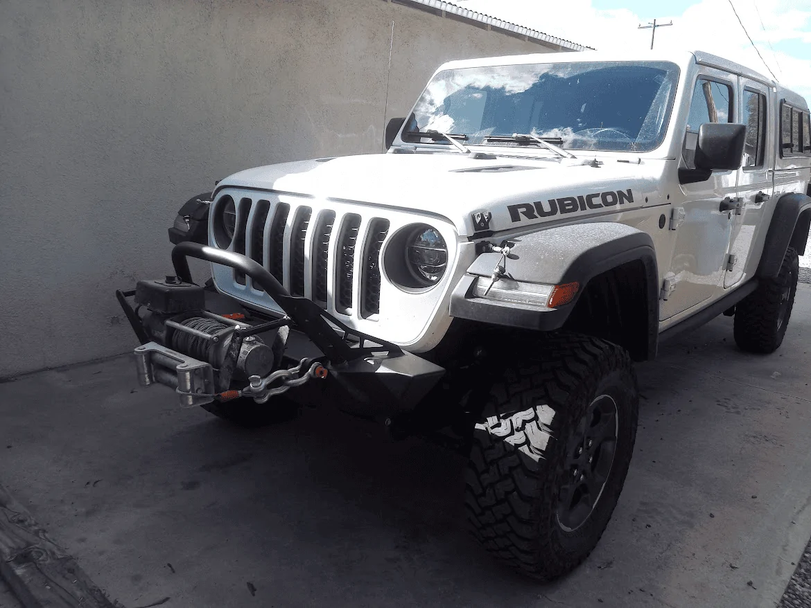

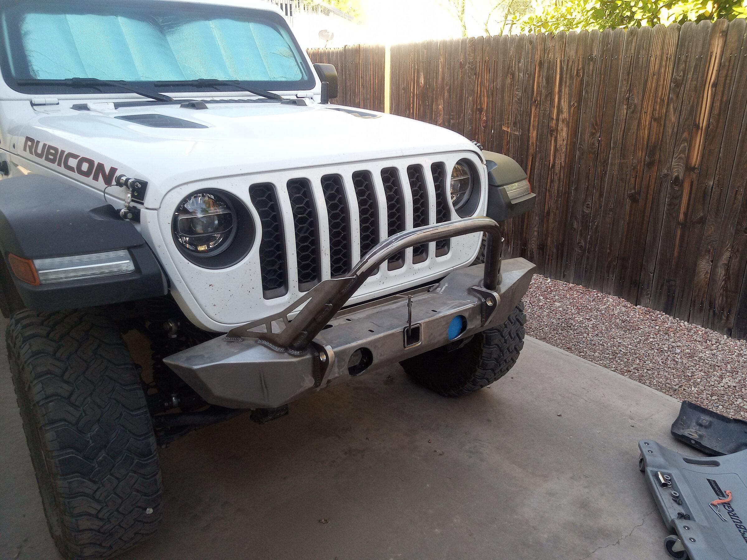

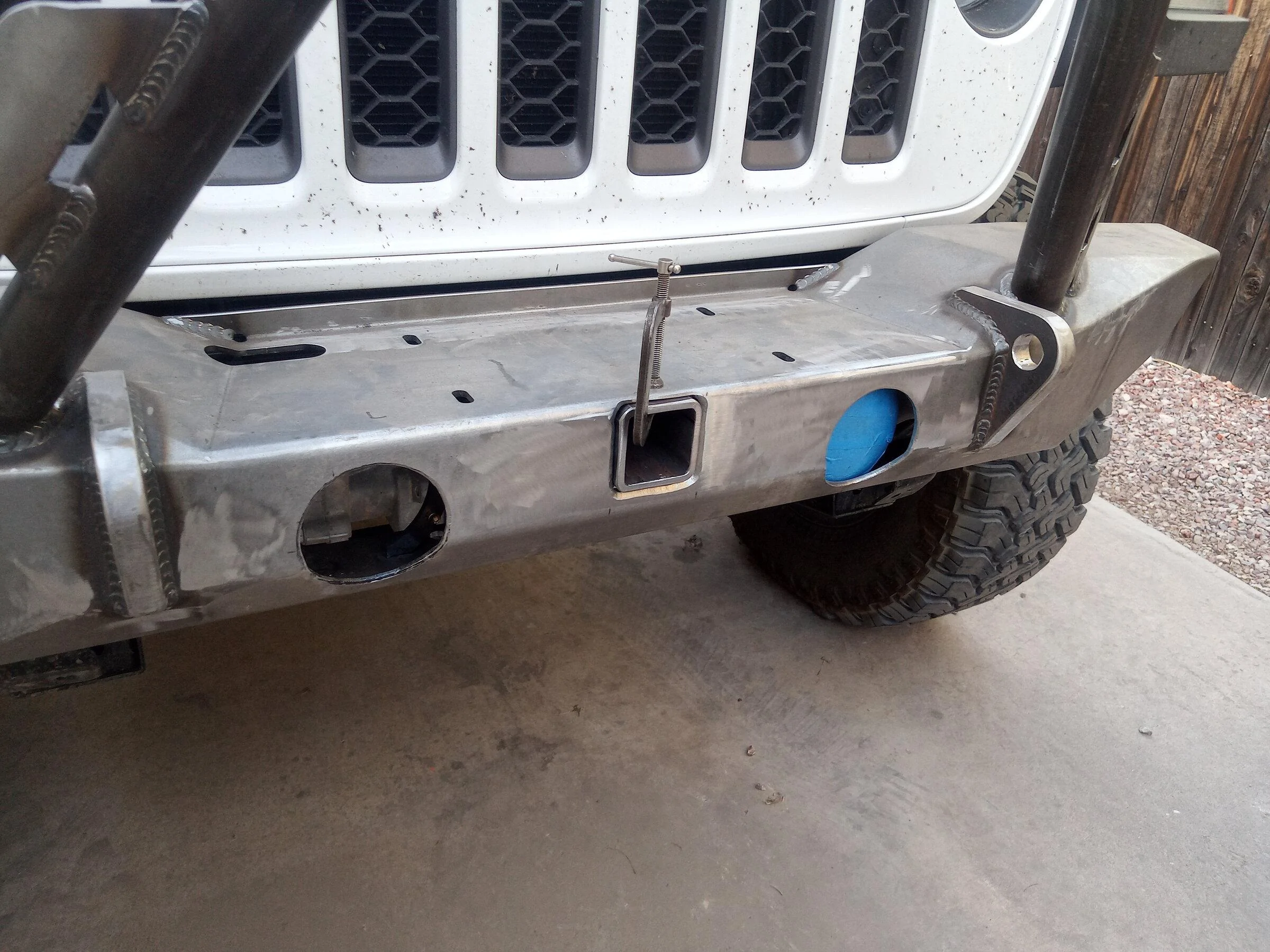

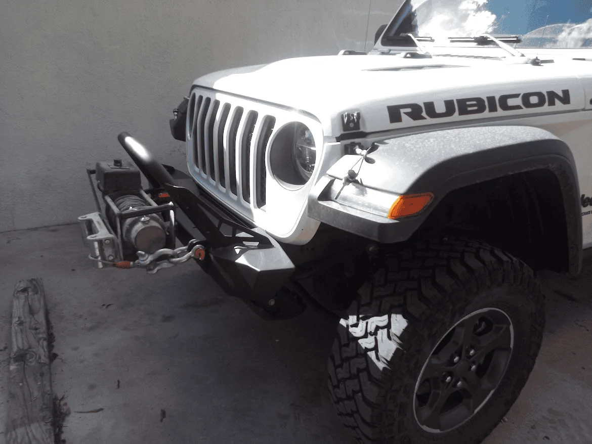

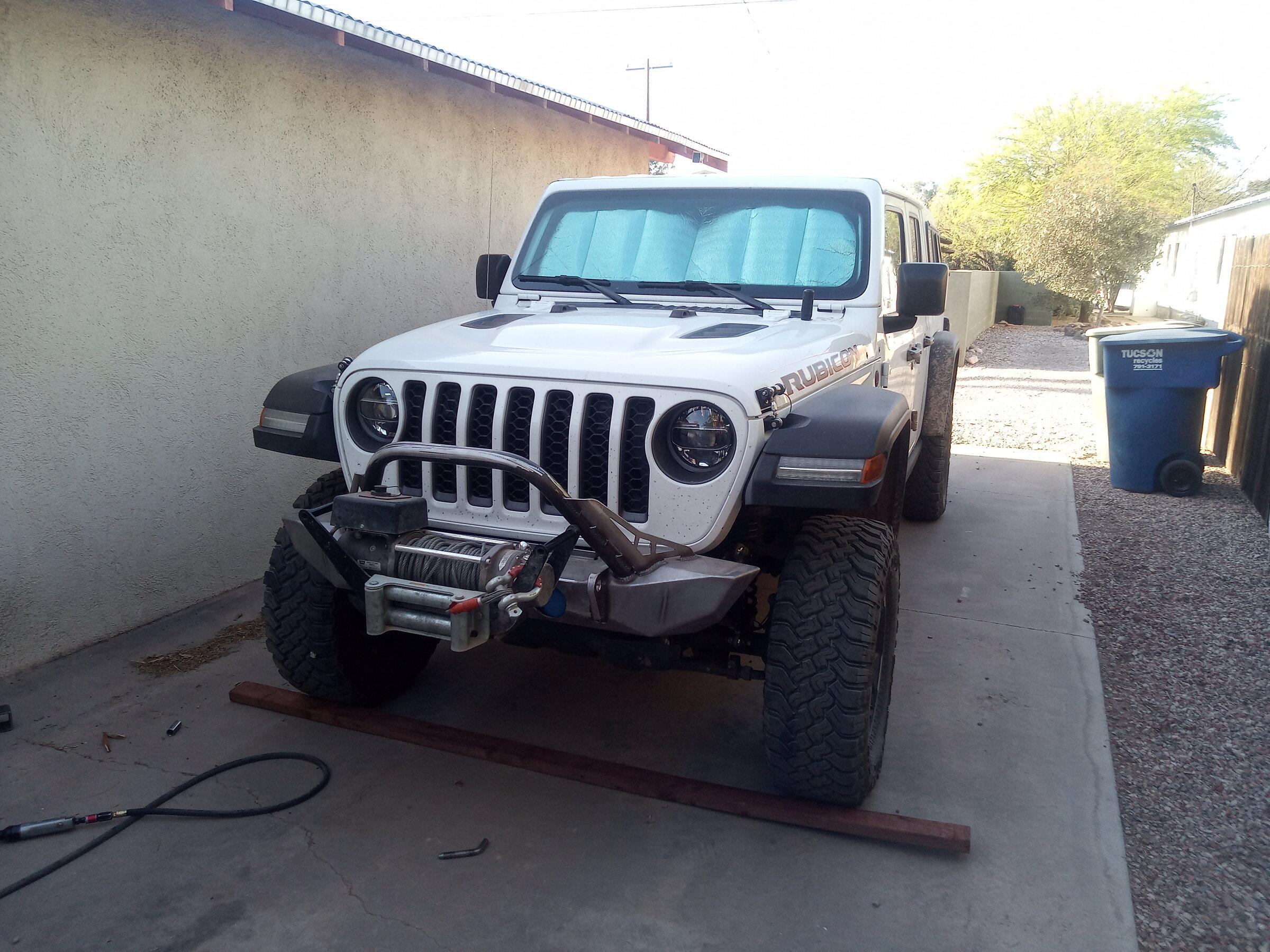

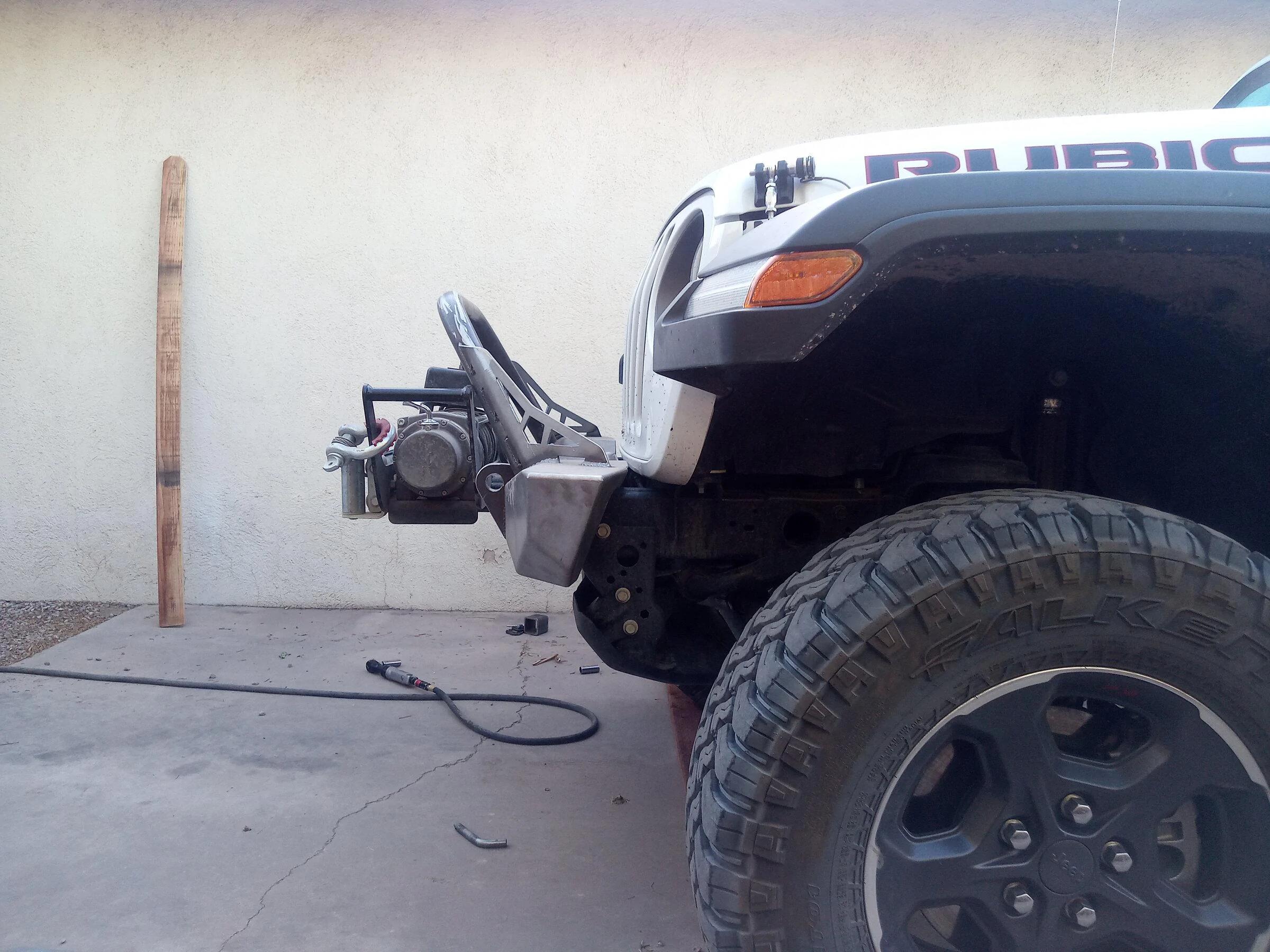

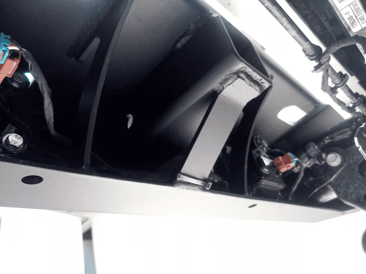

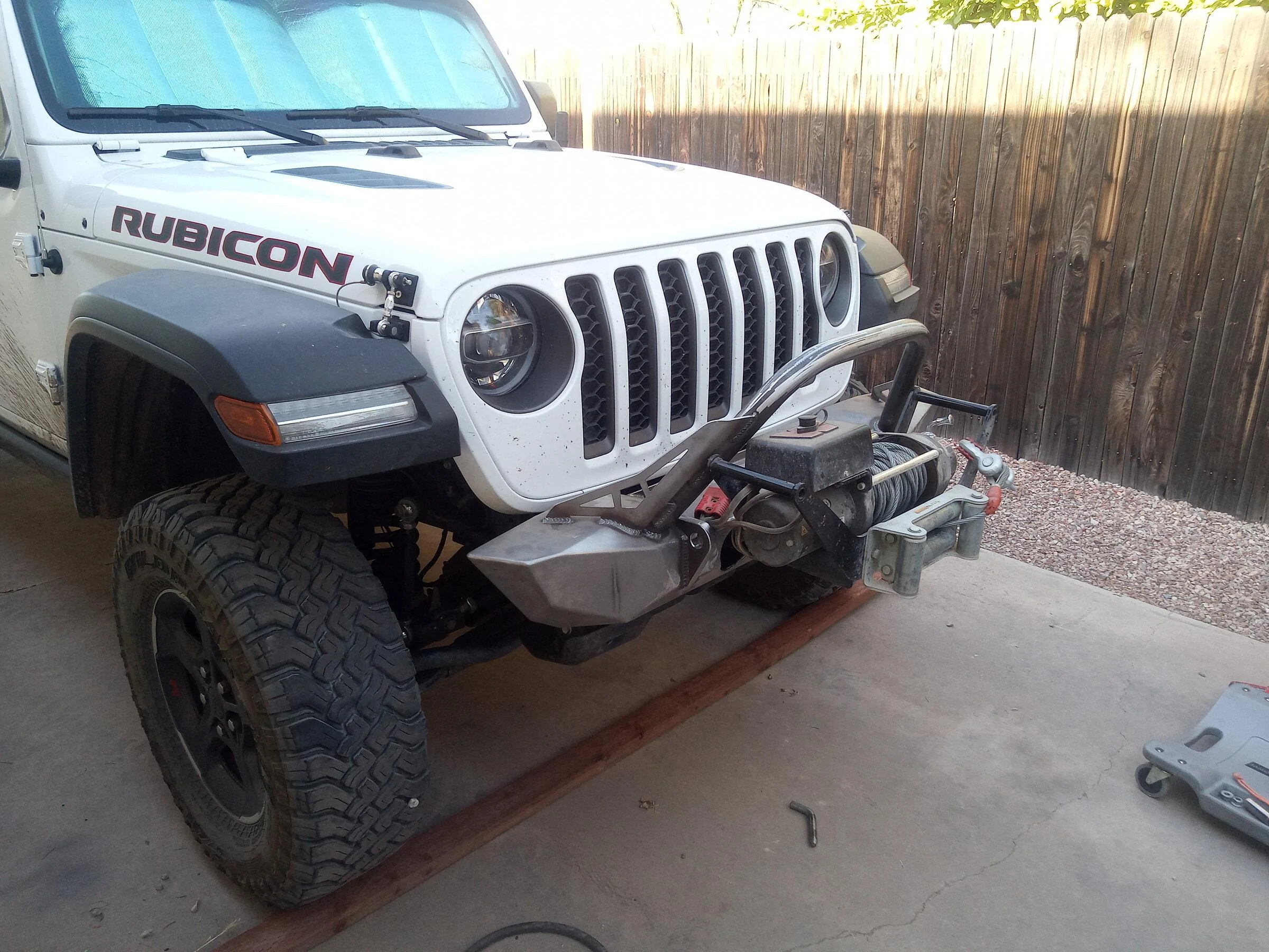

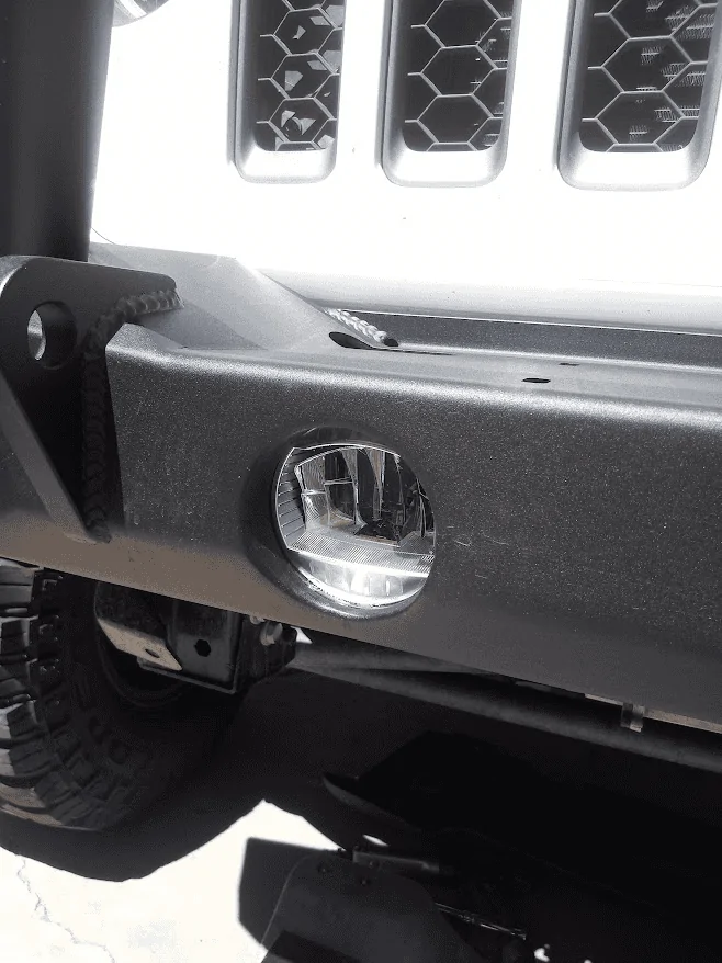

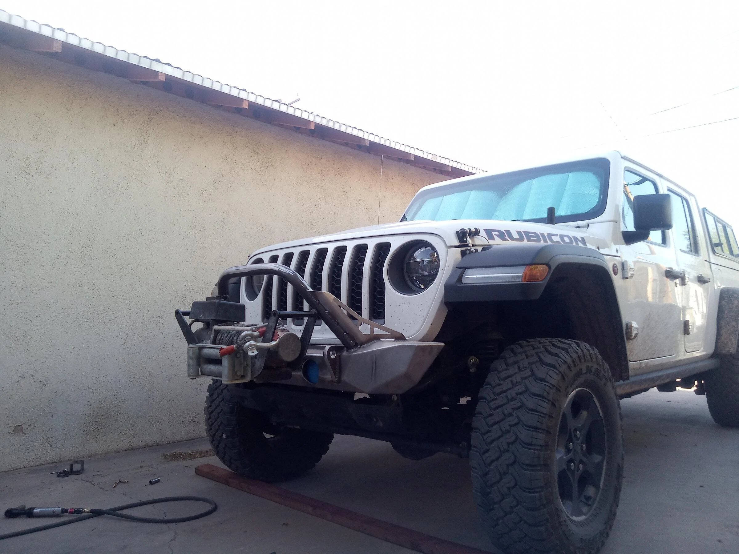

Here are a few photos of my efforts adapting a cavfab bumper to accept a 2" receiver tube for a removable winch. I can get my hand between the skid plate and the bumper and fit a hitch pin in place fairly easy while avoiding the fog lights. SO no complicated spring load pin system should be needed.
I may have to switch to synth rope and a aluminum fair lead to get rid of that bulky roller fair lead and make they system slightly less pronounced.

Nice, not having to haul 60 plus pounds around all the time is a plus. Another thing is could cut down on a deer vs front end and reduce damage. I do like the look of that bumper too maybe not the finish.

It's raw steel right now, will powder coat black once welding is done.

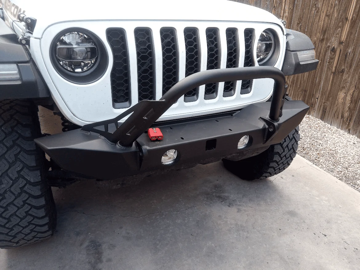

Follow up to close out the thread. @CavFab_MFG
Got it powder coated to match the rear bumper and rock rails.
