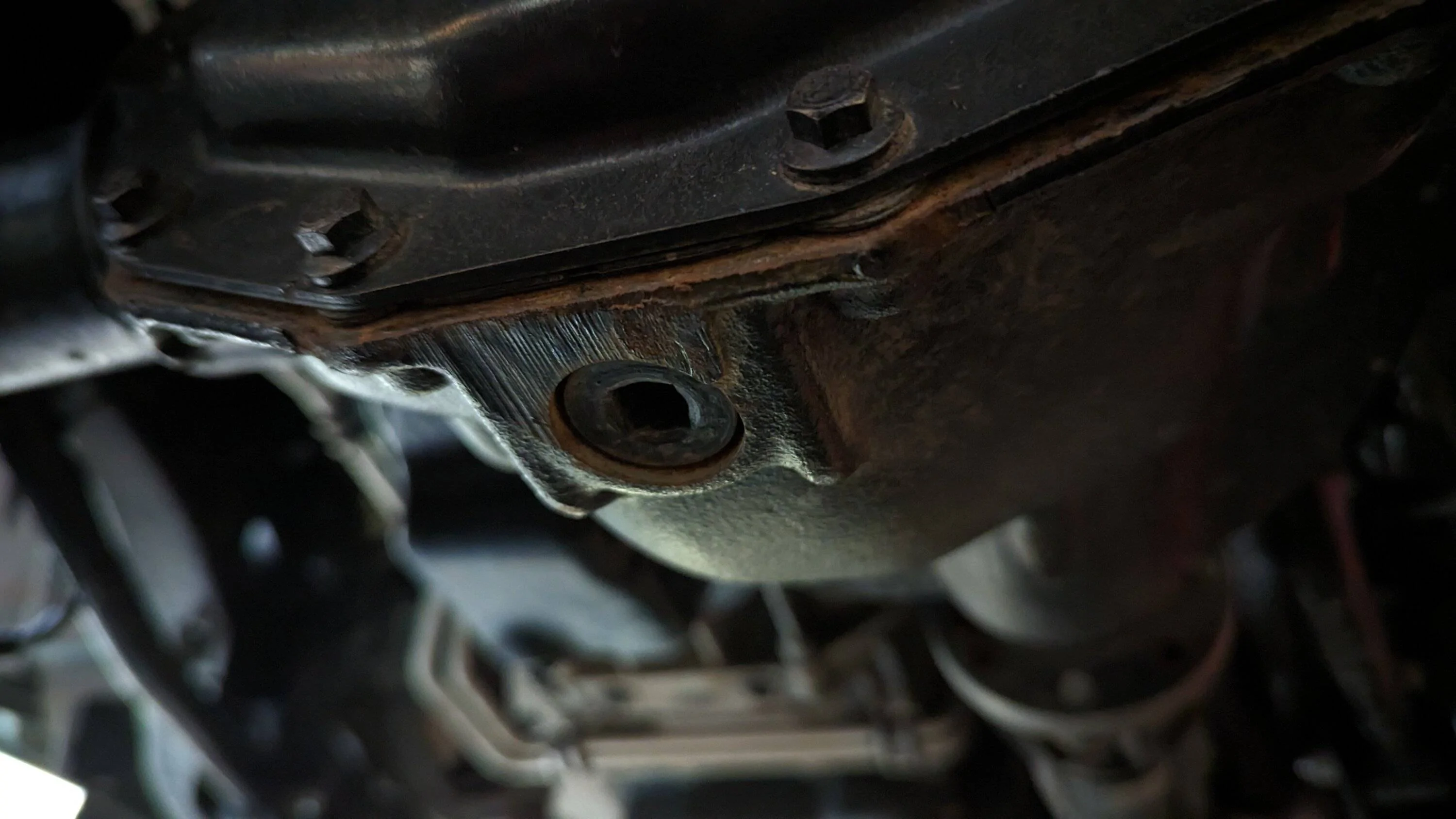

I just completed my second service on my front differential The first one I pulled the cover so I could inspect, this time I drained using the drain plug. I while I was applying liquid thread tape to the plug, I noticed it has a rubber o ring. Has anyone else noticed this? I checked the Mopar parts web site and they do not list an o ring in their available parts. I usually like having a backup for items like this but not sure where to find without physically matching it. Any ideas?

You might have to email Spicer and ask. I cannot even find the drain plug as a separate orderable part to see if a o-ring comes with it.

There's your O- ring.
And again here
OP is looking for the O-Ring size, not if the plug has an O-Ring. Unless I missed something, neither video states the O-Ring size.

I'm not sure of any exact cut-off (model, year, etc.) or anything that would signify which one you have without crawling under and looking though.
It was a late 2021 model cut in when they deleted the the both front and rear drain plug. It was across all Gladiator models.

Maybe I got the last one. October 21
Most of the disussion I have read on it mainly on the JL side is that there is going to be a few stragglers mixed in and it was not a clean cut in.
