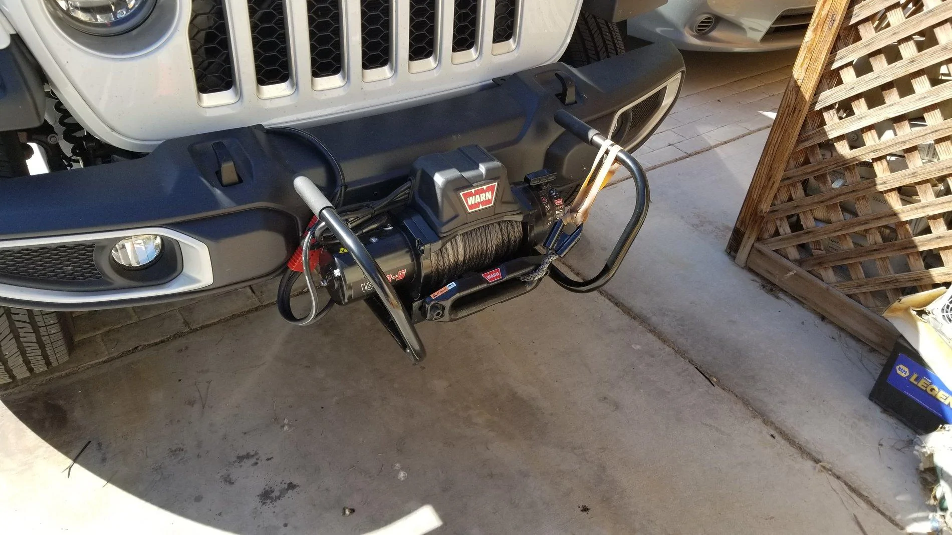

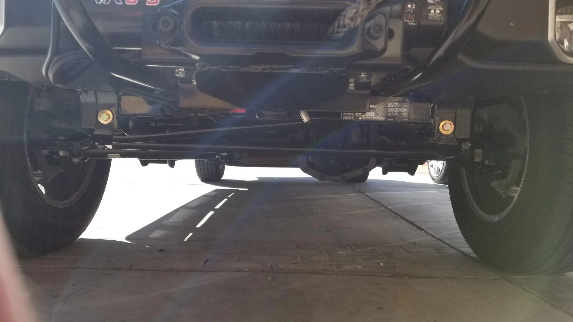

I installed one of these on my Overland to use for mounting a winch. It went on fairly easy. It has instructions for cutting a hole in the front air dam, and brackets, so that it can be reinstalled. I did not put the air dam back until I installed the lights, so it doesn't show in these photos.

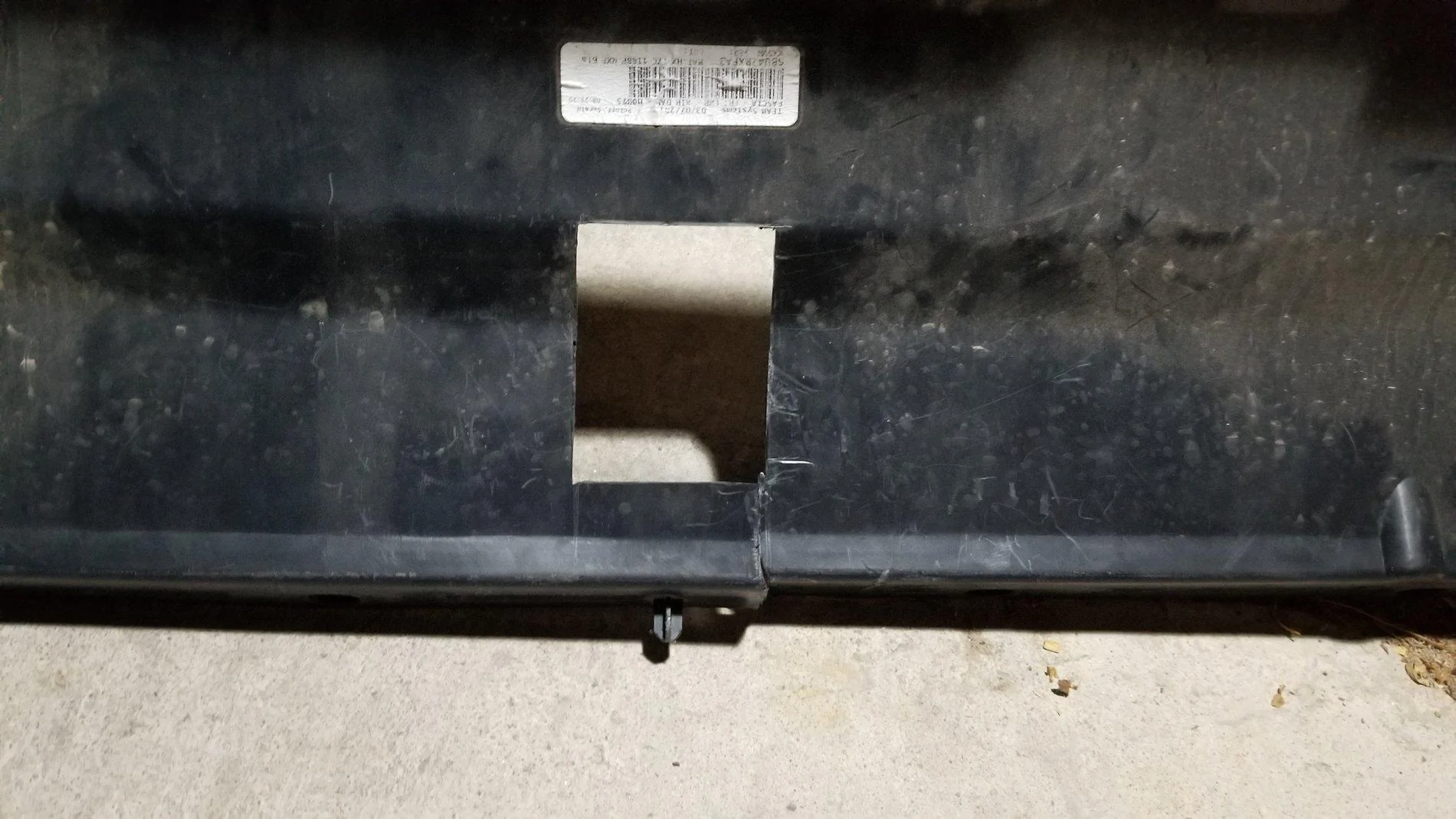

Found this, look identical,

The Curt Receiver is a bolt on option. It interferes with the front air dam, but it includes instructions to cut the air dam so it can be reinstalled. It does interfere with the front skid plate on the Rubicon. I don't know if it can be easily modified to fit back on over the receiver. The Curt instructions don't address that.
The receiver is a Curt 31086.
The winch carrier is a Curt 31009.

According to the manufacture it will fit , Etrailer also shows it as as match. It is the same figment as current JL. The plastic air damm is removed. Hitch bolts to existing hole and a hole is cut in the damm using the supplied template and reattached. 30 minute job.

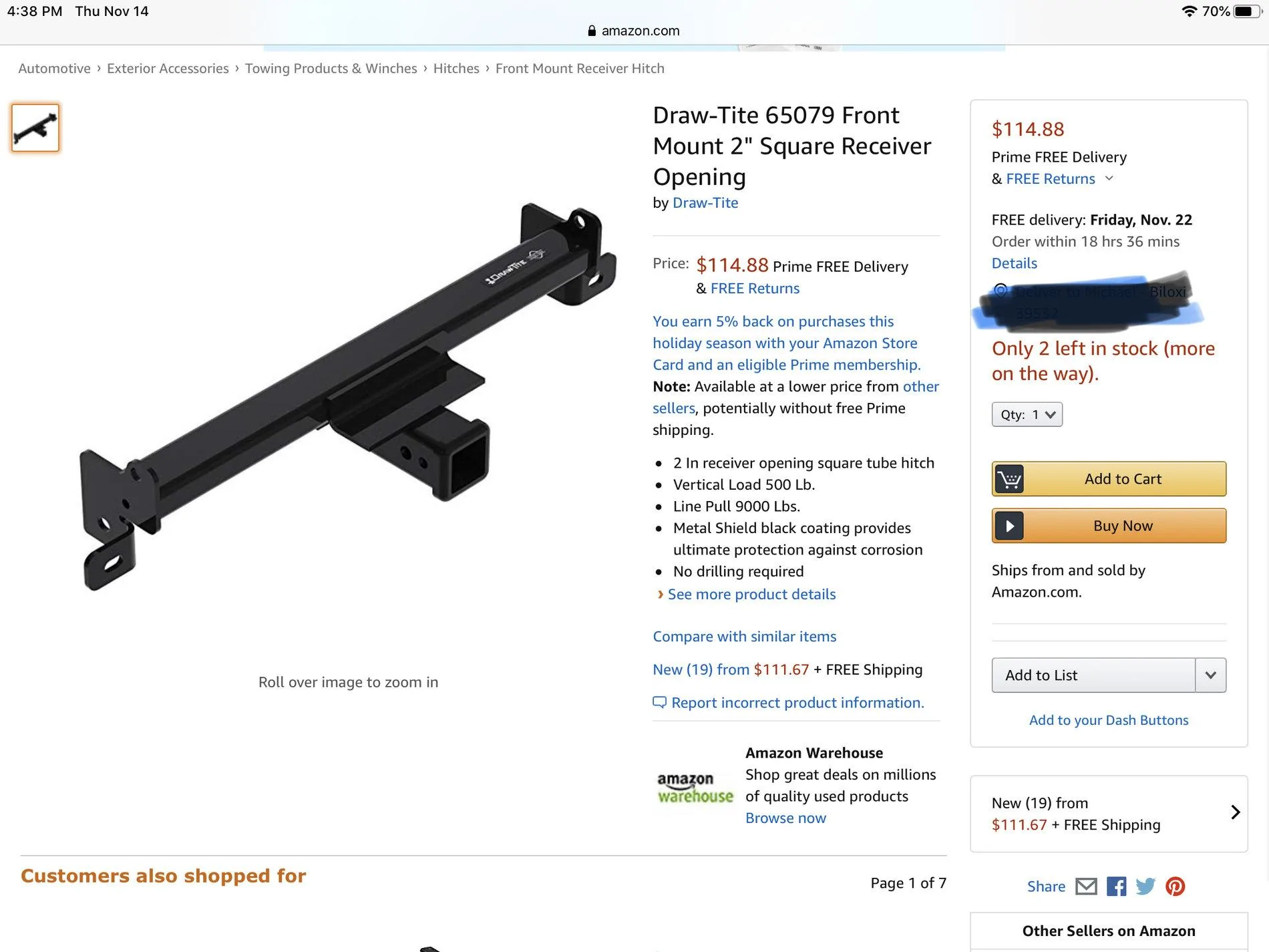

I ordered the Draw-Tite 65079 from Amazon. Should arrive by mid next week. I will be post my experience in mounting and suitability.

I also confirmed on the Draw-tite web site and Etrailer and they both say it fits. They appear the same but the Draw-Tite version is formed for the other bolt locations where the Curt is another tab welded on. I ordered one of the 65079 Draw-Tite via Amazon - said there was one left when I ordered.
Bet I know who got the other one because it did say there were two....... LOL

I used the 20 foot extension kit to install another battery at the back of the truck. The winch is powered by it, and AUX2 operates a relay that controls power to the winch. I use a Cole Hersee Smart Isolator (like used in the Genesis Dual Battery kit) to connect the batteries together.
