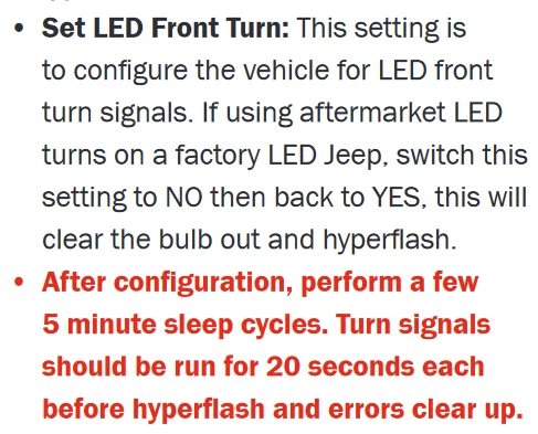

Background: I have an OEM halogen truck that has been converted to full OEM LED, including front turn signals / DRLs. Many Gladiator owners have reported that they have an unfixable hyperflash with this setup despite the dealership adding the appropriate sales codes. It has become a big issue in a few cases where the dealership promised an LED upgrade as a part of the vehicle sale and then encountered this issue without resolution. I am included in this group, as I have had the sales codes added but still experience the hyperflash and turn signal out errors. This problem IS addressed with a Tazer, however, and they do work fine with the Tazer fix installed, so that was my initial solution:
Jeep Gladiator Front OEM LED DRL / Turn Signal Hyperflash with JScan - how to fix? front drl tazer.PNG
I'd like to move these types of changes over to JScan to make them more permanent and get rid of the need to unmarry the Tazer prior to dealership service. The LED setting for the lights themselves is already set by the sales code that was added. I've tried to enable the same hyperflash solution with JScan (and with the Tazer unmarried but acting as my SGW bypass), by setting the Front Turn Lamp Diagnostics to Deactived (as it is when the Tazer is married), but the hyperflash errors are back after using each signal for a bit. I've tried a full reboot and 5 minute sleep cycles, but no change.

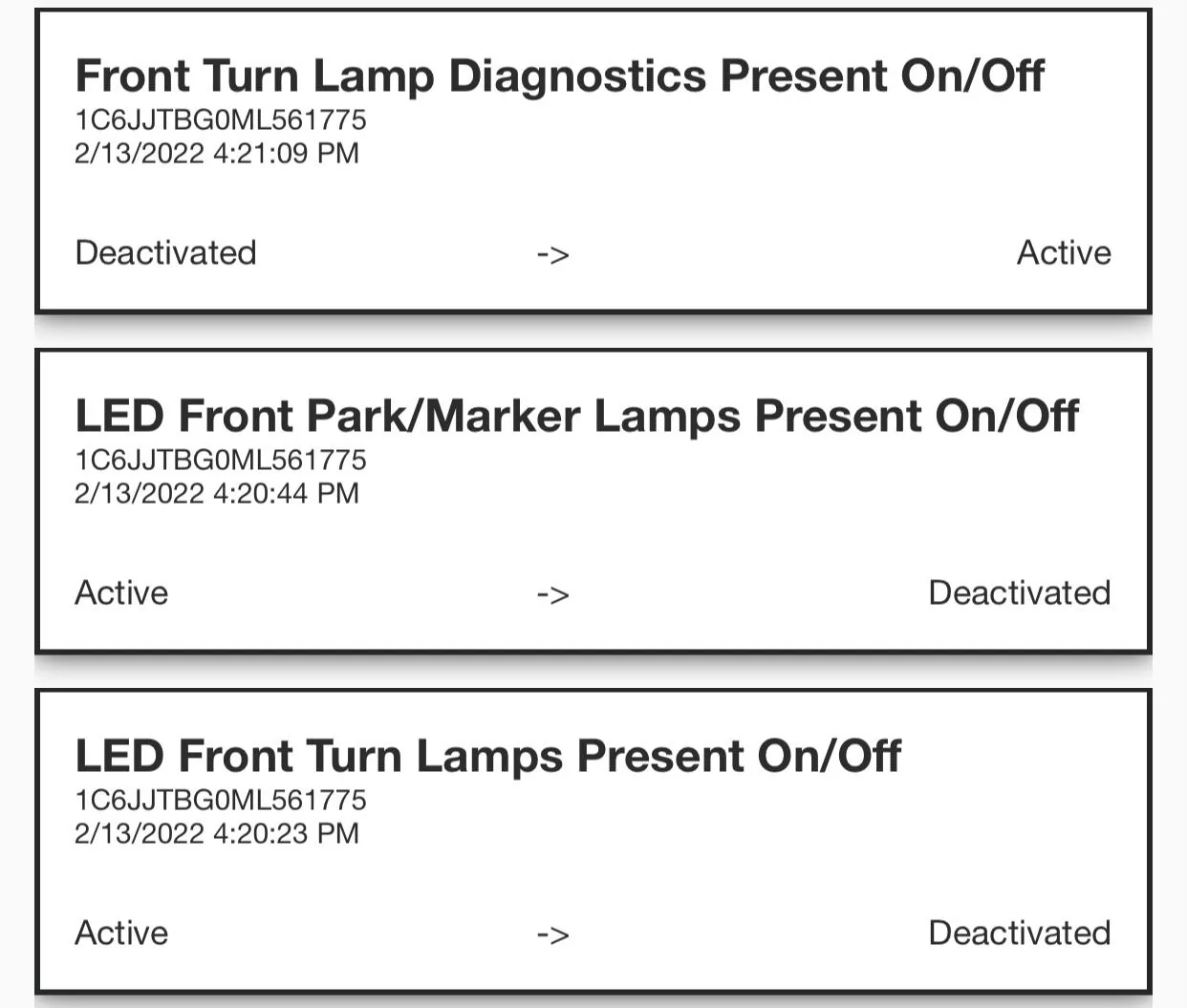

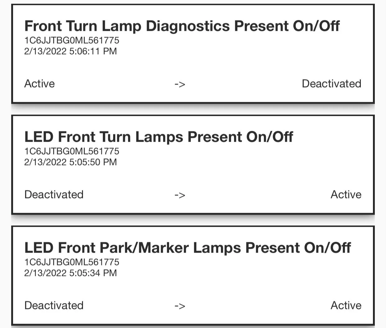

Welp, I used Super Bowl commercial breaks to see if I could make any headway on this.
First I tried setting everything back to how it would be for OEM Halogen, then did a Tazer reboot and two 5+ minute sleep cycles.
Jeep Gladiator Front OEM LED DRL / Turn Signal Hyperflash with JScan - how to fix? Photo Feb 13, 7 59 30 PM
Then I tried setting it back to LED with Diagnostics deactivated, and did a Tazer reboot and two 5+ minute sleep cycles.
Jeep Gladiator Front OEM LED DRL / Turn Signal Hyperflash with JScan - how to fix? Photo Feb 13, 7 59 32 PM
Unfortunately the errors still come back as soon as each blinker has been on for ~10 seconds. I'm stumped at how to solve this with JScan at this point. I guess I may need to simply continue using my Tazer for it. There has to be something more than meets the eye going on, because it's an issue for the dealerships as well, and only Tazer seems to offer the secret sauce needed to work around it. What I really don't get is why the JScan Diagnostics deactivate isn't working as advertised.

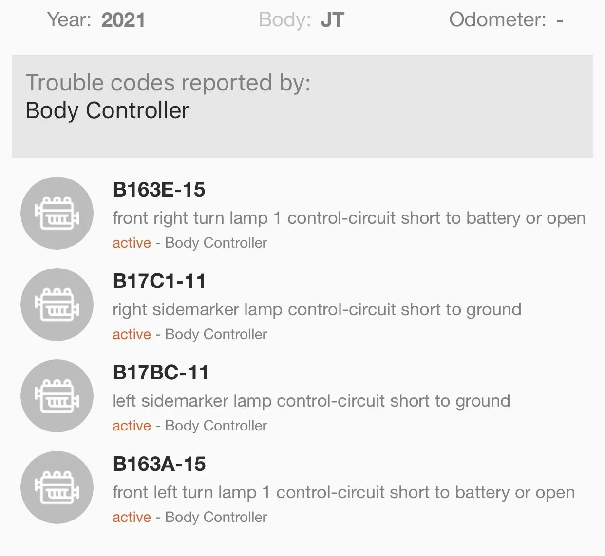

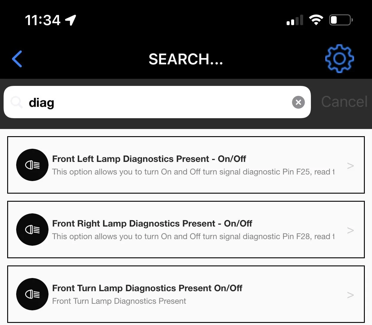

Got it via some help in their FB group. Apparently there are additional diagnostics settings that are not available via the main lighting menu group. You have to use the search function to find them. Disabling the two individual toggles for the left and right lights was the fix. I'm not sure why all three aren't shown in the main lighting menu, that certainly would have made this a lot easier, but I'm glad it's all fixed.

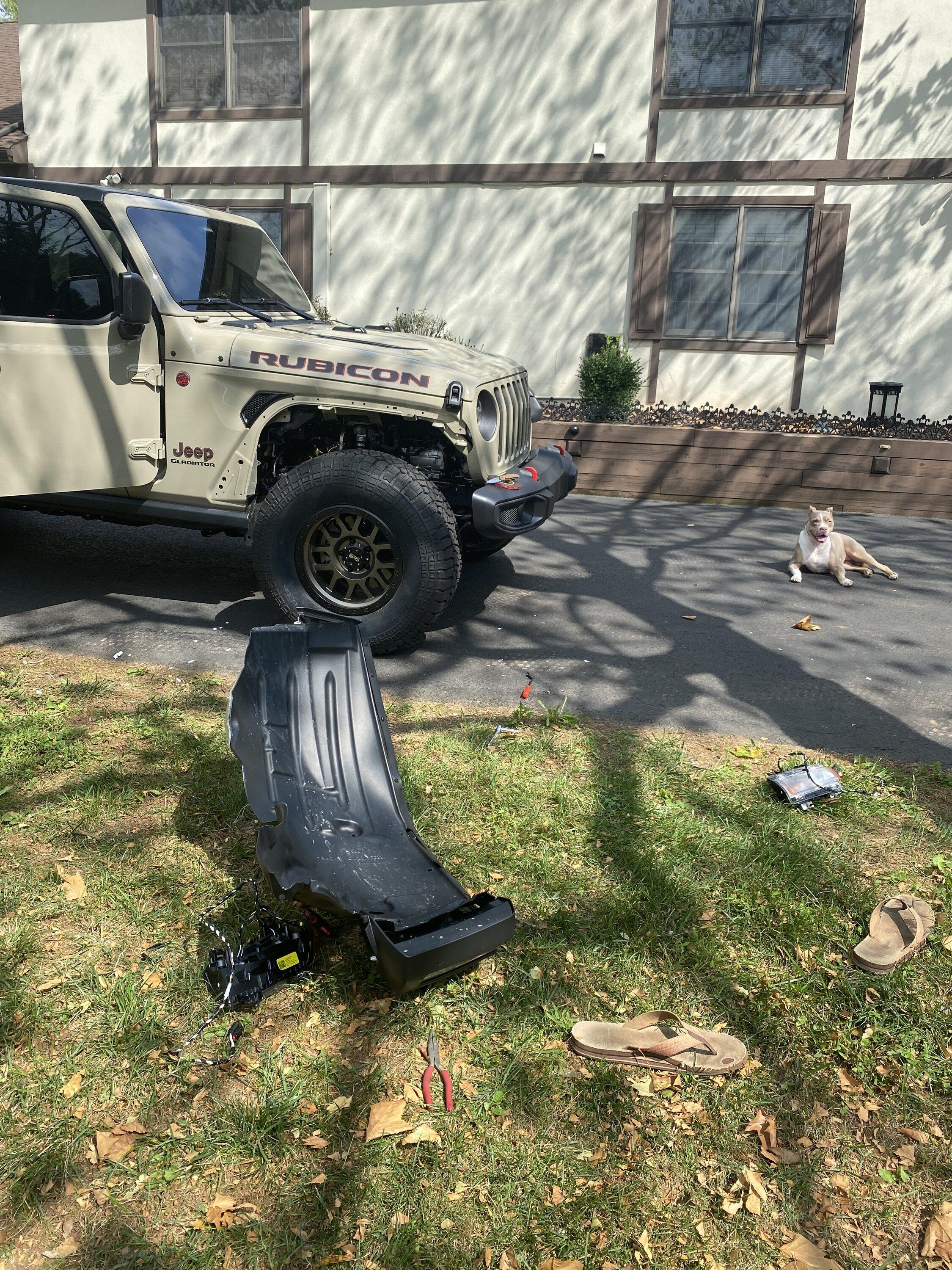

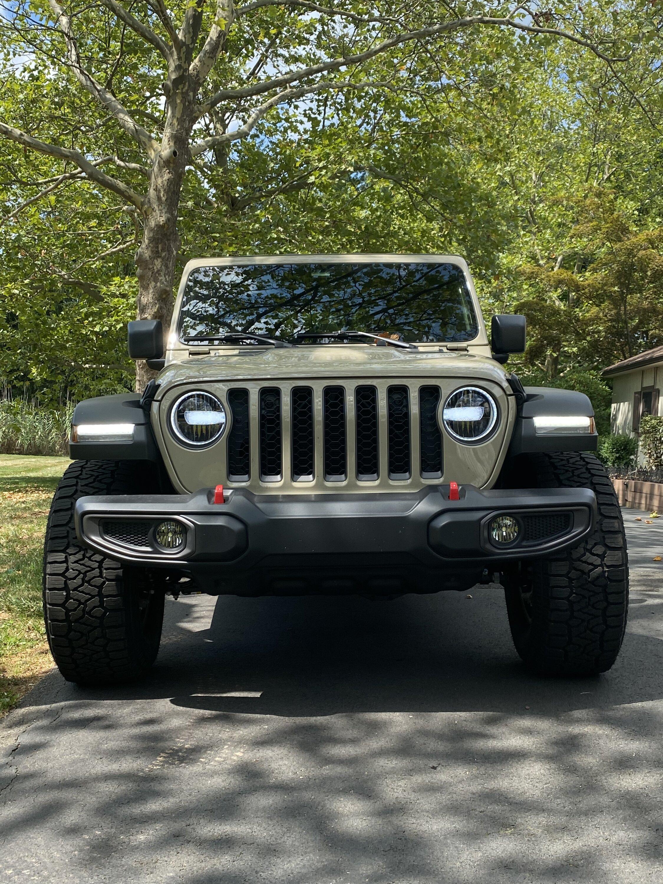

I just did the oem LEDs in my driveway. Pulled the whole fender. Scary but I bought new clips on Amazon beforehand. So I was ready to break some.
used JScan and no issues.
