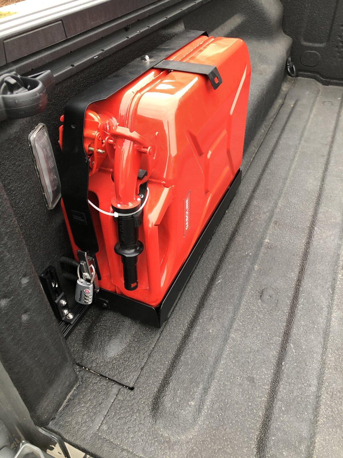

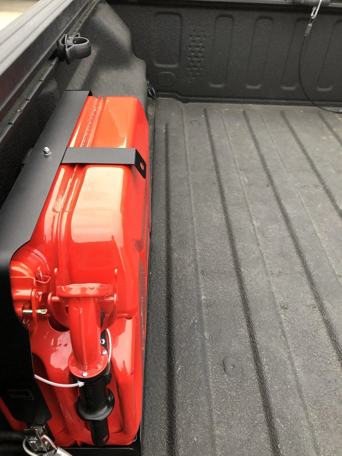

Just finished mounting, ready for testing.
No drilling into bed required.
Works with trail rails and tonneau covers.

Would you please show what is underneath and holding the bracket to the bed?

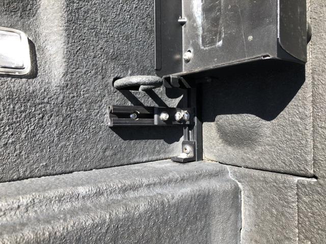

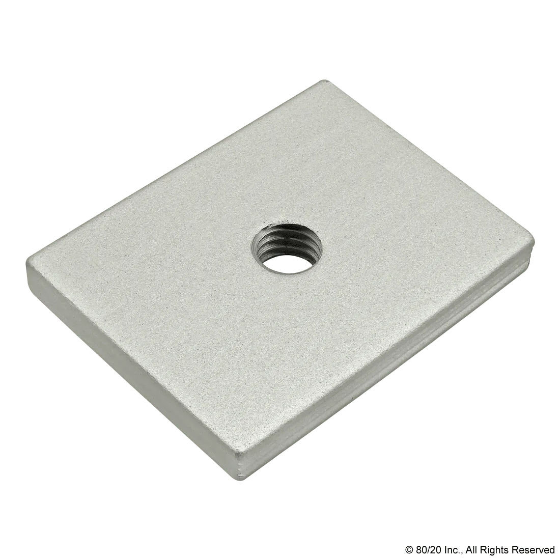

Hard to get a photo, tight spot. I used a M6X20 SS button head screw 80/20#17-6320 and M6 anodized backing plate 80/20#25-2492. I put a lock nut on to keep it from backing out. Fits perfectly against the tiedown round stock.

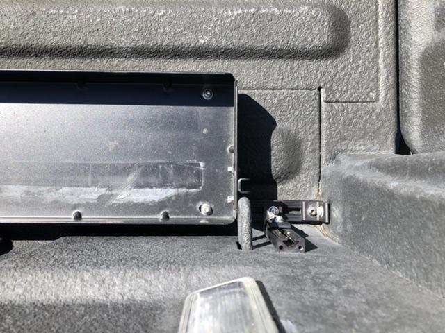

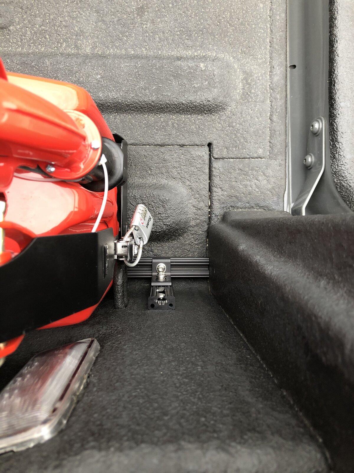

Setup is working great. Tried to get away with a no drill application, but tank kept turning in from bed wall. May have worked if I used a wider extrusion on the vertical. I put a SS rivnut behind the tail light and tied it into the bottom extrusion with a 90 deg bracket. Need to replace steel bolt and t-nut with SS at some point. May also add rubber insert to keep debris out of track. Adding pics in a few.

22 inches of the 1050 profile, longest I could go before you start into the wheel well. Used item #13035 SS M8 T-but. 4 inches on the vertical. If you use the Frontrunner, may need to grind an 1/8th of an inch on the corner next to the wheel well.
