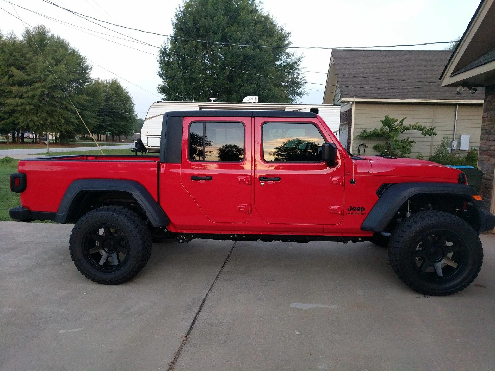

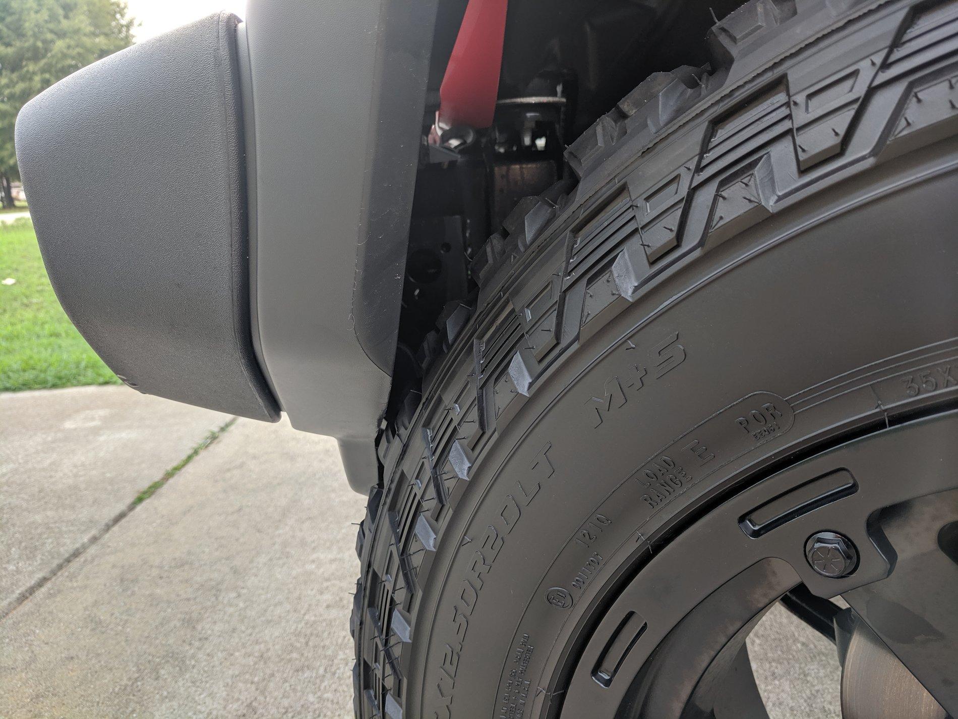

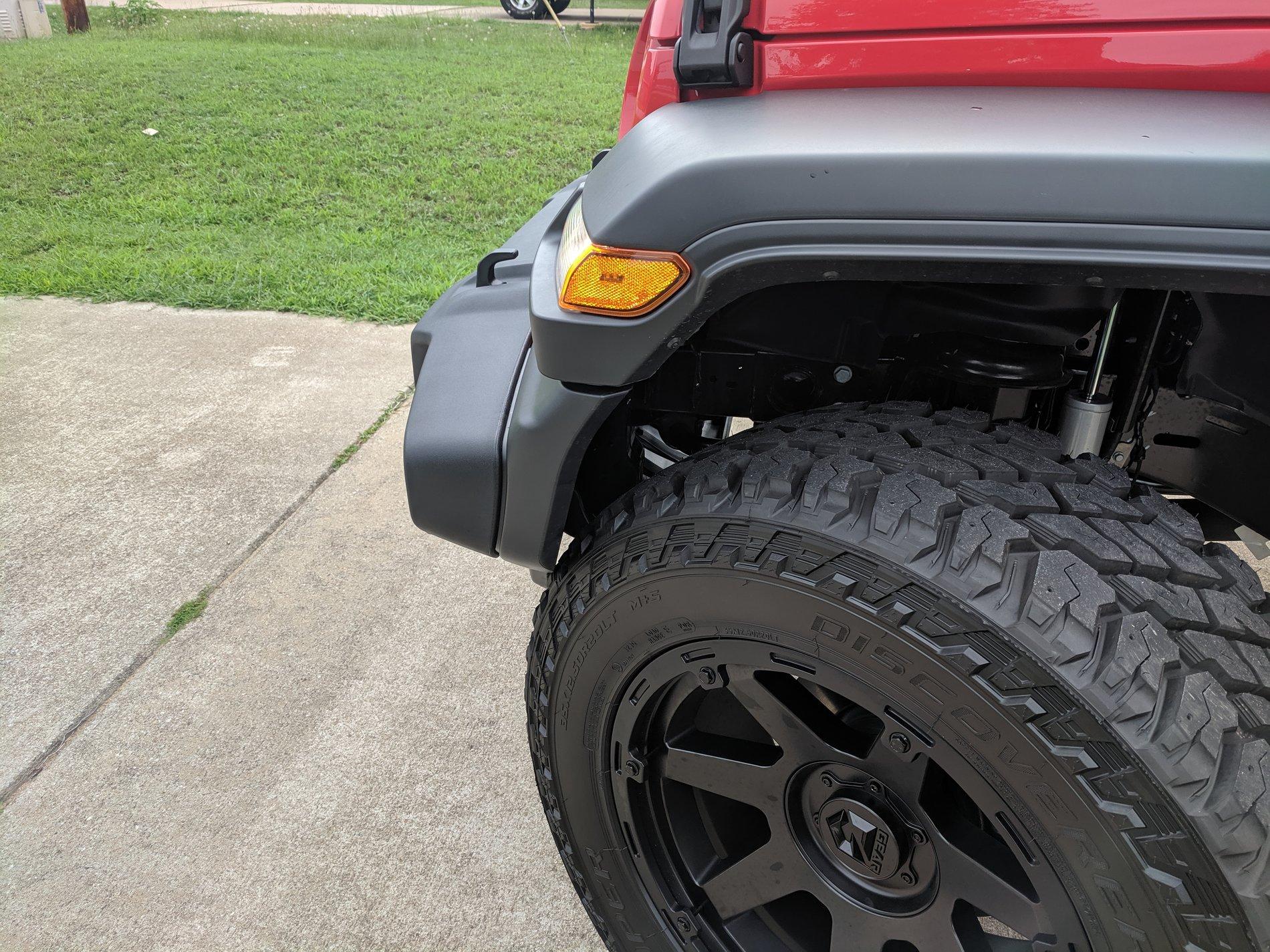

Rough country 3.5 in lift...
Gear off road 20 in. Wheels.
Cooper MT 35x12.5 tires
JP1
Mar 29, 2019
1,507
2,879
Fort Lauderdale, FL
2024 JLU Rubicon 4xe
MUCH better!
now we can help.
A dealer did that?
ohHELLno.
they drove the "we don't know what we're doin BUT DOIN IT ANYWAYS" bus.
DO NOT TRIM A DAMN THING! TAKE IT BACK AND MAKE THEM MAKE IT RIGHT!!!

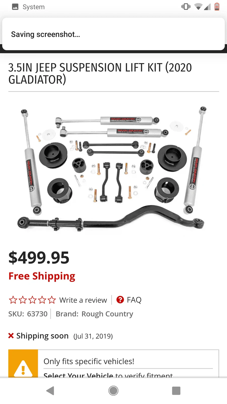

Is there some spacers installed behind those wheels?
35's should fit with a 2" lift, what is the backspacing on the wheels?
Honestly that doesn't look like a 3.5" lift
It is hard to tell in the pics but it is a 3.5 inch I had one on my last TJ. This is the lift thanks for the response.
