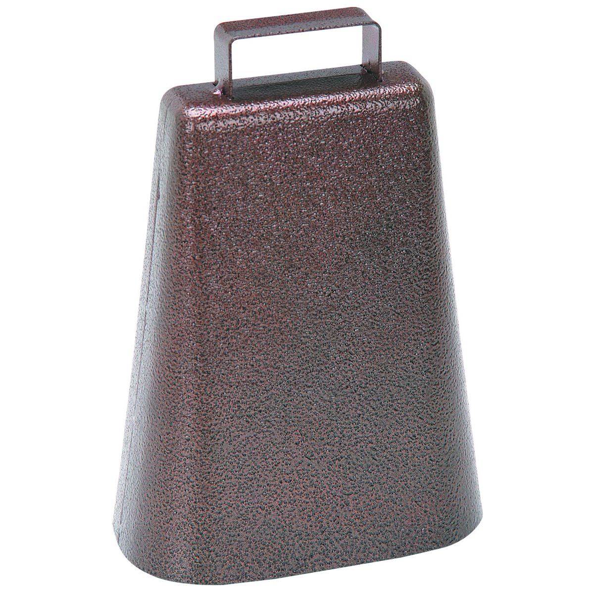

Well, I'll be go to hell. Happened to me twice. With my faith in the human race I thought someone was screwing with me. A buddy put a for sale sign on my Gladiator, so I zip tied a (Harbor Freight) cowbell under his truck. I thought he was screwing with me again. I gave him too much credit, he probably won't retaliate, the cowbell is going to be hard to top. Thanks for clearing this up. Going to keep a eye on the door now.
$5.99 and a couple zip ties.
