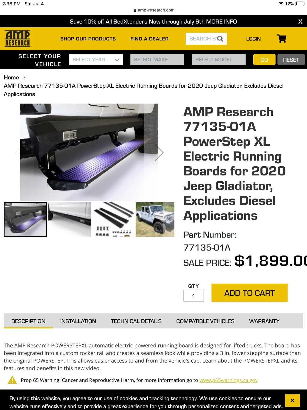

I am curious about the layout of the diesel components as it appears there might be some things located outside of the frame rails. I went back to look at parts for my pending order and found AMP Reswarch exclude diesel for their steps meaning there is some sort of difference between the pinch welds and the frame rails. I suspect fuel system components. AMP appears to supply the steps for the Ram pickups so I’m guessing they are getting some pre-release info.
