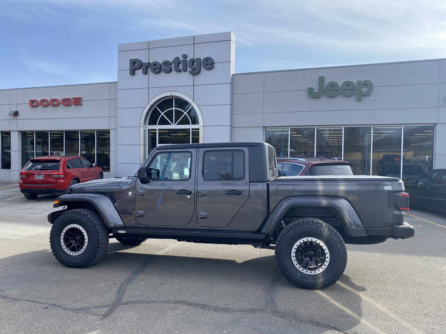

I'm running the Mopar 2" lift on 37's on a Sport S with 17" Mopar wheels. I haven't flexed it out to see if the front fenders will rub but just by looks I feel like it will rub at full flex. For me I'm not too concerned as I don't plan on doing any hardcore rock crawling, or else I would have gone with the Rubi. I'm more of a mud slinger so the flex isn't a must.
As for gearing, my opinion now at just under 3,000 miles (2,500 on the lift and 37's) is I see zero reason to regear, especially if you're not going to tow. On the stock 31.5" tires I felt that 8th gear wasn't quite big enough, now on 37's at 75 mph it revs right around 1,600 rpm which is in the torque powerband and it holds 8th gear just fine on top of revving lower which could be good for fuel economy (if that matters).
This summer I will be towing my ~3,500 lb camper for the first time on this setup, this will be the deciding factor on whether I regear or not. I'm torn because the only regear I can get through the dealer is 4.88 to maintain warranty, this is what I had in my JKU (albeit with the 5 speed auto) and I felt it was too much gear for what I needed on 35's.
no rub with sport fenders if you keep the sway bar connected.. i also have a 3/4" spacer in the front.

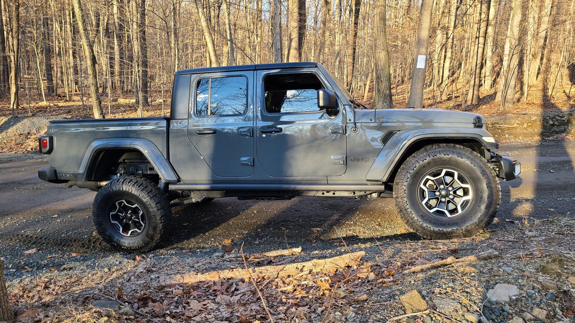

This might apply to the Rubicon that has the higher front fenders but that's about it. My Sport S ED is on a Mopar 2" lift and with 37's I don't see any way they would fit without the lift. I have no spacers and a decent amount of rake (haven't measured yet).
He said he was going to get a Rubicon, a spacer is a spacer lift and 2 inches of spacer lift on a Rubicon should be able to run 37's no problem.
Let me clarify, there is no need to do a full 2 or 3.5 inch full suspension lift for what the guy is using the Jeep for, 2 inches of spacer lift should be fine. hundreds vs thousands and he has a height limitation and in addition he will probably have to spend another 2k on drop down steps also like you had to do. spacer lift will get you up there enough to run 37's and no need for the step stool or small ladder to get in.

yea yes and yes and the answer to your question about rake and Mopar 2” is in the pic above 2-3 posts. He has rake, see his ass sits slightly higher in the back? The manufacturer’s Lift will be like the truck comes stock but higher and the truck comes with rake.
I was trying to save u all the questions and confusion by giving u info from a guy that has built many jeeps with an open checkbook and made changes playing around. I have a lift in my private warehouse so I can play around at little to no cost.
I am trying to help you get what u want at as little cost as possible while others might just want to show off and brag about what they have because everyone thinks what they did is the best.
Do a spacer lift and enjoy your day and you can add 1/2 inch spacers to get rake where u want.

Coil or wheel spacer? From?
3/4 inch coil spacer from daystar to take about 50% of my rake out.
(I am running 1.75" wheel spacers/adapters from teraflex as well but that has nothing to do with the lift)
