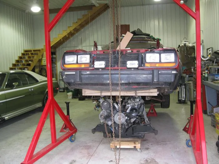

With your skills maybe you could built a gantry crane and use a chain hoist - then have it to do almost anything?
Just an idea - and I say that because in my profession a hoist lifts the car - and I'm going to get a 2 post hoist for my shop so I can walk under my cars instead of crawl under them.
But for lifting stuff - this gantry crane is home-built, powder coated and I used a chain hoist to lift cars to swap engines, etc. from below.
I used it to lift the big table saw out of the back of my truck, to load engines and unload engines from my truck and more (table saw has a cast iron top)
In this picture it's lifting the car so I could roll the drivetrain already assembled under the car, then I let the car down on stands and userd the gantry crane to pull the engine up so I could get the crossmember bolts in place.
Anyway, just an idea and I can sure get other pics or whatever.

My gantry crane is on wheels - casters that can be locked. Put an electric hoist on it, or a chain hoist like I did. You can lift your top, cargo, whatever. Roll it around, into or out of a garage, up and down the driveway, it will straddle the truck or a trailer, have a heavy load in the truck, wheel it over the truck and lift the load, drive the truck away...........
You can build or buy one that can be raised or lowered, used outside, or inside a garage. Your garage doesn't even have to be strong as this handles the weight. I used mine to lift a car I parted out onto my trailer to haul to the scrappers.
After having to deal with an overhead harken hoister, which i still have, i'm planning on building a gantry like you've done. Its just easier to line up and with those garage ceiling based ones you chew up garage ceiling space and you have to get it all lined up with your garage door, etc. the portable gantry is nice because you can use it in or out of your garage, and to help lift other things out of your bed as well.
