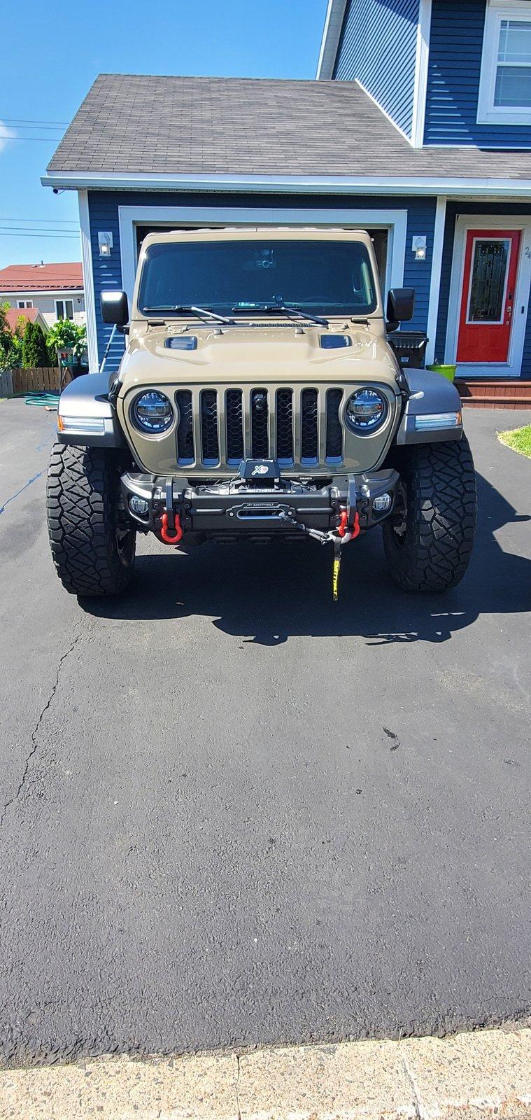

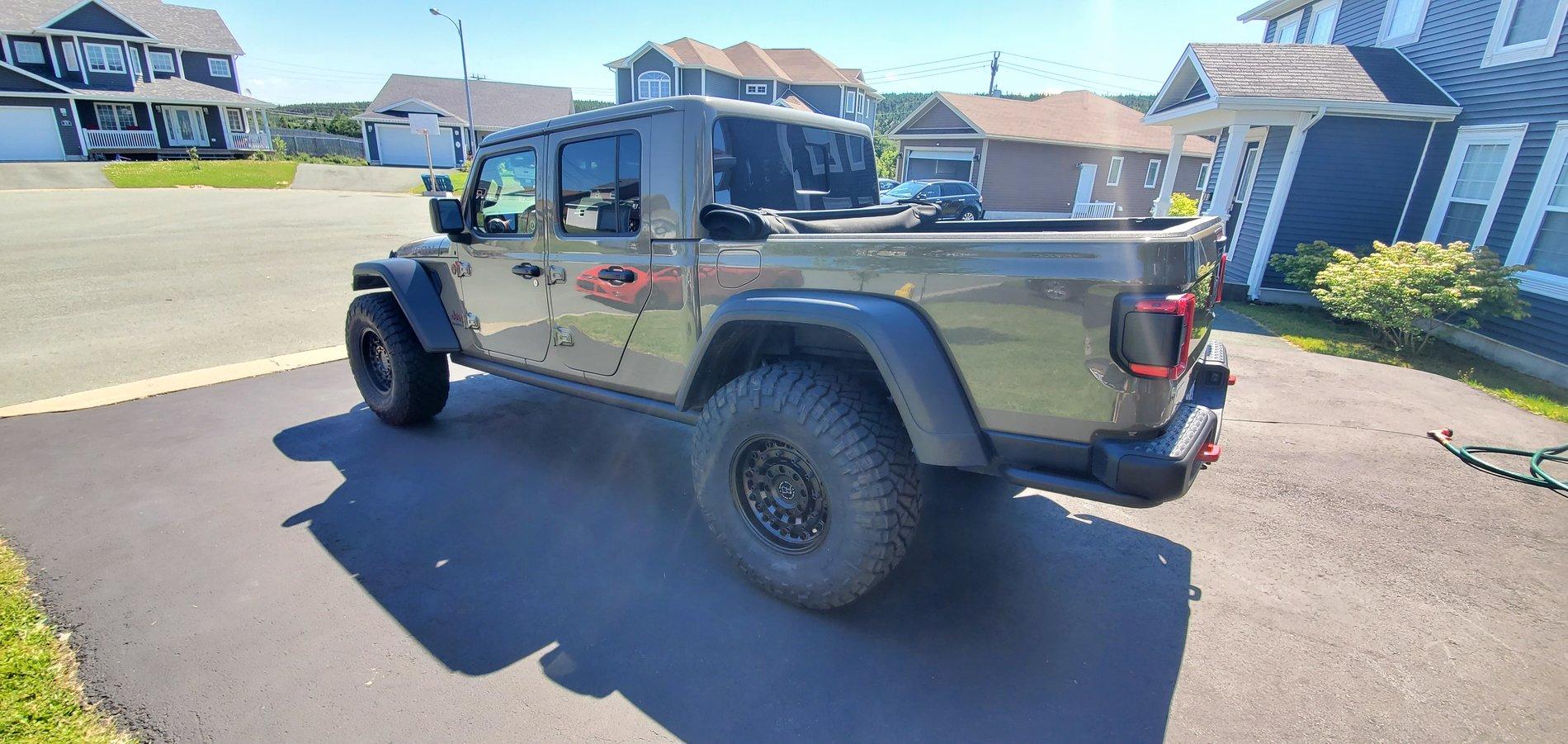

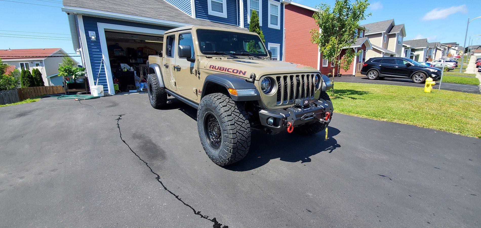

No lift yet waiting on 3. 5 inch to come in but decided to stuff my 37s and must say they fit fine. I wouldn't dare go Offroading but they do work.
Aftermarket Parts:
Black Rhino Arsenal
37x12.5x17 Nitto Ridge Grappler.
Rugged Ridge Arcus Bumper.
Smitybuilt winch

Outside of the factory bumper that is easily my favourite. I almost wish I never got the factory steel and spent my money on that one instead. Looks great!

Wow, that looks really great. How is the performance with the 37"? And does the heavier tires add any pounding to the ride? Enjoy your ride!

Noticed the shifting is a little off but I am waiting for a cable to come in so I can reprogram the tire size. But all said it's not a massive difference it's a jeep at the end of the day not a speed machine :) once I get the lift in I'll give her a test off road.

I am thinking about doing the same since my wheels are in but the lift is not going to arrive until after the holidays. Can you help me out here what is the size and offset of the wheels you are running? is there any rub at all during daily driving? and do you believe I could use 37 /13.50 Nitto Ridge Grapplers or should I stick to 12.50?

12.50s are much lighter.

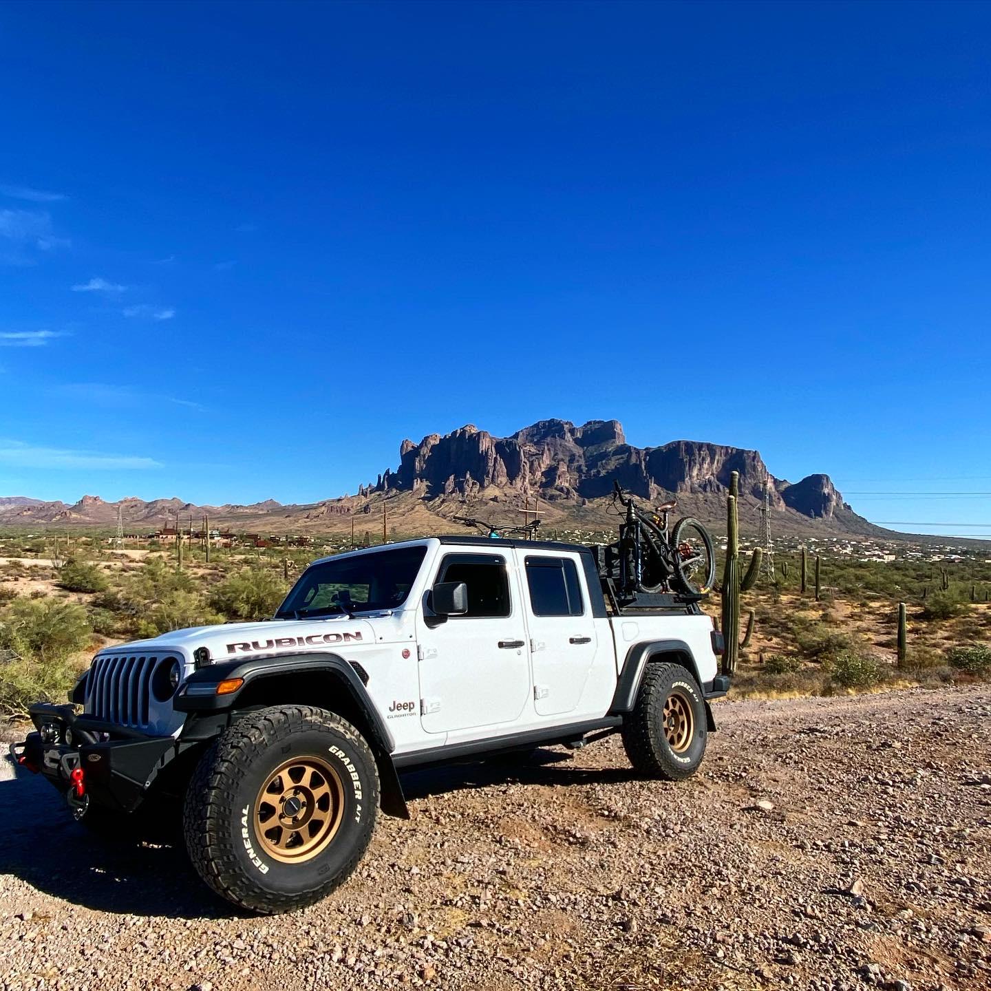

I'm the same going on about 17k miles now.
Crosscountry trips to off-roading (although more moderate than wild) at Bulldog Canyon, Broken Arrow Trail, locally here in WV, not issues. Maybe a few rubs; even with fully disconnected sway bars an truck loaded with 1/2 rack and RTT.
Broken Arrow trail (20psi).
Method 17x8.5 MR701s w/General Grabber XTx 37x12.5

Do you have the matching spare? and does it fit underneath?

What offset? -18 or -12?

I do not. I carry a handful of plugs and air pump. It was in the plans; but hasn't happened yet.

Though not ideal for trails the look of the Glads on 37s with no lift has grown on me. Your rig looks so clean and well put together. I do agree that so far that the Arcus Bumper fits best on our rigs. Well done.
Btw, hope i didnt miss it, what lift are you going with?

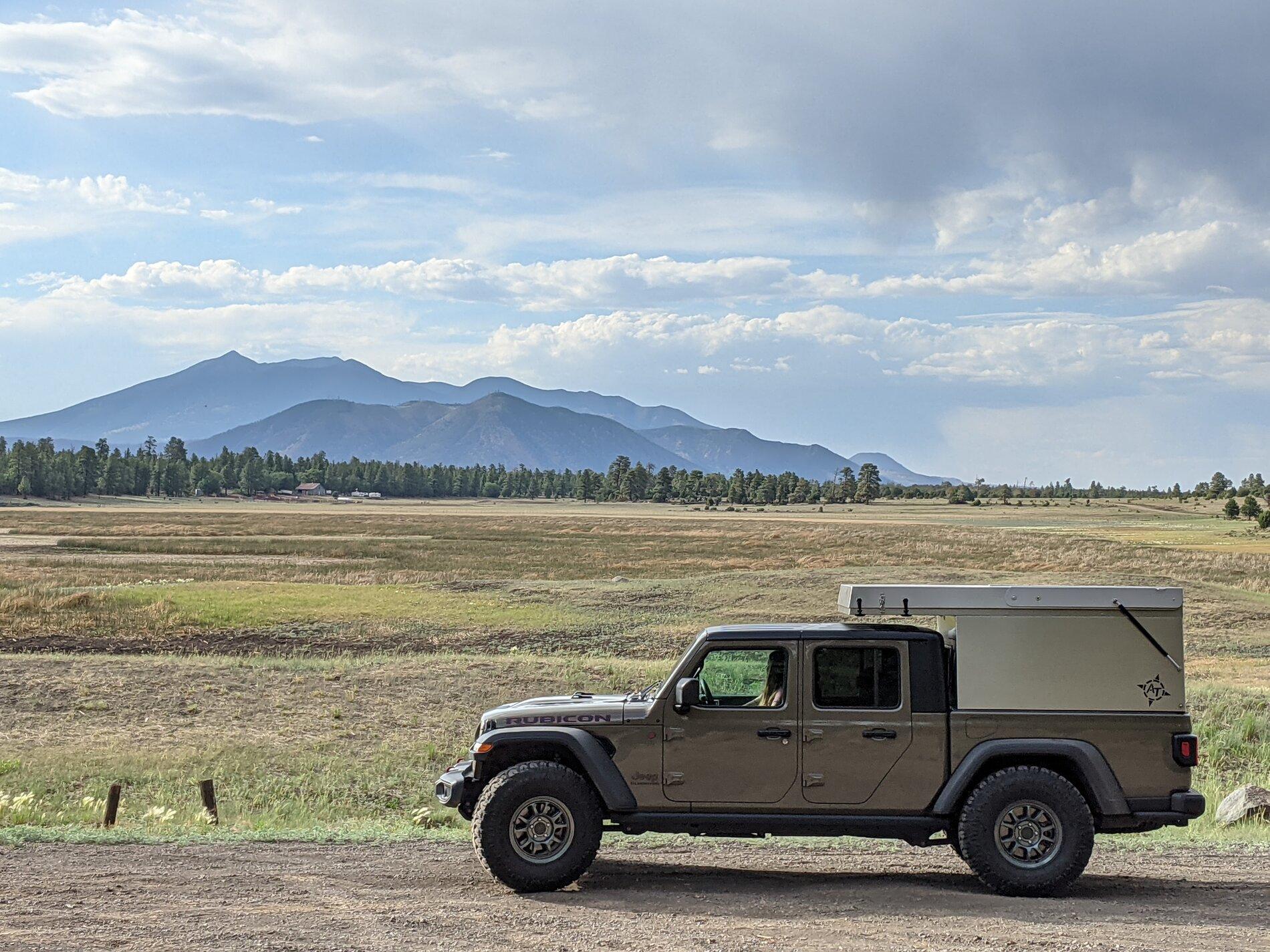

I'm also on 37s with no lift. Milestar Patagonia MTs 37x12.5/17, with Method 313 wheels, 17x8.5" with +25mm offset. I haven't noticed any rubbing yet, even loaded down for camping this last weekend, doing some mild forest roads.
